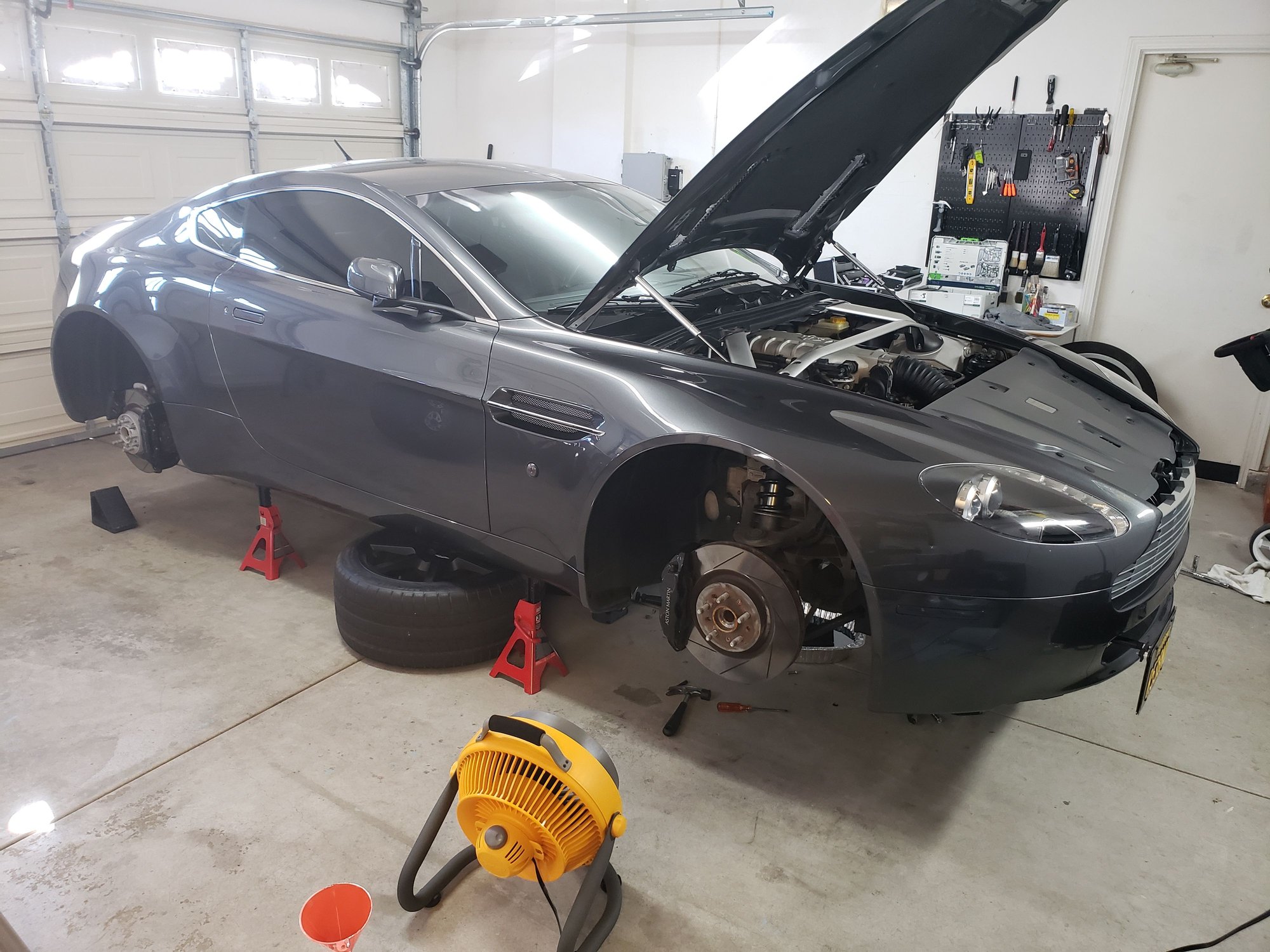

I just did my first annual service for the first time ever and couldn't wait to go for a drive after I even cleaned the wheel wells.
The problem is my front lug nut got broken thread and I went to Autozone to find same ones but they said they don't have any Aston stuff in their system so I had to turn around.
According to my research, they are M14x2.0, 22mm for my vantage. Also looked for it from the internet and I couldn't find the right one yet and not sure if I get any M14x2.0 22mm, would it fit?

Here is the picture of what it looks like at the moment.
