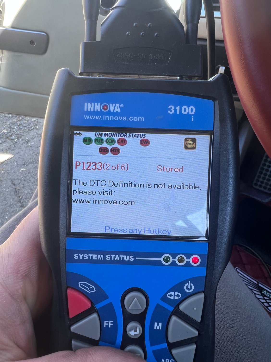

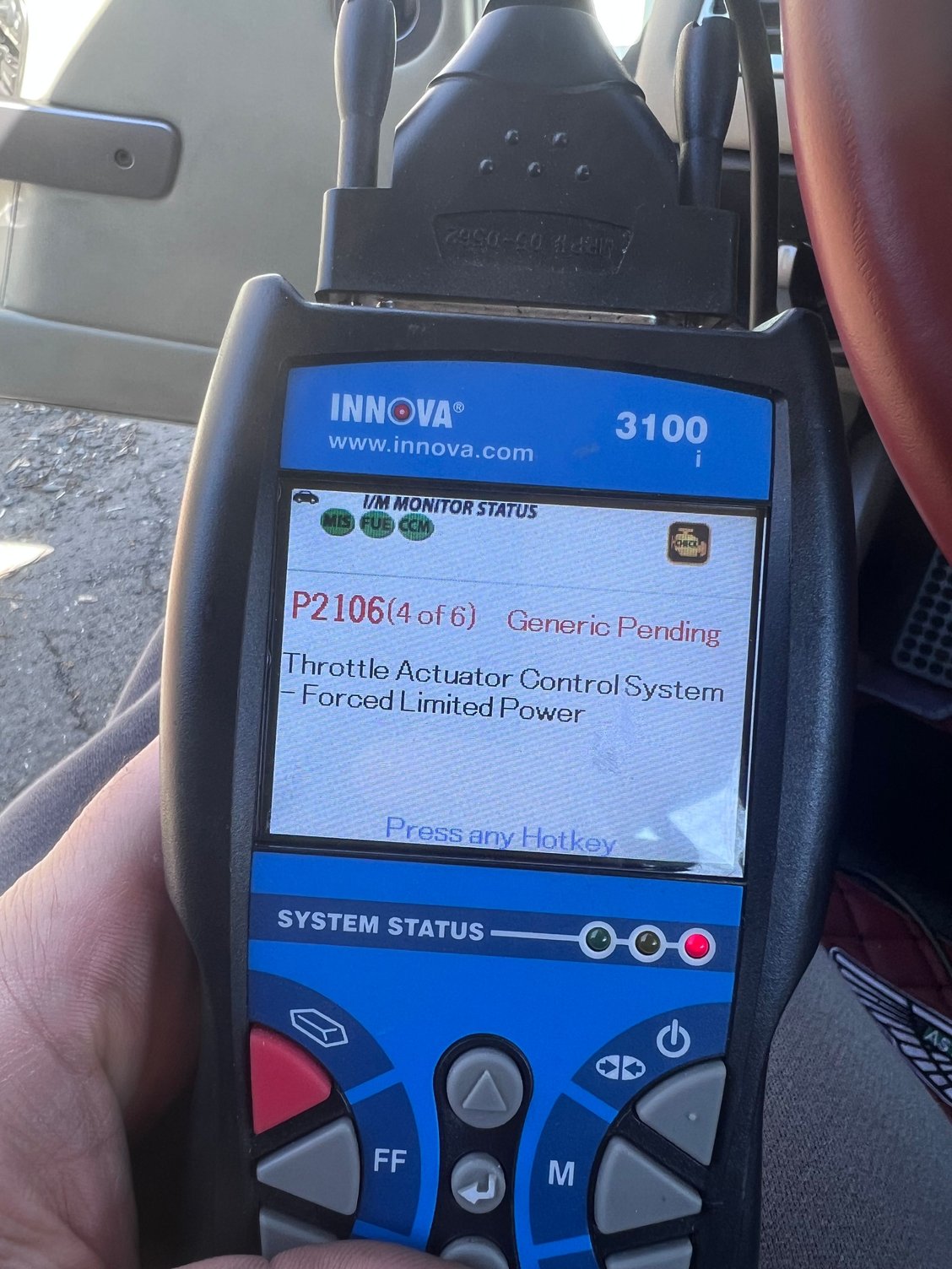

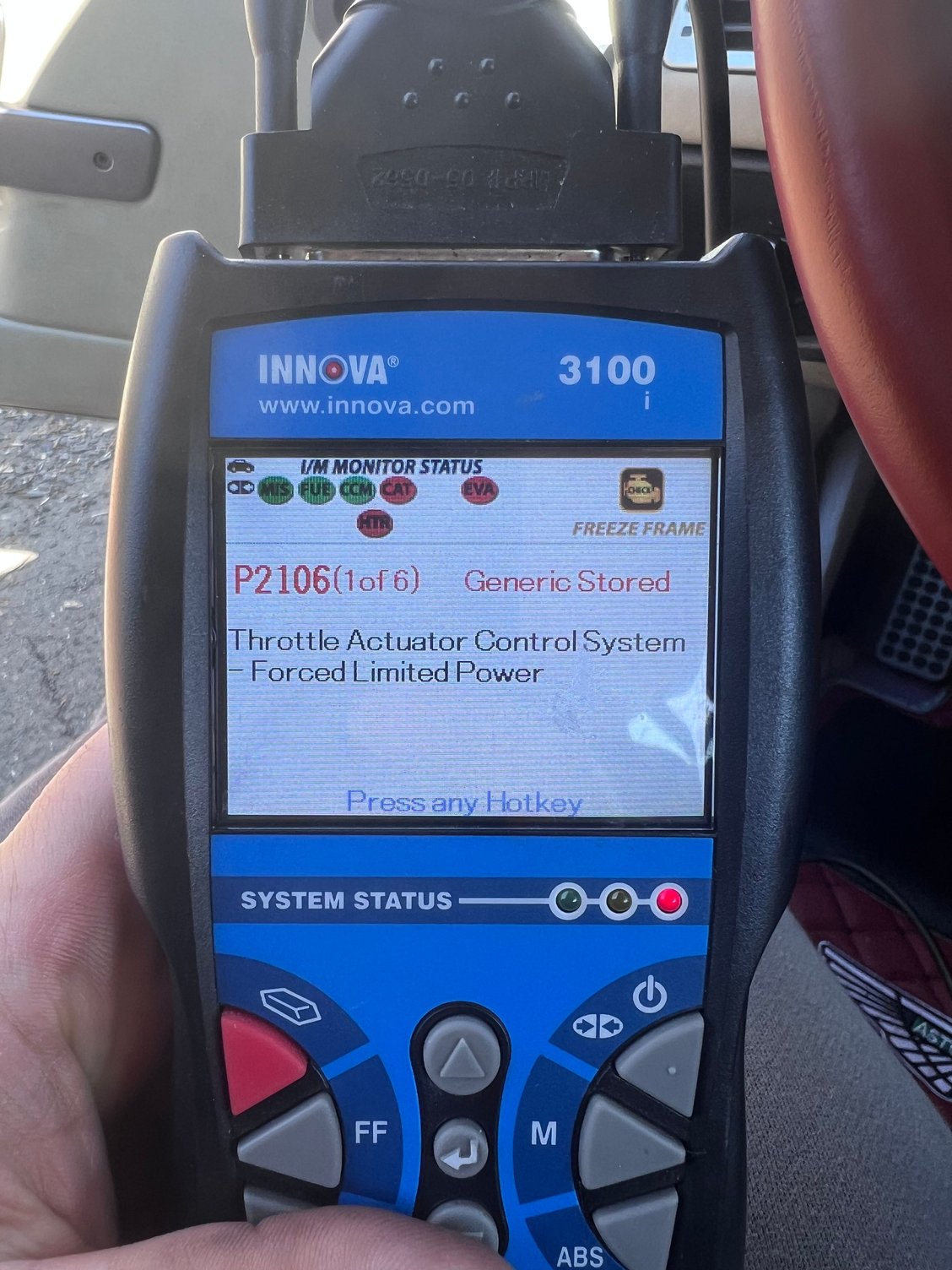

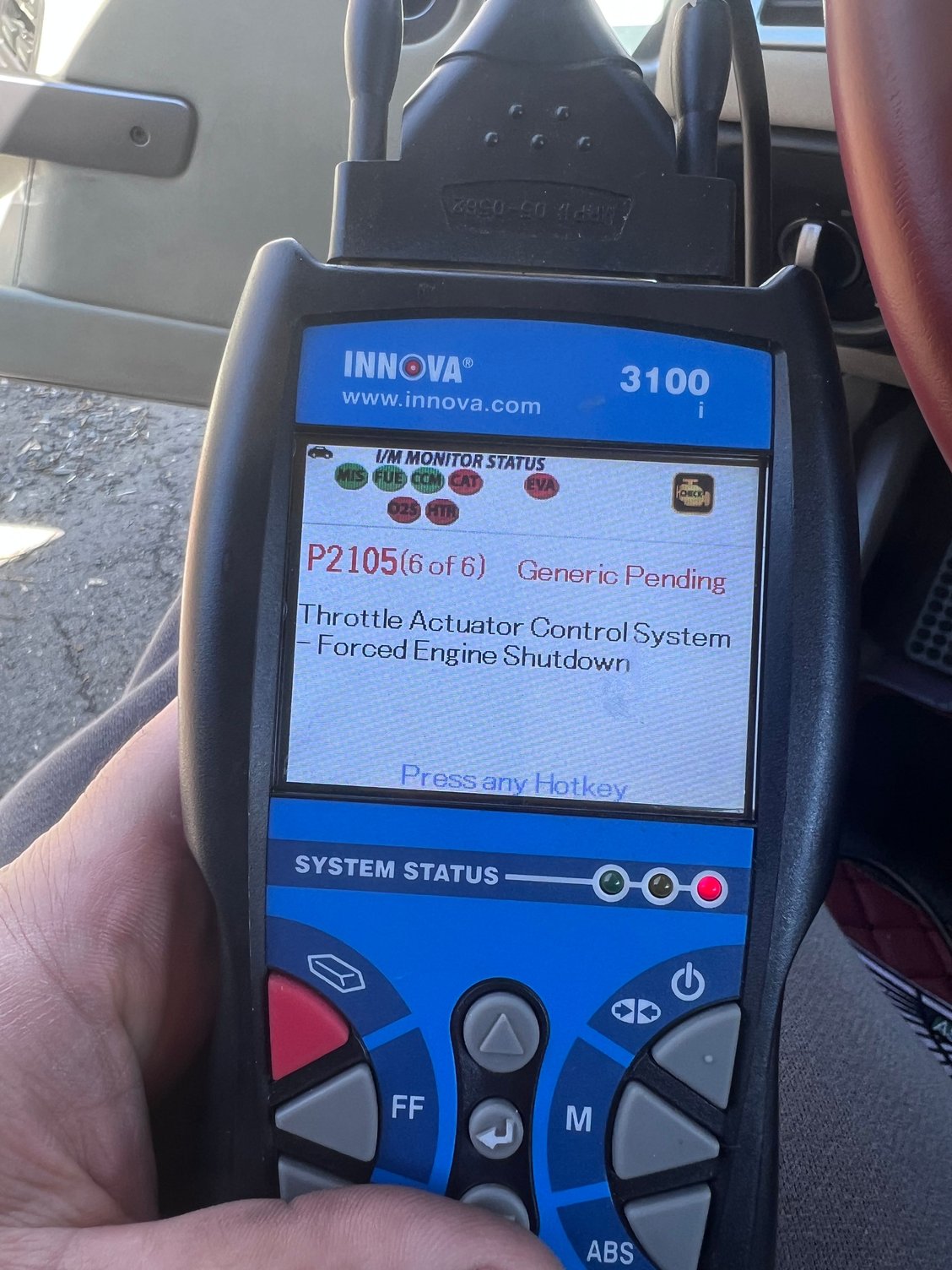

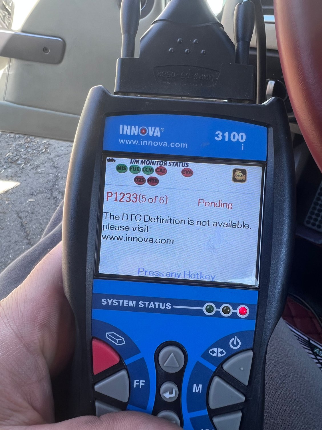

Co
Codes I’m getting in a simple scanner

So just an update. Like to come back and post progress for anyone else having this issue. Yeah laying on your back pretty much upside down is the way to get at those bolts. They’re 8mm. The 2 connectors come off easy after it’s loose. But this fixed my issue. No more check engine light and the car is firing on all 12! I used a pedal from a 2014 rapide. Accelerator Gas Pedal Assembly 8d33-9n734-ac Oem Aston Martin Rapide 2014 Was the eBay listing. Part numbers are different. The base is slightly thicker on the rapide assembly. But it still fit. There are some differences in the assembly like the location of the spring. I should’ve took pictures prior to installing.
