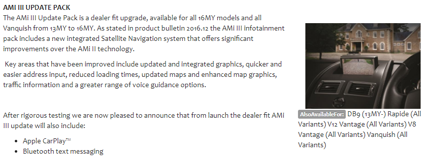

Could you explain further? I thought NA engines don't see power increases through purely software? Also does anyone know if the 16 DB9 GT can be upgraded to AMIII interface? I contacted AM directly twice and their online form said it would be forwarded to a local dealer but they never responded. That's also why I asked if any in or around NY has a preferred mechanic or dealer as that one doesn't seem to care.

N/A engine can produce more HP with simple tunes. I believe it is 30hp gain from a software download.
Found this online:

That's exactly the article I referenced when I attempted to contact AM twice with no response. Anyone on the forum with a DB9 GT get yours uograded with carplay via AM III?
