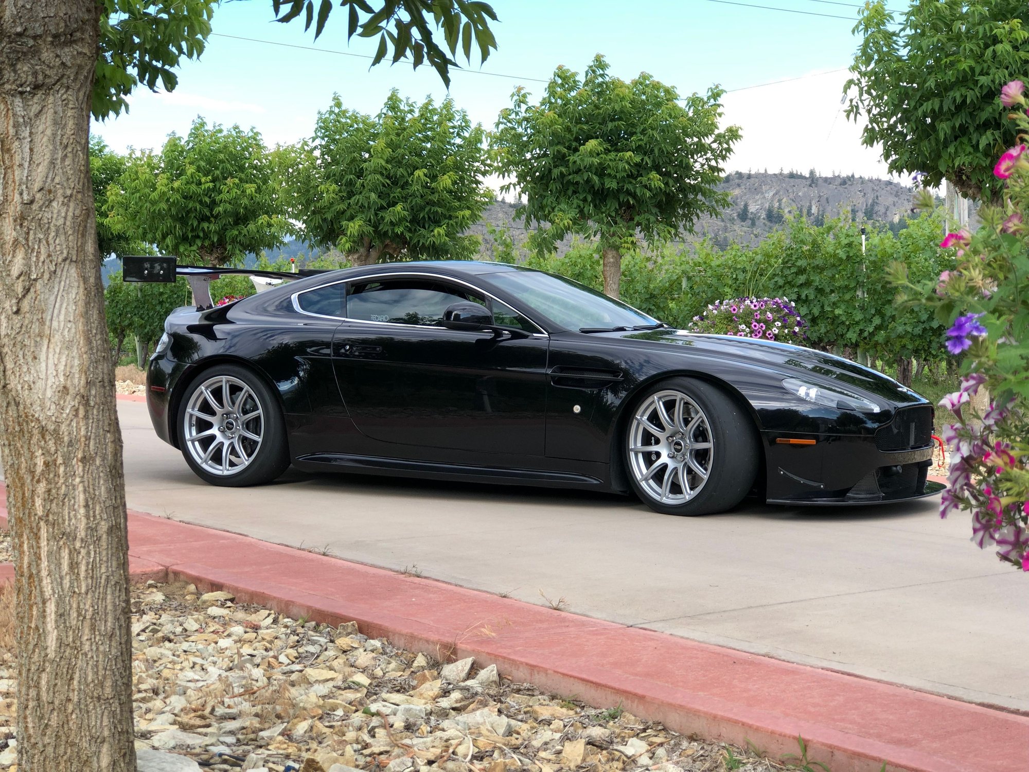

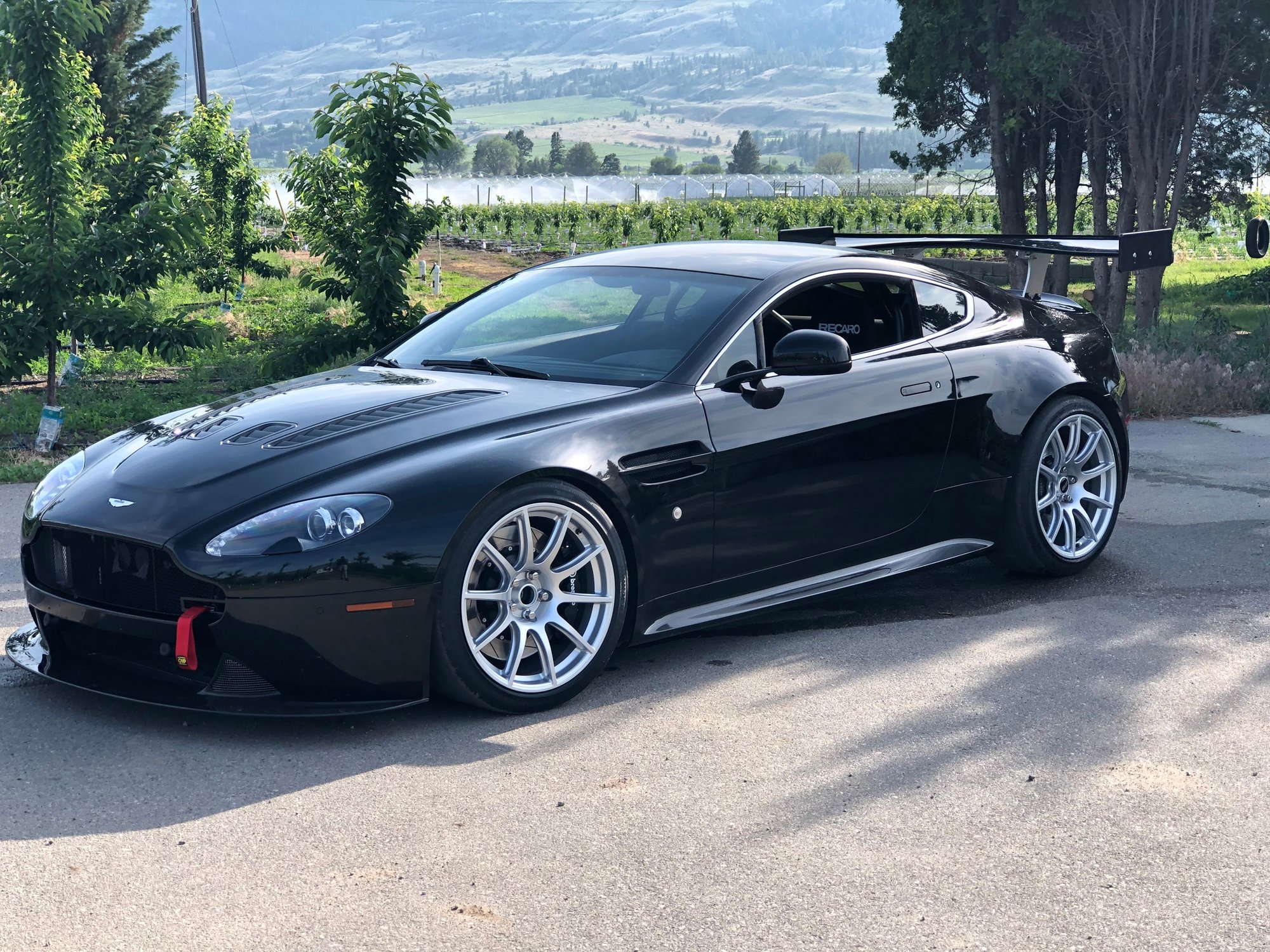

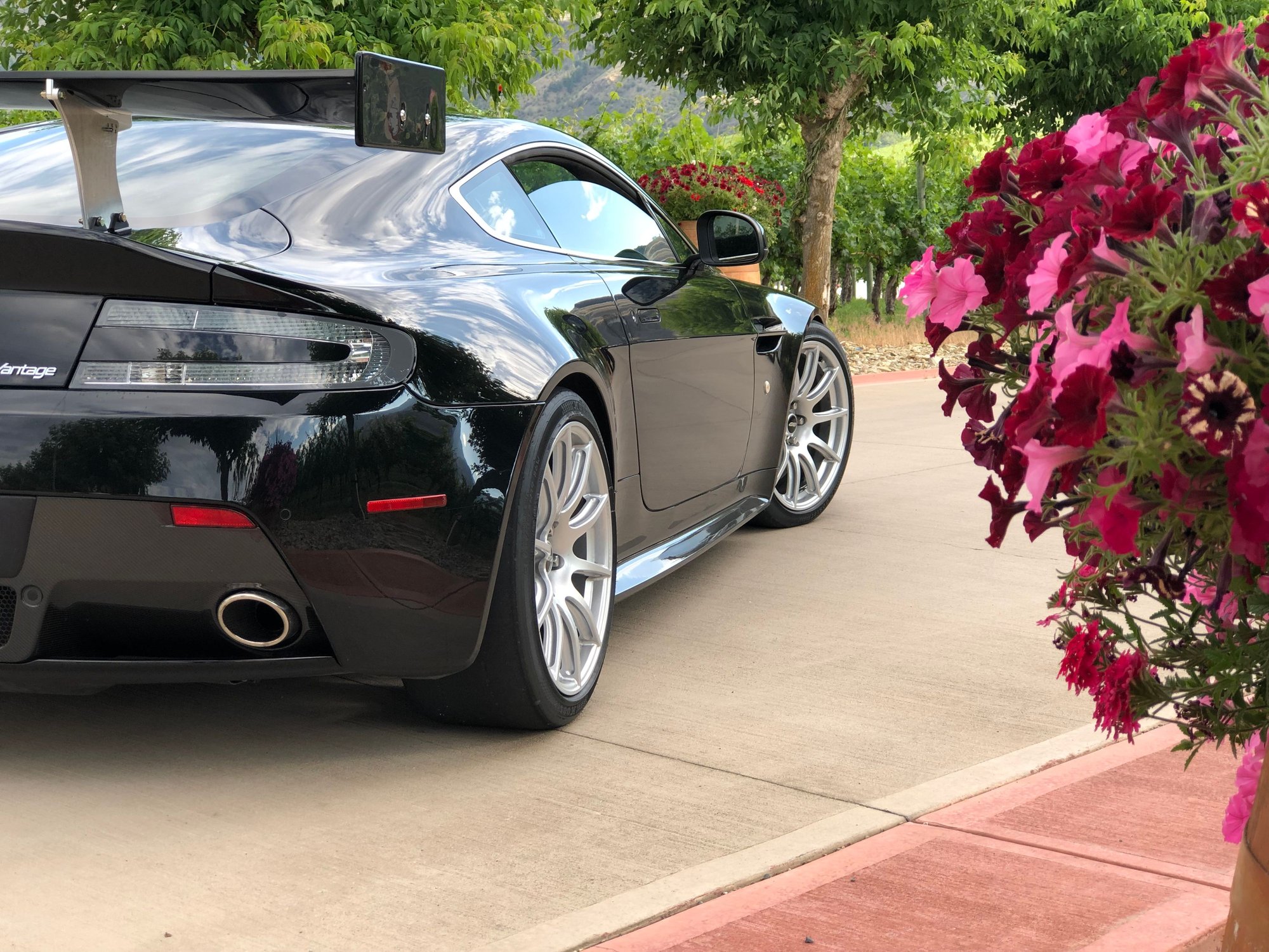

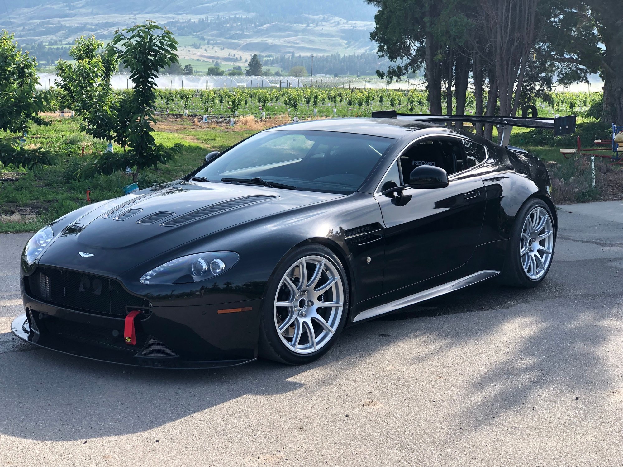

Hello Everyone,
Hope you are all settling into the New Year. We're looking forward to bringing you all lots of fun new products this year and running our customer experience track day again.
VelocityAP is very pleased to have partnered with Apex Race Wheels to bring you some awesome options for reasonably priced, yet high quality wheels for Aston Martin cars. For those of you unfamiliar with Apex Wheels, they have established themselves in the last decade as the go-to company for affordable yet strong and durable lightweight wheels amongst some serious racers and track day junkies.
However, they make a couple of very attractive styles & finishes which suit the Aston Martin to a 'T'. The Aston Martin compatible wheels are currently offered in a Flow-Formed manufacturing technique, and include a comforting warranty. We will be working with Apex in the coming weeks to provide some more photography showing the EC7 style as well as some more finish & car colour combinations for both.
Fitment
Offsets are set up to run a more aggressive and 'flush' look, but still to remain functional and work with most lowering springs & coilovers. Recommended fitments:
18x9.5 ET35 Front & 18x10 ET40 Rear
18x10 ET40 Front & 18x11 ET52 Rear
19x10 ET40 Front & 19x11ET52 Rear
View Sizes & Finishes
Flow Forming
Benefits of forging, without the pain
These APEX wheels are produced using a manufacturing process known as flow forming. This process significantly reduces weight in the barrel, which has the greatest impact on rotational mass. During the manufacturing process, rollers apply high pressure to the inner barrel, compressing the aluminum into its final shape. This effectively eliminates porosity and aligns the grain structure of the metal, which increases tensile strength. The end result is a lightweight and extremely strong barrel that equals that of a traditional forged wheel at a fraction of the cost.
Testing & Certifications
Verifiable 3rd party testing
Many companies promote their wheels as being certified by the VIA when they actually aren’t. That’s like using the USDA logo on food without permission. APEX wheels get officially tested and registered by the VIA in Japan, and we have the proof to back it up. Learn more about false VIA claims.
Japan’s JWL is a commonly followed standard for wheel load ratings. Our flow formed wheels meet, and most exceed, their load rating requirements. Most manufacturers only meet the minimum while some don’t even do that. Check and verify load ratings before you buy. Learn more about wheels that aren’t JWL.
Weight & Strength Optimization
It’s all in the details
Various design features were implemented to ensure that the EC-7 & SM-10 wheel design was light, but had even more strength to handle the abuses experienced in endurance racing. We began with a beefy, multi-spoke, one-piece design. We added reliefs in the mounting pad to remove weight between lug holes, where we could safely save weight. The design was then run through Finite Element Analysis (FEA) to further optimize the spoke and barrel design. The result is a lightweight wheel with extra strength in all the right places. Use with confidence. It’s over built for both street and track.
Finishes
Because being faster is just not enough
The EC-7 & SM10 wheels are available in multiple finishes. All APEX wheels are finished using a comprehensive multi-stage liquid paint system over a powder coated base coat. Standard finishes include gloss-metallic finishes, and semi-gloss or matte finishes.
Often overlooked, painted or powder coated lug hole seats can cause hardware to loosen or begin the spread of paint chipping to more visible sections. The coating process of the EC-7 leaves lug holes, center bores and mounting pads untouched, which ensures proper fit and torque values.

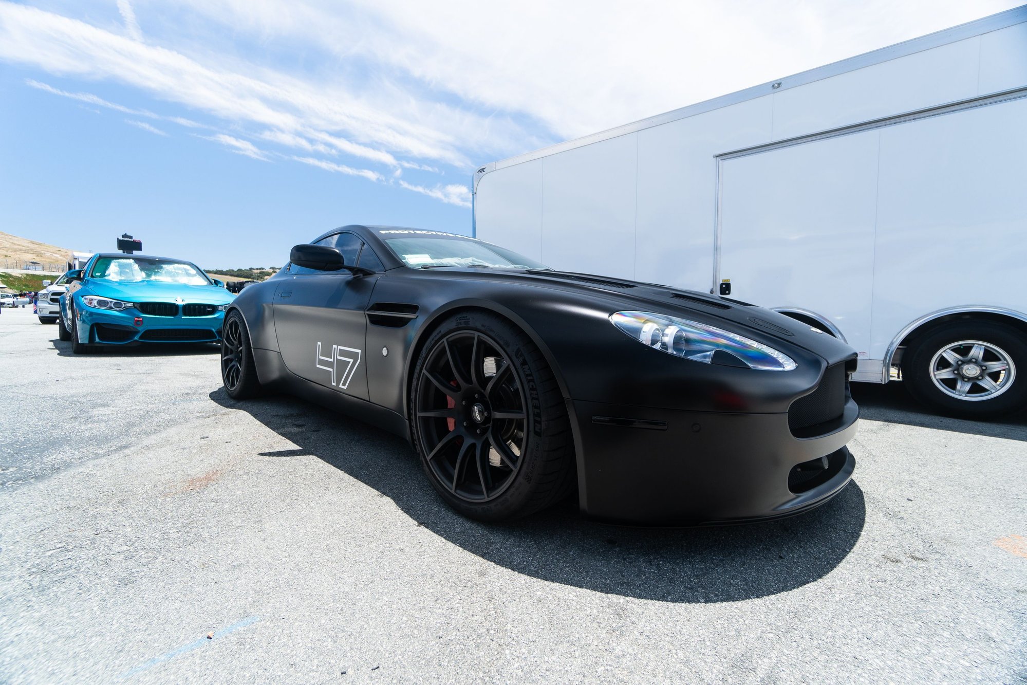

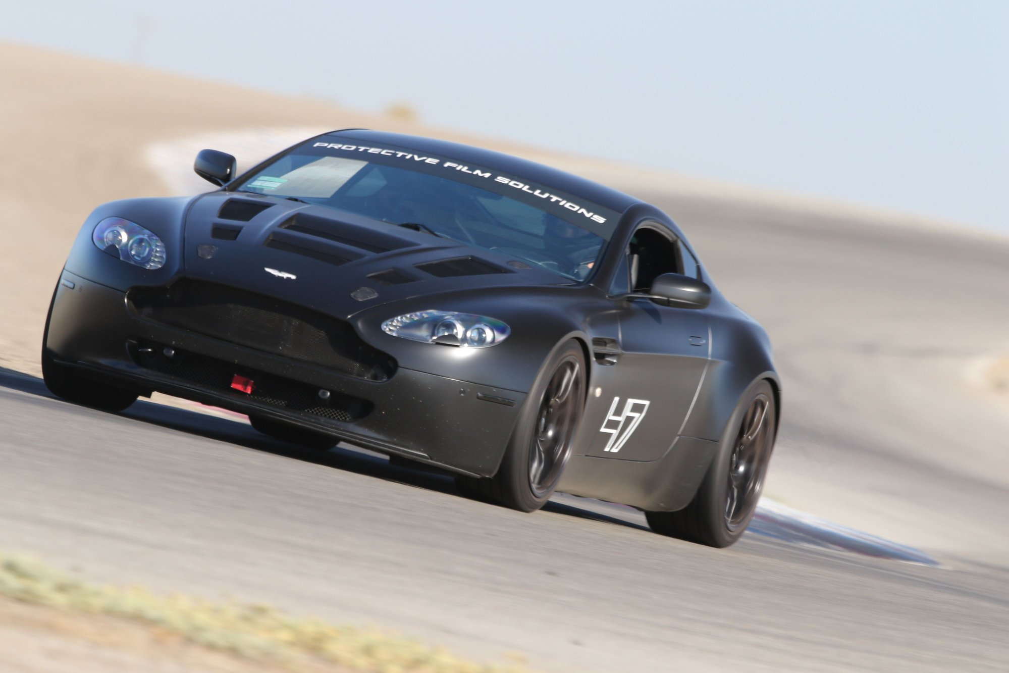

Stuart, Great look on the #47 coupe in your original post. Is it a GT4, or a "track special"?
What are the wheel dimensions and profiles (as illustrated in the Apex on line catalog)
Body appears to be an early car, no big Kamntail on the liftgate and an early fascia, but includes a hood with front corner latches and big holes.
More pictures of this car?

So this car is not a GT4 or 'Track Special' but has been modified. Lowering Springs, some exhaust work and I believe it's a VCollection hood.
