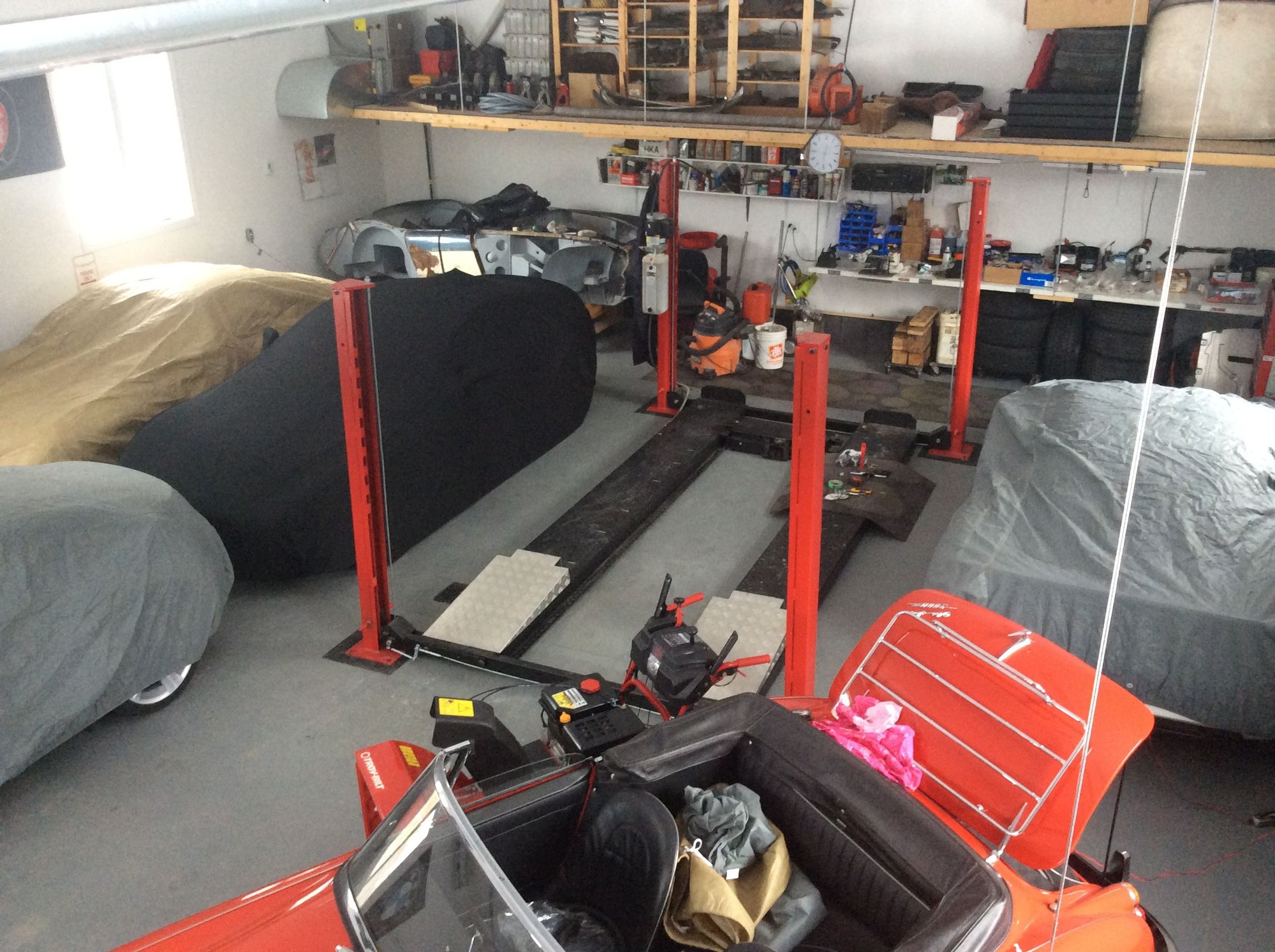

Originally Posted by era2076
Where is the pic of the 62 ?
chr
The 62 is all in pieces in my shop , superstructure is all repaired , engine gearbox/OD is rebuilt . Its waiting for me to get a new set of wings (fenders) for it then it goes back to the bodyshop to get them all fettled and fitted along with door and shroud repairs etc etc .
It will be a couple of years before it even looks like a car again .
its there tucked away looking sad in the corner , on the shelf top right is the original factory hardtop that was sold with the car in 62 .
