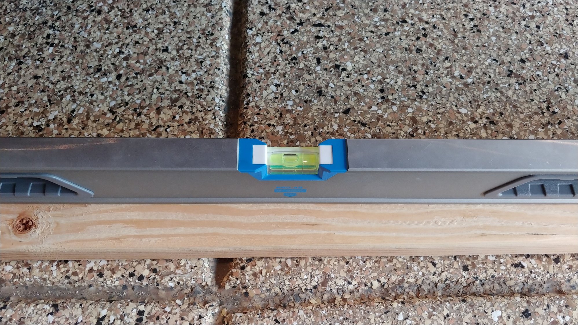

I changed the engine oil, coolant, and power steering fluids this weekend for the first time in my 2005 DB9. Never had a vehicle harder to work on than this. I filled it up to 11.5 quarts and saw the oil level at midway between MIN and MAX. However, I had just started the car and moved it forward a bit in order to let the oil filter fill with oil. Thought I was good to go and came back about an hour later to check and my oil mark had moved to above the max mark! So I removed about half a liter to get it back to mid mark where it stayed, in that bay at least. In my other bay, now it's reading above max again even though the slope of the garage is very similar to the other bay. This is ridiculous that a car holding 11+ quarts of oil can be so easily swayed on its dipstick. I'm pretty sure most of us without garage floor drains don't have perfectly level garage floors (to allow water to run out of the garage). I've included a picture of the slope of my garage for reference.
Having only put in 11 quarts, I'm pretty confident I am not overfull. How do you guys ensure a perfectly level car to check your oil?
Now to give back, what I learned was to follow Aston's advice on checking the oil. I'll attach their service bulletin at the end of this message. I tried three separate times starting the vehicle and then checking the oil, and each time the oil level reading lowered roughly 50% of the way between the MIN and MAX mark after the car had been started or moved, giving me a false low reading until I let the car sit untouched for about 30 minutes, as Aston states. For those new to these vehicles, I'd recommend heeding that advice or you'll get false readings like I did. Let it sit for 30 minutes, make sure the oil is cold, and check the oil that way.
Picture of garage slope:
Slope of garage. Car nose to left (slightly higher).
