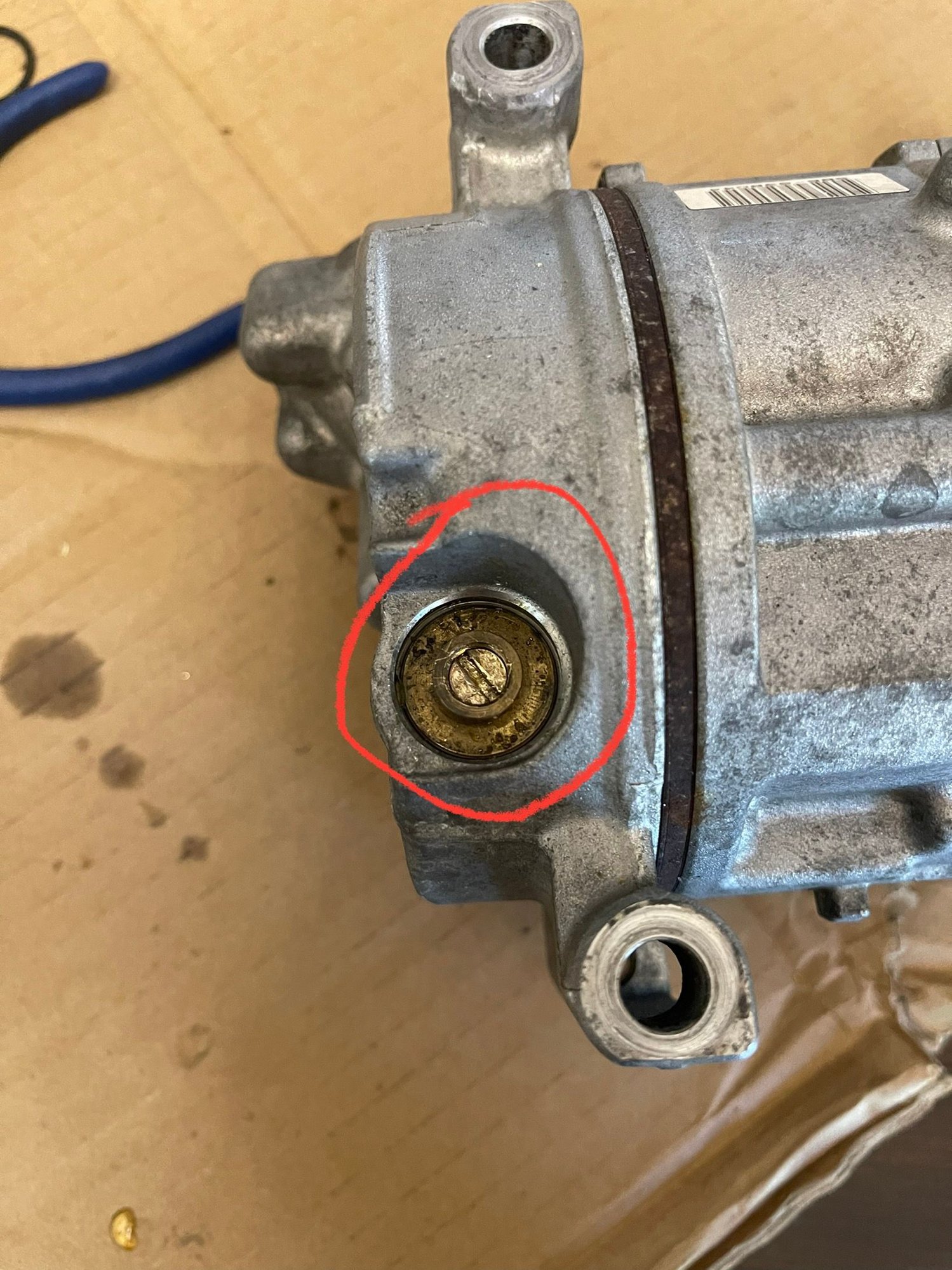

thank you for your input.
my friend has equipment and I will ask him if he knows how do do all theses.
as far as oil goes it seems like it comes pre filled with oil and leak dye. See attached photo , there is epoxy like clear material on slot for philips flat head screw driver. To me it seems like during b manufacturing process they fill the oil, tighten the scre plug and put a drop of epoxy on it so it can’t be open easily

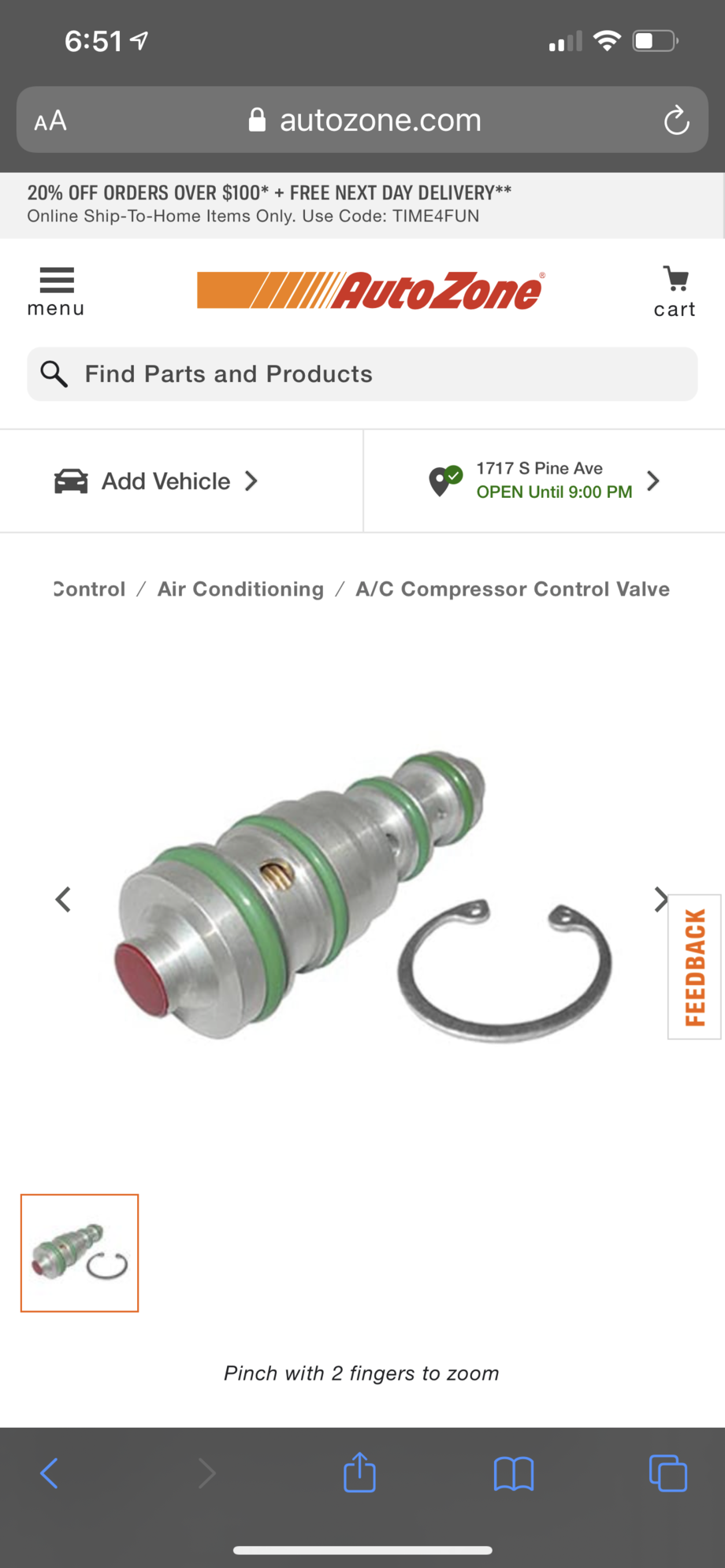

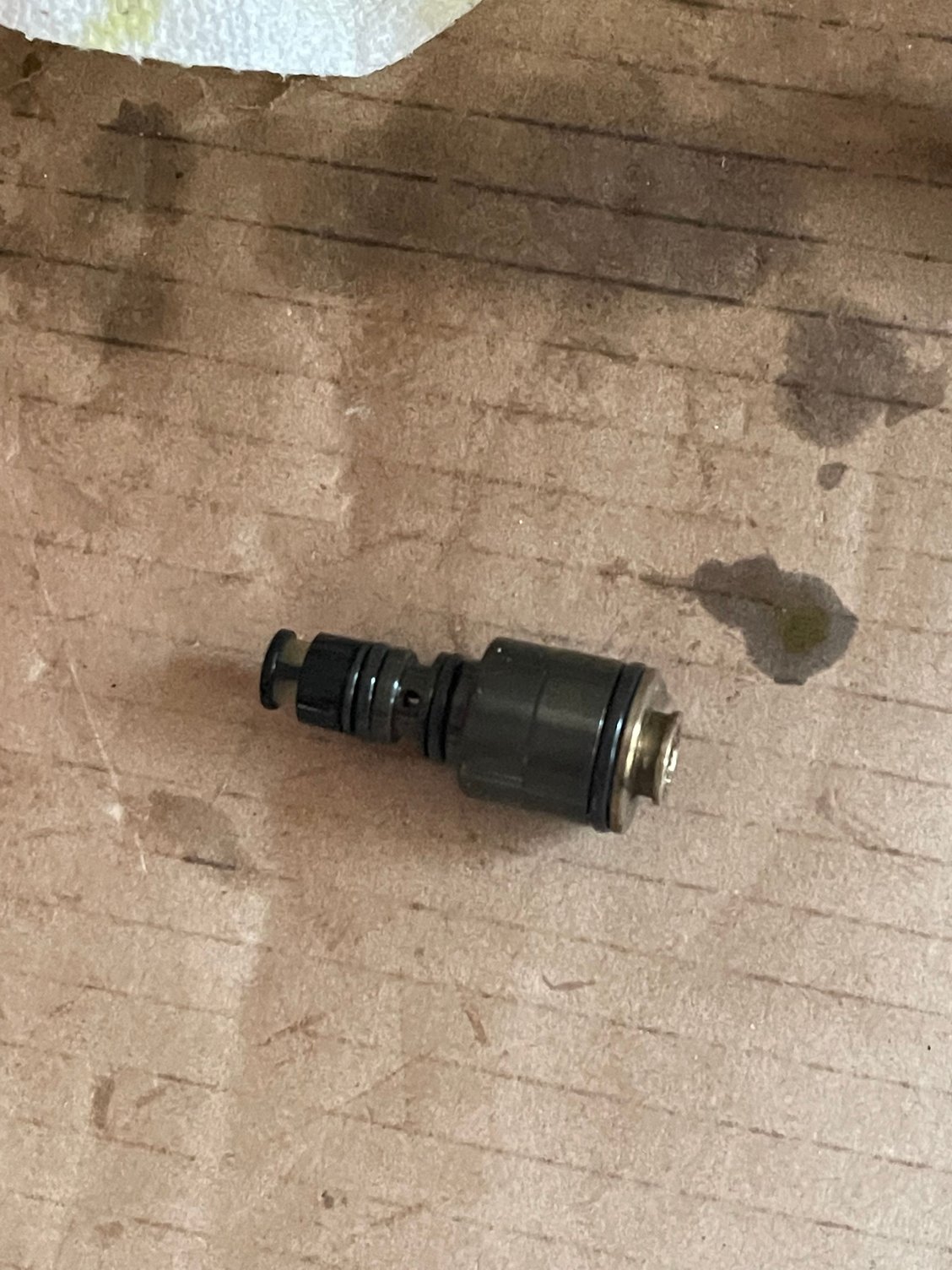

Well finally got around to open and remove AC compressor
it was leaking at AC Controll valve
I removed the snap ring and was able to pull out AC control valve there are multiple o rings and those were probably the culprit.
I have new compressor as back up at hand but I love to fix things so I am going to find o rings then fill up with pag46 oil and install the old compressor , new receiver drier with all new o rings every where , vaccine the system and recharge it then see
