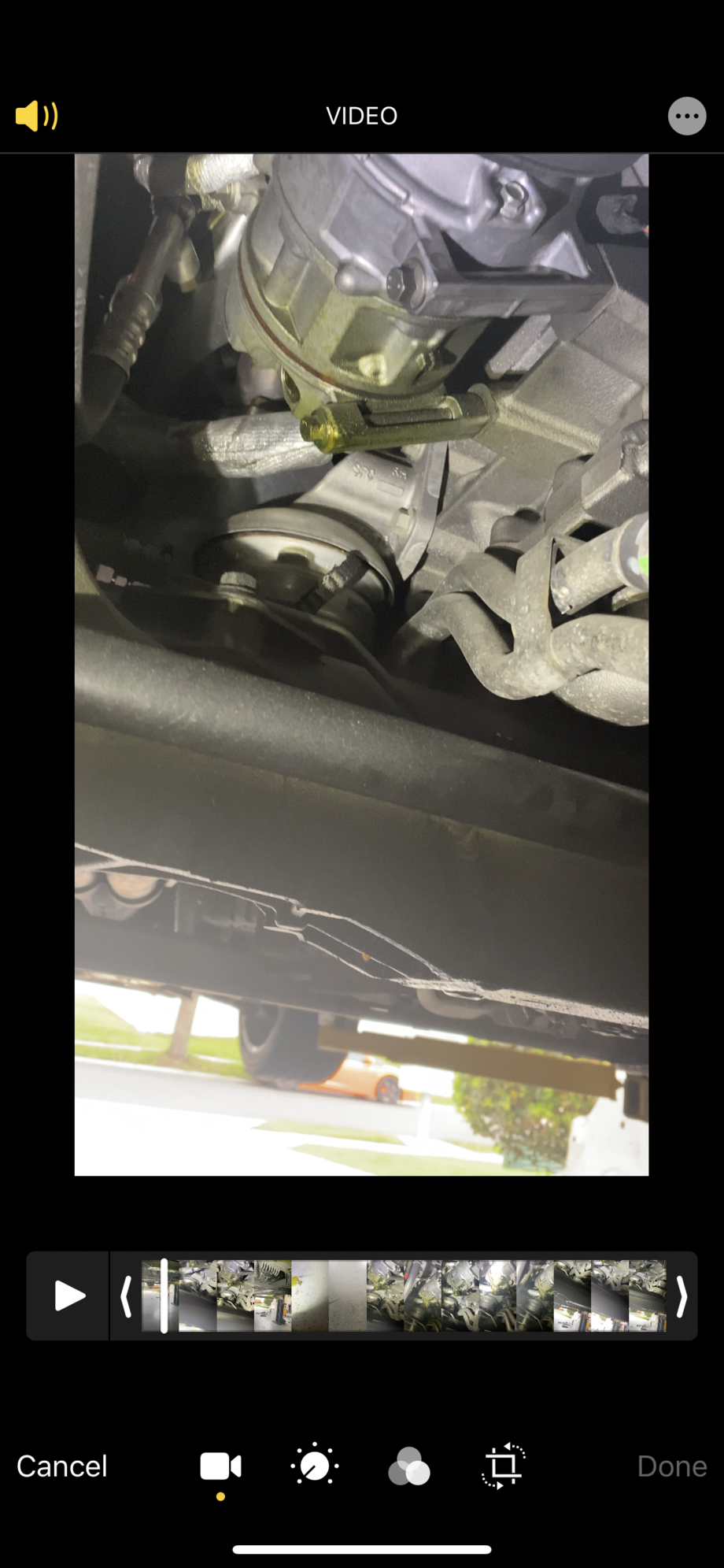

Hi guys
I have 2009 DB9
I noticed this fluid on passenger side I think it’s on AC compressor but it’s quite oily
AC works fine. Compressor may be slightly noise but not very loud.

A/C tracer dye, noisy compressor? She may be ready to expire. Clean up the mess to trace where the source is. Have you ever had the system repaired or recharged? Overcharging will set off the pressure valve on the compressor and spray some oil/dye mix out.

in this compressor , oil inside compressor is mixed with refrigerant? Or is it two separate compartment e holding Freon and other holding compressor oi?
leaked liquid was oily and green.
my car was recently at dealer and dealer told me compressor is leaking but I am trying to figure out if it’s compressor oil which is leaking or is it Freon?
compressor oil is usually “PAG OIL” or something like that which is usually clear so how did the dealer put dye in the oil?

Dye is in the compressor oil (PAG) to identify a leak in the system. You obviously have a leaking compressor. Not a separate thing, it's a combination with the 134a refrigerant. It will eventually leak out and quit blowing cold. Dye is added to the system from new build. You should be shopping for a new compressor replacement.

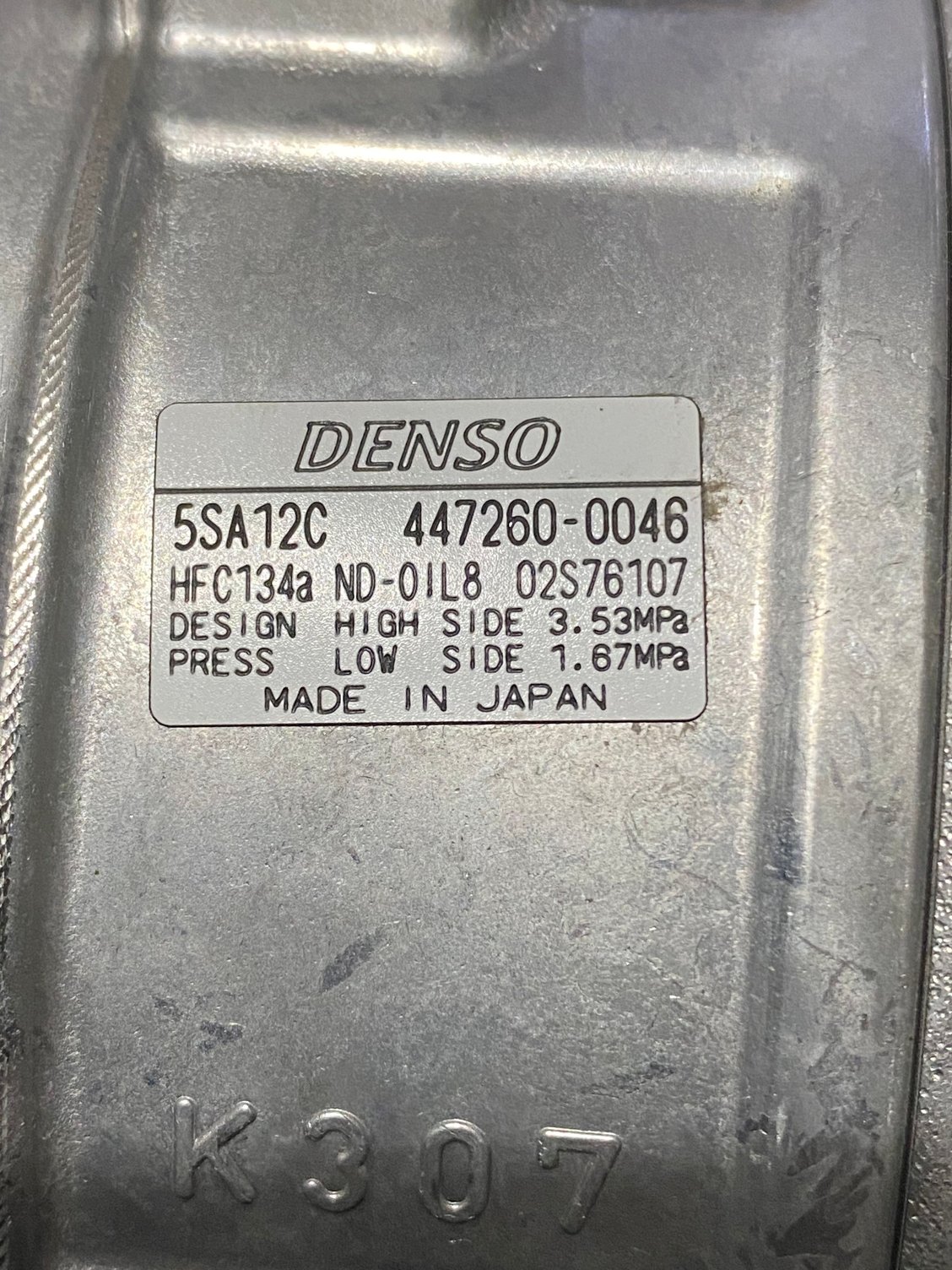

Wildcat1212 is a glorious beacon of lightWildcat1212 is a glorious beacon of lightWildcat1212 is a glorious beacon of lightWildcat1212 is a glorious beacon of lightWildcat1212 is a glorious beacon of light
Thi
s is the label on new AC compressor

J doubleU Is a GOD !J doubleU Is a GOD !J doubleU Is a GOD !J doubleU Is a GOD !J doubleU Is a GOD !J doubleU Is a GOD !J doubleU Is a GOD !J doubleU Is a GOD !J doubleU Is a GOD !J doubleU Is a GOD !J doubleU Is a GOD !
A/C compressor comes with oil if new from Denso. Reman unit may not. Most guides tell you to drain oil from old compressor, measure. Then drain and refill new compressor with same amount that was removed. Also you should be replacing the receiver dryer at the same time. Oil description is on the tag ND-8 which is Nippon Denso's term for PAG 46 common oil for 134a. Compressor fill amount is 80ml so around 3oz mark. I would make certain it has at least 3oz before fitting. Should have a bolt in the middle of the housing to add or check oil.
