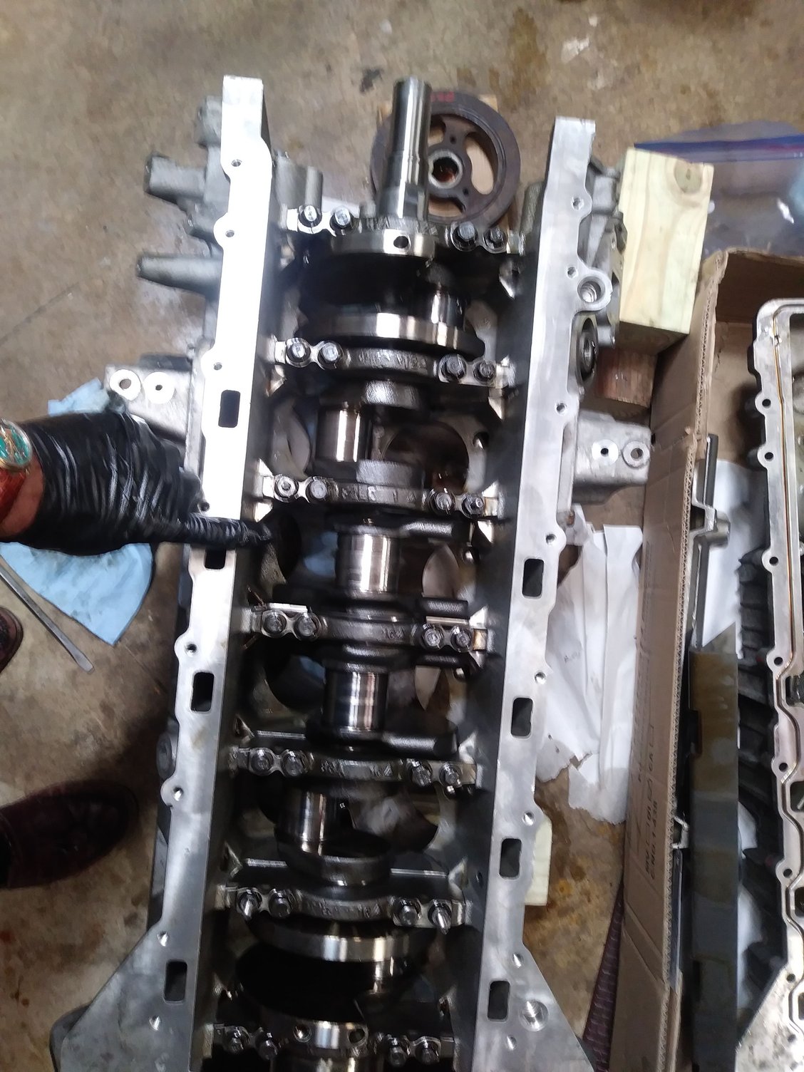

The good news is that confirmation will come once they drain the oil, or worst case drop the oil pan.
FWIW, here's what mine looked like minus two big end bearings. Biggest challenge was the metal fragments wiping out every bearing surface in the motor and polluting every oil passage.

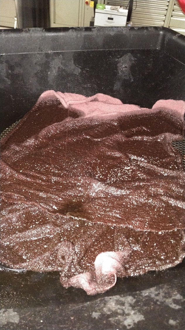

Well it looks like the motor is toast. They pulled the oil pan and there's more metal in there than a Slayer concert. Replacement motors are at least $35k with way more miles than my car has not to mention labor on top. That being said, and I know this is blasphemous, but I'm seriously considering a swap. Given these cars share a lot of components including the block with Ford my first thought is a supercharged or TT Coyote build from that generation Mustang. Does anyone know what Ford block the 4.7 is based on? Or if this is even remotely feasible?
