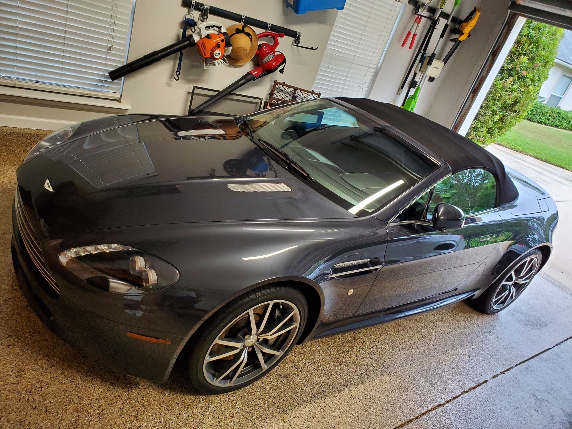

Finally got the Vantage back last week, complete with a brand spanking new motor. Took it on a weekend away in Amelia Island over the weekend and it was fantastic! Just got her all cleaned back up and in her spot and couldn't be happier.

Fantastic! I would recommend an oil & oil filter change at no more than 1500 miles. That is the old school break in change period. No one does it anymore, because no one really cares about the cars they sell. They want you in the replacement as soon as they can make it happen.
