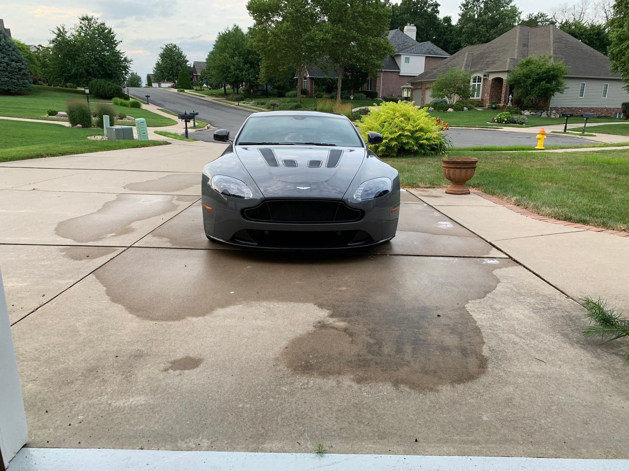

Hi guys did a search and didn’t get a very great direct answer on this so thought i would ask for your opinions:
have a manual v12 S (which i love btw) have about 5k on it already ( pics below) and am looking for a high pitched sound especially high rpm. Don’t want crazy Loud and don’t want a CEL. Should I do x pipe? If so which brand?(fabspeed, velocity etc) or should I do exhaust (like quicksilver or whatever) thanks again here are few pics!
