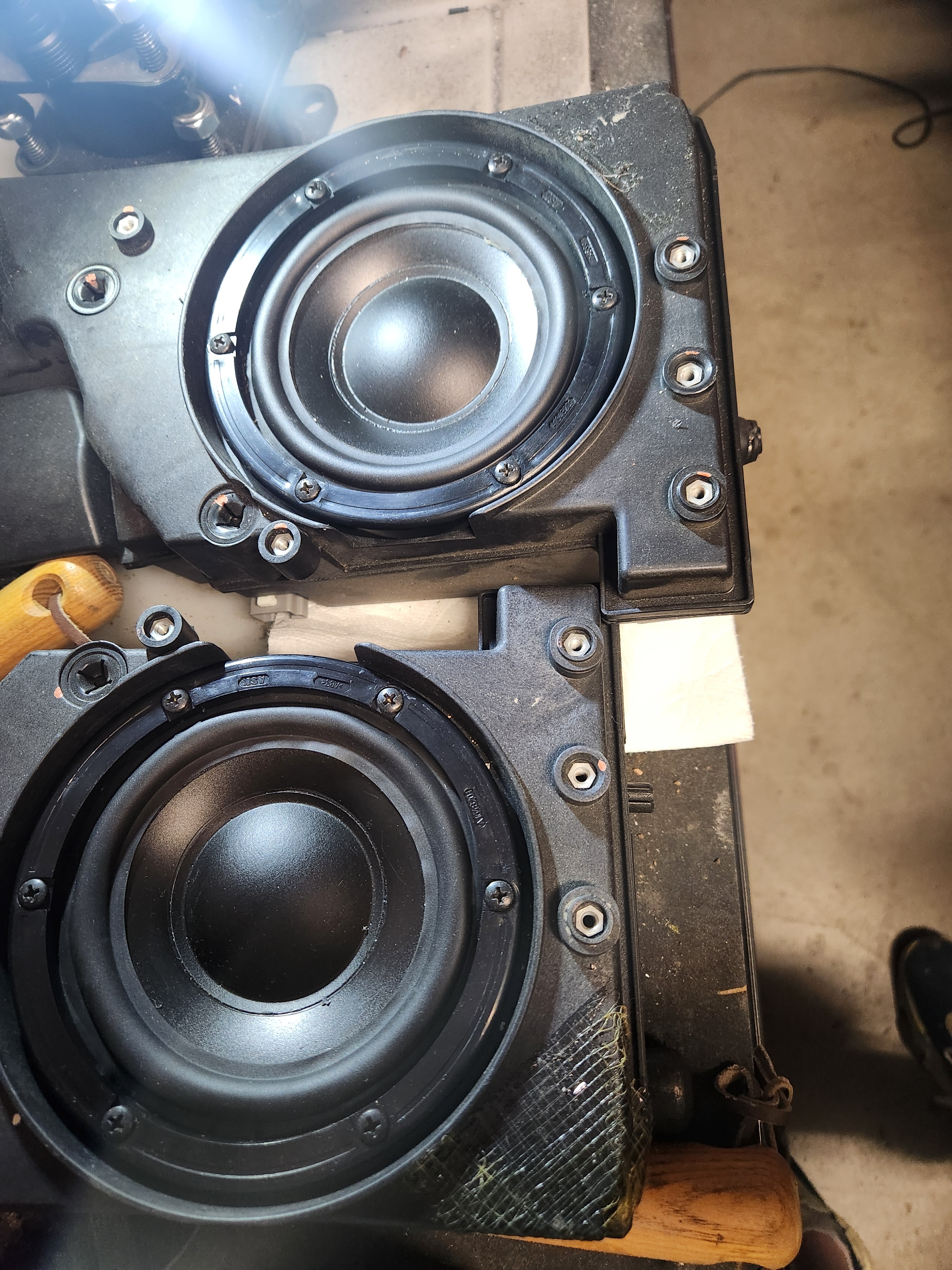

When working on my CEM yesterday, I noticed the foam on the passenger side footwell speaker was almost gone.
I removed the speaker, cleaned the foam, and ordered some refoam kit.
It should arrive on Monday.
First time I am doing this so I am curious about the result...

I have since that post sourced rubber surrounds for front center Rapide speakers and it turned out fine. Rubber surround will last longer. Usually they sound blown out and rattling when just a small amount of foam comes apart. Did you purchase a DIY kit? What adhesive are you planning on using?

After trying to source any driver that matched the 6 screw pattern and fit in the box it was very limited. Repair is fairly straight forward, clean as much foam as possible apply adhesive to speaker cone edge and outter basket and center as close as possible as the adhesive cures lightly press cone a few mm inward and release to make sure it's aligned with the coil.
I use E6000 clear adhesive. Do not use it unless your outside!

I got the foam repair kit,and I am going to use E6000.
Arriving tomorrow, I'll keep you posted.
