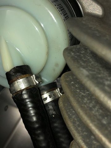

Hi All,
I just completed a Fluid Change in the Transaxle of my 2012 Aston Martin V8V S.
While working on the fluid change I noticed a white plastic bottle that looks like a fuel filter and what looks like a fuel pump ahead of it and to the Left.
The plastic filter had two hoses coming out and the hoses look like they need to be changed. One hose went to the Item ?? fuel pump in the lower photo.
The way the hoses are deteriorating and the location of these items makes me believe maybe part of the fuel system.
Can anyone help in identifying what these parts are? Is it a fuel filter and a fuel pump? or ???
Any help would be greatly appreciated.
Plastic Canister behind Transaxle.
What appears to be a fuel pump.
. The plastic filter had two hoses coming out and the hoses look like they need to be changed.

I am sure someone else will chime in, but I've had pretty good luck typing the part number (on the plastic part above for example) in and just seeing what the computer finds. But you are right - you are going to want some fuel/oil line hose and some new single ear clamps!

ASM fluid reservoir, leaking or loss of fluid to the pump could cause shifting problems and possibly both shifting which can leave you stranded.
