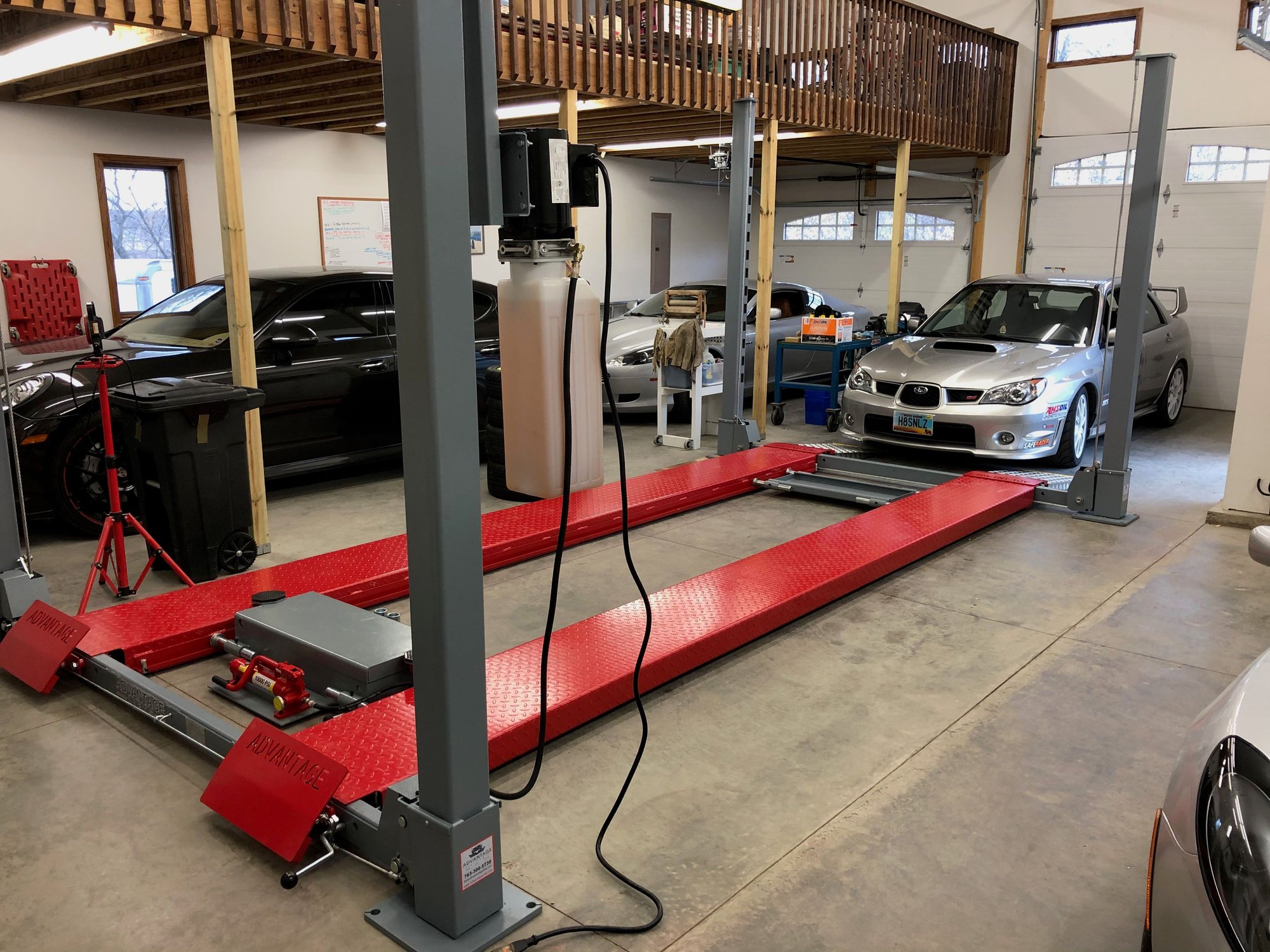

I am in the process of gathering resources for a Mechatronic seal replacement, oil pan and filter replacement, and trans oil cooler flush. I am hoping I have everything I need and am particularly buoyed by the installation of a shiny new 4 post Iift.....(As you can see, the Aston is waiting patiently for it's turn on the operating table)
My new Advantage 9000 XL with rolling jack trays
