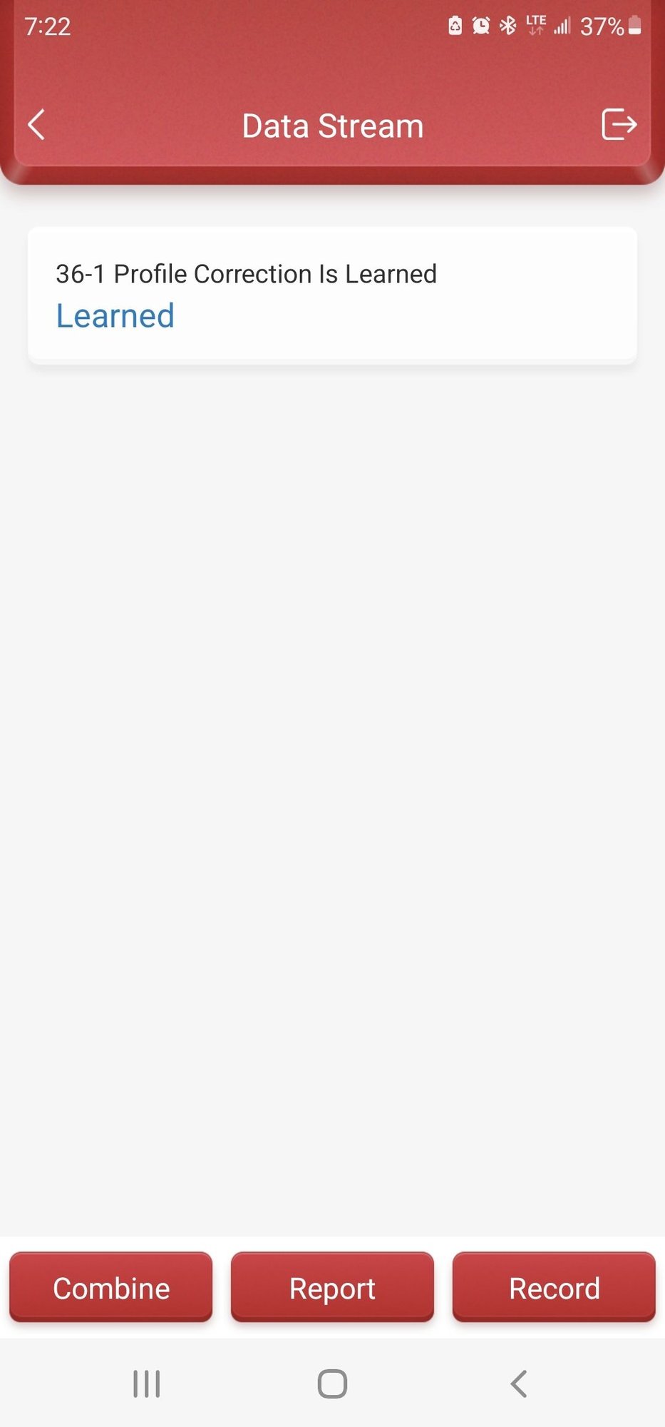

Ok, did you check "Misfire profile correction learned" (PID no 36-1) flag or just "misfire monitor enabled"? If "36-1" is set then you should see misfire counts which means the system has learnt the misfire factors successfully.
Validating this. In my Foxwell, the value you're looking to see is that 36-1 was learned. That's your misfire correction.

How do you enable to the misfire monitor and reset 36-1 so that it's ready to do the coast down procedure? My Foxwell NT530 shows that misfired monitor is not enabled and 36-1 is learned and I haven't found where/how to reset them.
