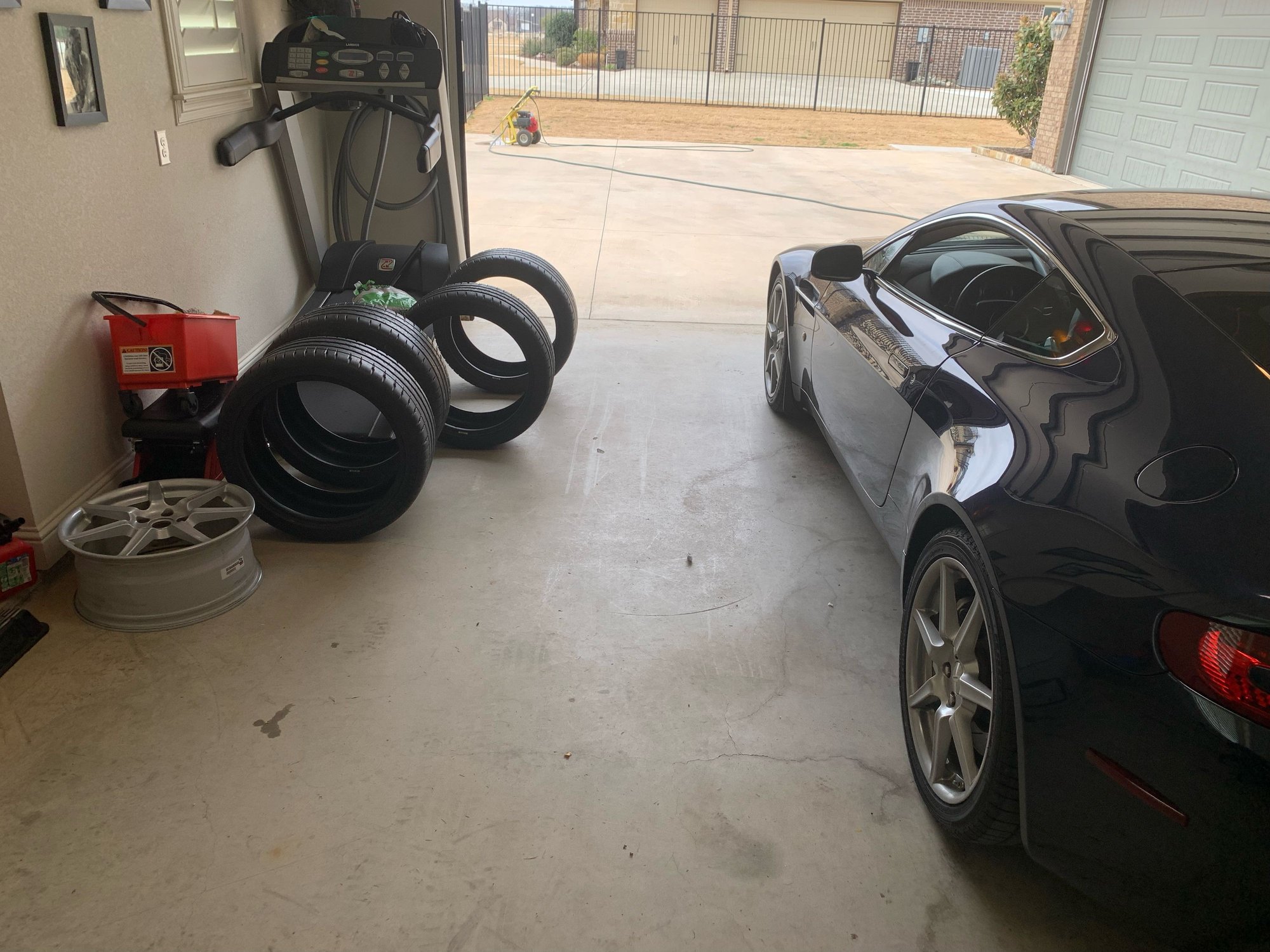

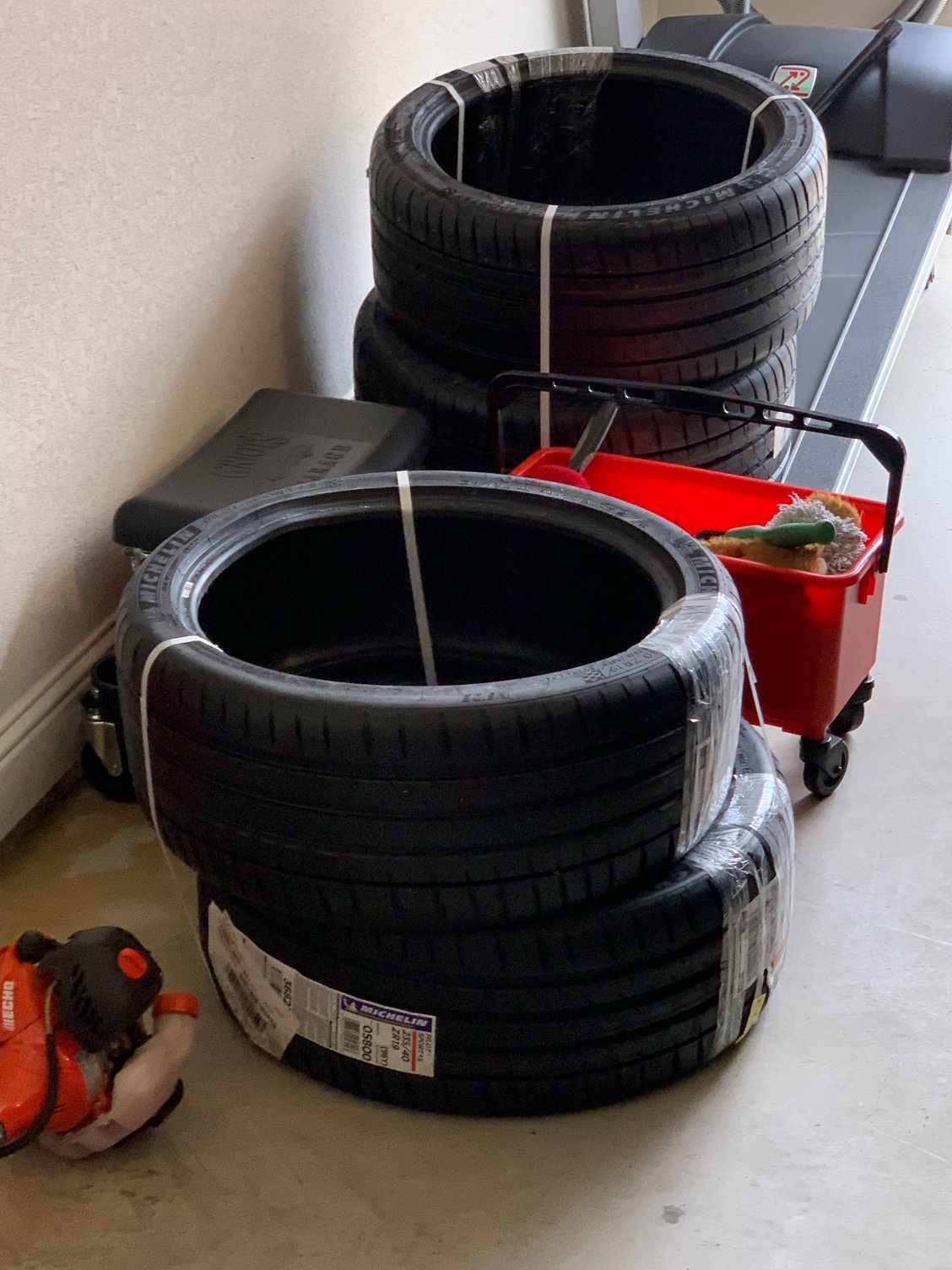

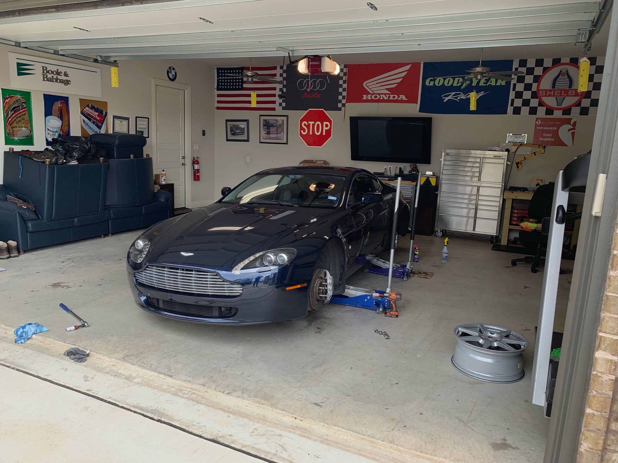

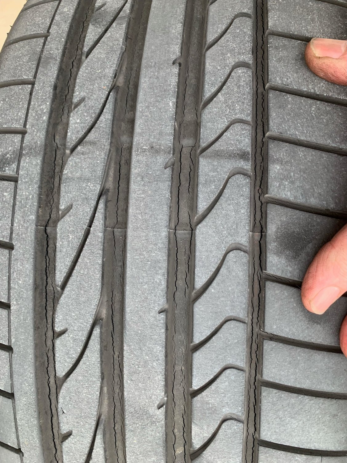

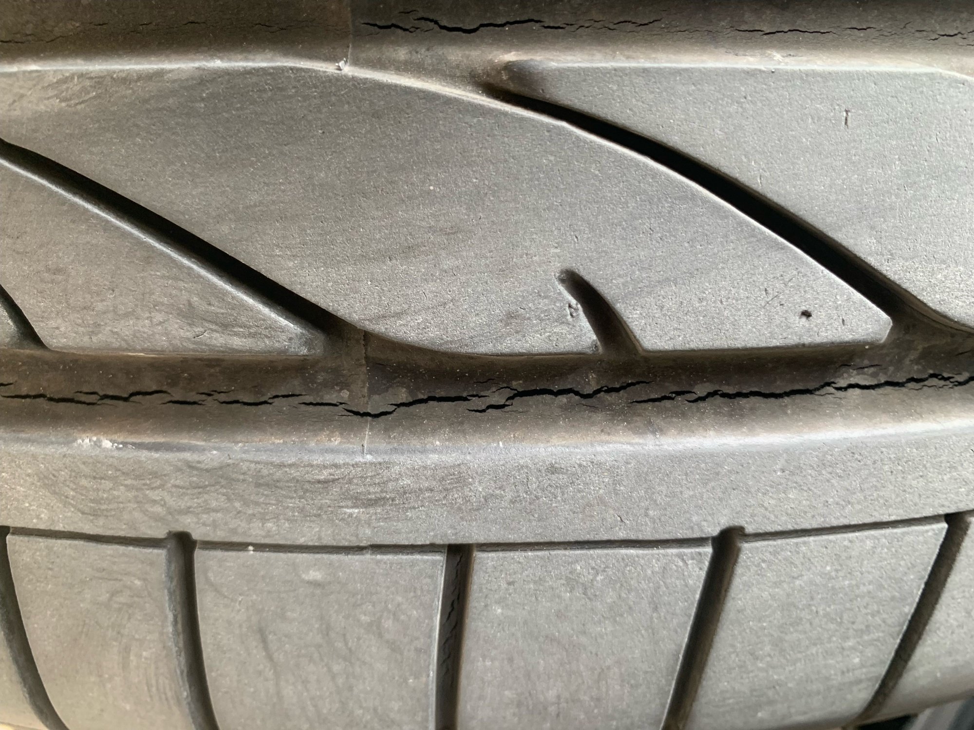

Got the hook up on a couple of space wheels from a Forum member (Thank you Jaime!)...Got the Michelin PS4's in from Tire Rack last week. Found a killer installer (Freddy @ GoMobile Tires DFW) in the DFW area to make a house call to put them on... Old 'stones' were 7 & 8 years old and were dry-rotted (Shocking...not so much!)...Gonna have to talk with the dealer about that... Really happy with how it runs and drives no... steering feels better (more precise), and a bit lighter. Does not follow the bumps, ruts or grooves. Best of all zero steering wheel vibration @ speed... Felt like I was driving with double-sided stick tape on the tires!!! Well worth the $$$ spent!!!
Thanks to @HSM Precision for the jack pads.. Worked like a CHAMP! The installer thought they were the 'cats ***'...

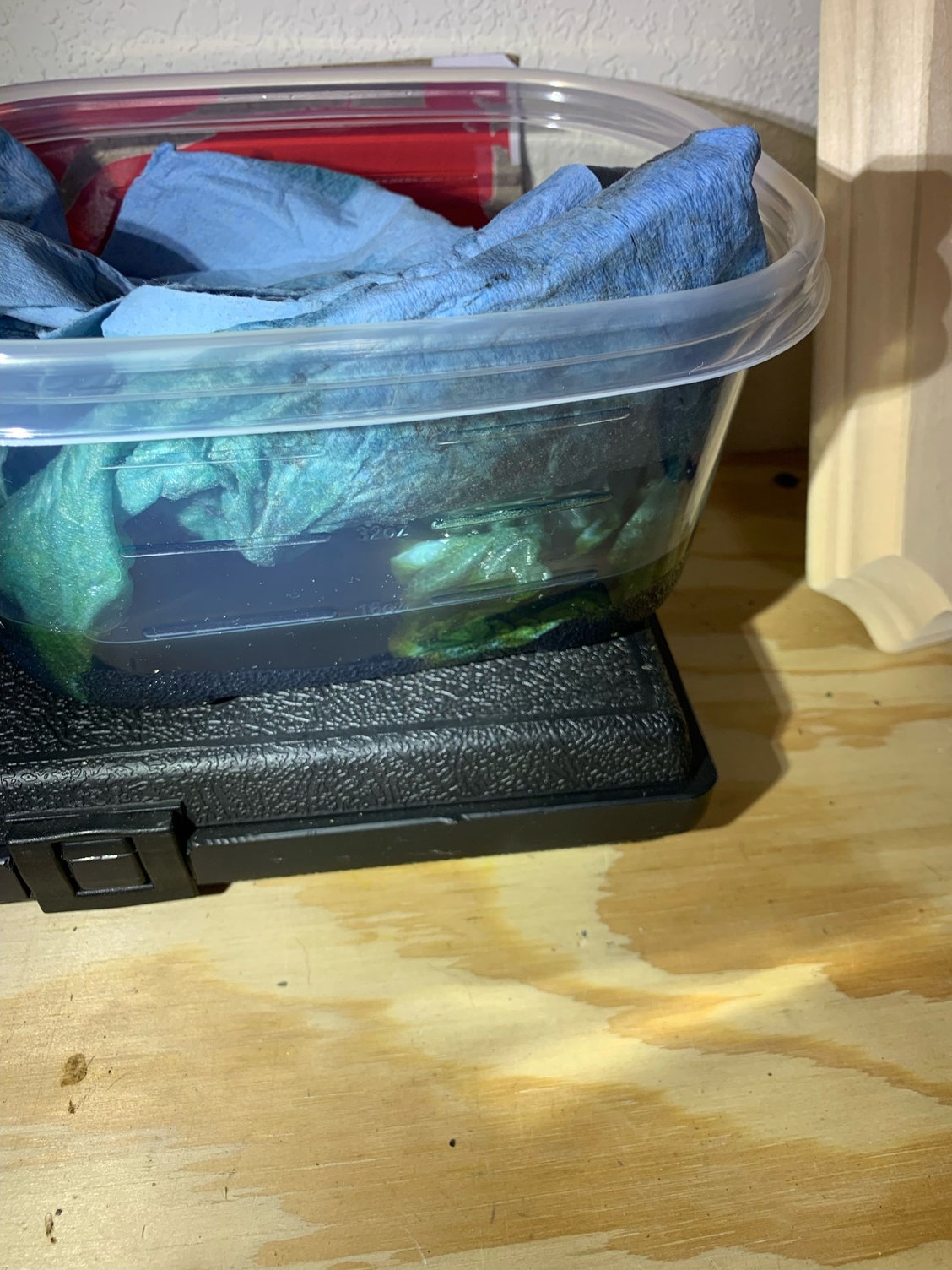

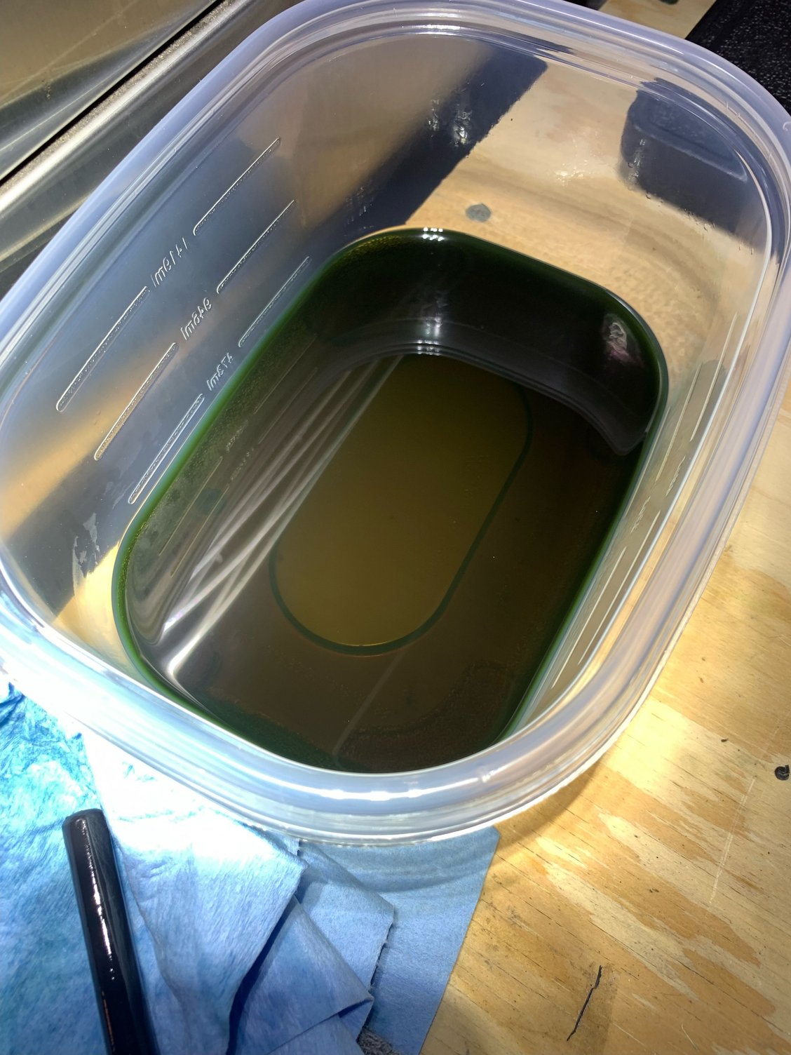

Ok, small update, and one more 'bite-in-the-a$$' today... I bought 2 liters of Pentosin CHF11 for the PS, and a tool to such it out of the reservoir. Man, what that a beating. I ran 1 liter through to flush it a tad bit at a time.. This was helpful: https://www.6speedonline.com/forums/...h-process.html
End of the process, noise was still there. Thinking it has to be the brakes... The noise seems speed-related in time with the wheel-speed...at least my thought...
There's what the fluid I took out looked like... On a blue shop rag, it appeared colorless - not dirty per se'.

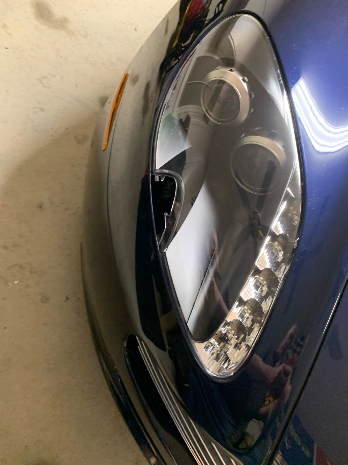

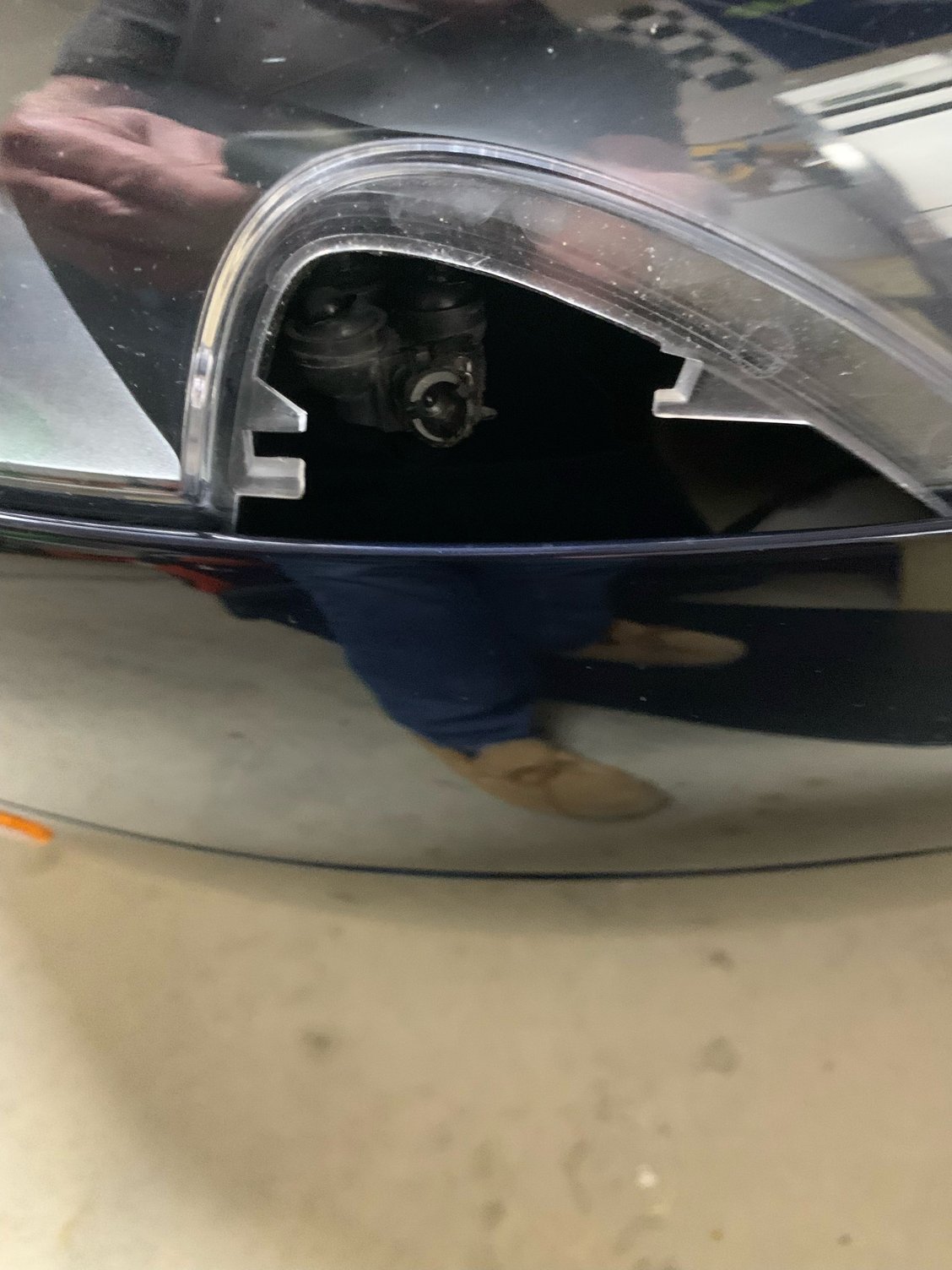

So, take it out for a drive to test my handy-work...decided to hose down the front of the car after working on it... (Yes, I have the fenders covered in plastic)... Decided to try the wipers... BAM! washers kicked in and the right side washer cover goes flying... Too busy of a road & too dark to chance it... Guess I will order one. Looks like it's a replacement part... 30 pounds in the UK, so I am guessing $60.00 in the US. Understand Jag has a cross reference for it...
Man, the hits keep coming!!!
Ugh,,, Should NOT have tried the wipers....
This is the fluid after I was about 1/2 way through the liter..
This was the first half of the fluid.

Wow... That was super handy. Did not hear or know that I needed the Lubrizol additive...

If you pull the fuse for the headlamp washer pump, no more issues, and the front of the car stays clean.
