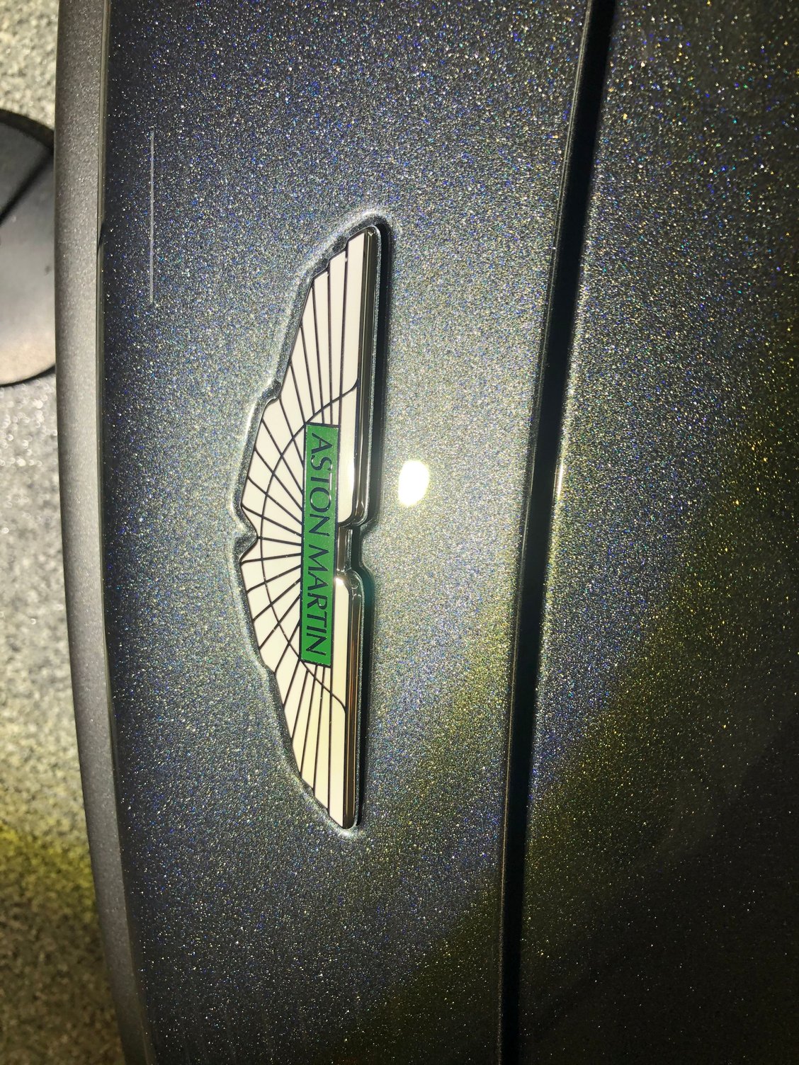

I'm not sure why you would remove the badge. My PPF has a cut out for the badge.

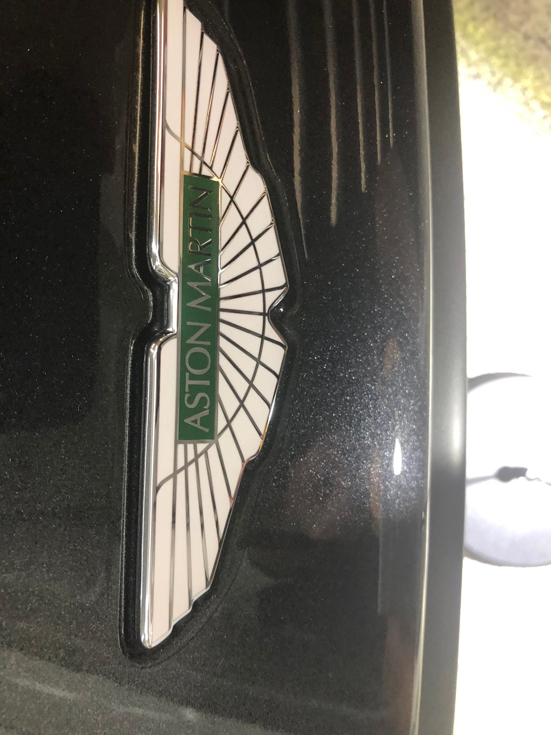

Agreed, Mine was done without removal...you cant find the cut line around the emblem. I don't like the idea of having a layer of PPF between the badge and the car. Remember, some day I believe the PPF will be removed. Personal preference I guess. Make sure the person applying the PPE is a Pro with a solid reputation !

Just had pdf ppf on my new Vantage. Emblem was left in place..
