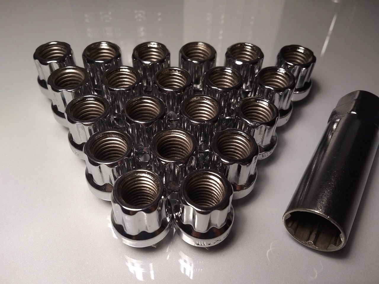

I'm trying to remove the spacers the previous owner put on my car, but it looks like I'll have to do a lot more than just unbolt things...I'm trying to figure out if I need to buy new wheel studs and lug nuts, what size to buy, and what's involved with replacing them.
Up front, the studs stick out 42mm with coarse threads. The lug nuts I have extend deeper into the wheel than the stock ones, so I'm hoping new lug nuts are all I'll need there (without the spacer, they bottom out before securing the wheel).
In the rear, it looks like the original studs were cut and the adapters secured with nuts like I've never seen before. These studs stick out 31mm with a fine thread.
How far should studs stick out from the factory (or, what length are the stock studs) front and rear ? Presumably they're all coarse threads stock? I've read that Aston sells complete hubs and not studs, but surely there are some same-spec studs that I can hammer in? With a set of 20 lug nuts running $260 from Scuderia, I'm daunted by the cost of messing with the hubs at all...

I bought a set of hubs (4G43-2B663-AD) from Aston Parts 24/7 and measured the studs.
Stud length: 65mm
Thread length to hub face: 49mm
Hub "depth": 11mm
Thread: M14x2.0

I finally managed to get rid of the rear spacers/adapters. I couldn't see any way to knock out the old studs without removing the hubs from the carrier, so I felt it made sense to simply replace them. My front studs were stock in the end, so I didn't mess with them. I couldn't find any splined drivers that fit the nuts on my car, so I had to remove them with an EZ-out. It worked pretty well.
It's straightforward, but a bit involved. I made a video of the process:
https://bit.ly/vantage-hubs

A few things worth noting:
- It's not mentioned in the manual, but you must remove the ride height sensor (for leveling the headlights) or you won't be able to get the left side axle out. I think it's one bolt.
- Be careful where you move/set your handbrake caliper, as the tube that houses the cable is weak before the bend...It's not hard to fatigue it into cracking.
- The axle bolts I received were a few mm longer than the ones I removed from the car, but they worked fine.
- If you've ever wondered why Aston lug nuts cost $5, it's because they are of high quality.
