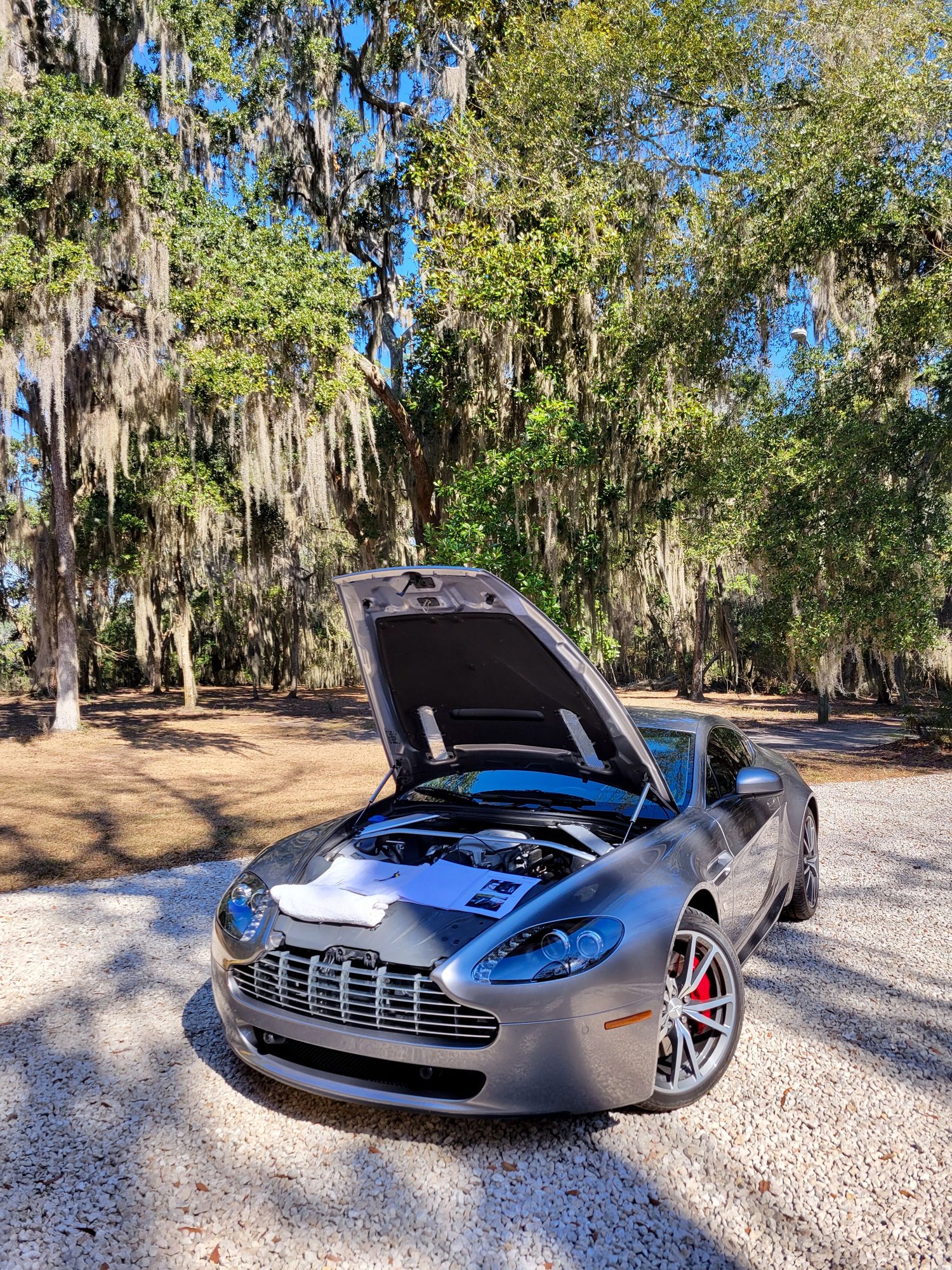

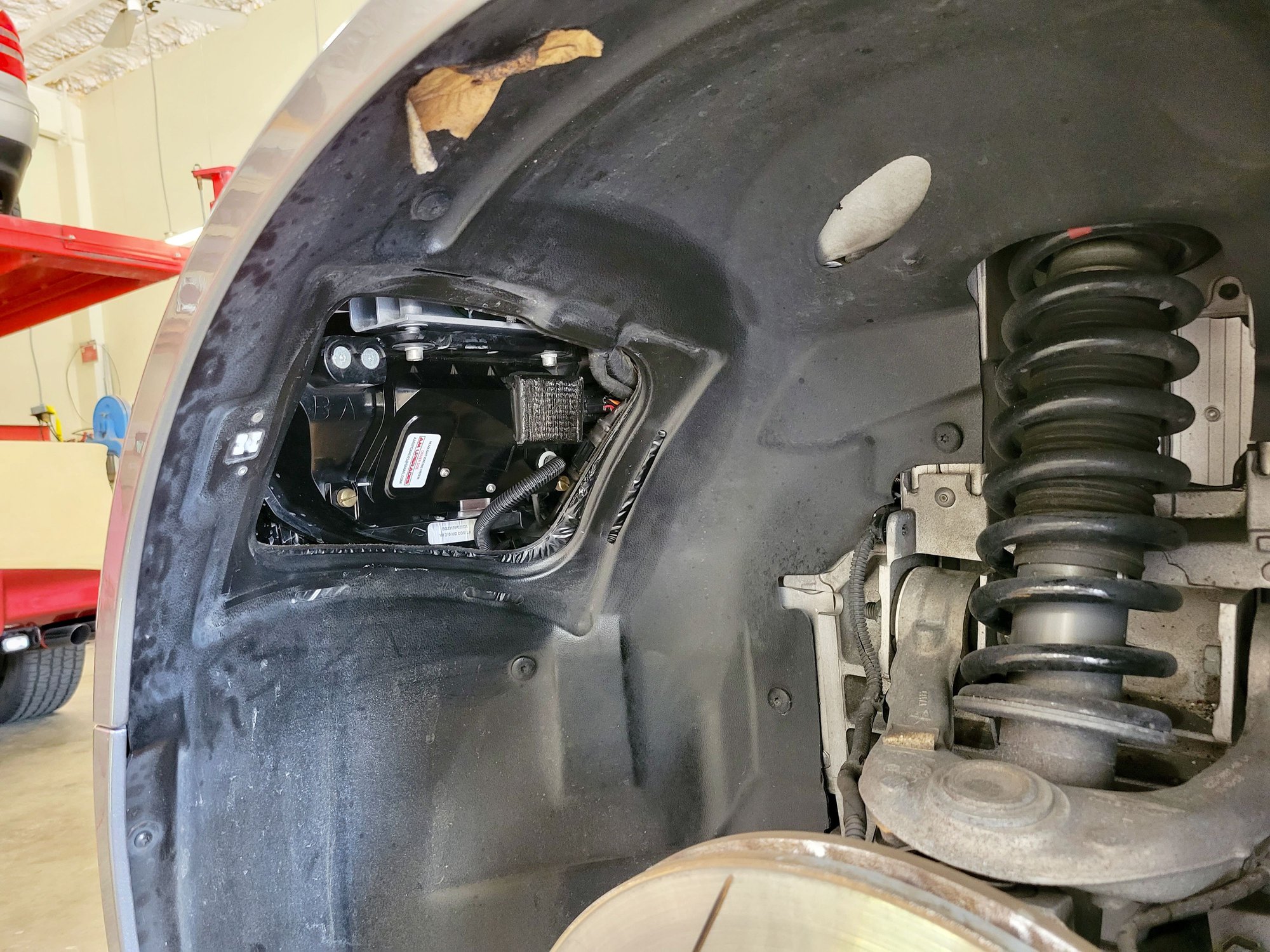

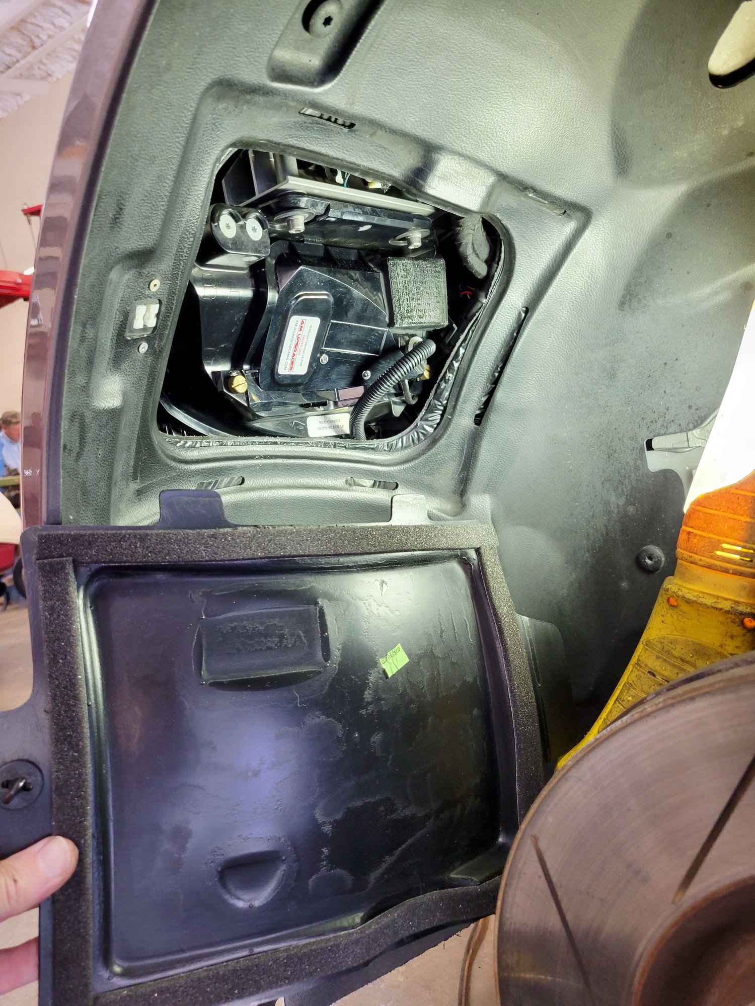

Since my Vantage was delivered just before Christmas I have been enjoying the vehicle and have put more than 1000 sunny miles on the odometer. Absolutely zero problems including the dreaded headlight condensation issue — until last week. It was particularly cold in Coastal Georgia last week and when I backed out of the heated garage and into the 35* F weather outside I noticed a very slight fogging in the most forward section of the headlights. This light fogging was only about an inch in diameter but prompted me to install the headlight ventilation kit I had purchased from Ian at AMUPGRADES. The Vantage was washed the day before so that may have precipitated the issue.
Having read that some customers had installed the kit with the wheels on I attempted to go this route. It quickly became apparent that this method was not going to work as there was just not enough room to maneuver. With the wheels removed the installation was quite easy and literally took less than an hour total.
The headlight ventilation kit was very easy to install with superb installation instructions and pictures. Each component of the kit was individually packaged and labeled for easy identification. Once installed I started the Vantage until the engine was at normal operating temperature and then shut it off. I then listened to the headlights and I could hear the small fans whirring away as they removed any residual moisture. Although I did not time it I believe the fans ran for about an hour after the engine was shut off. I now have piece of mind that the headlights that cost $5400.00 each will be kept nice and dry.
Below are a few pictures. The Vantage ready for the ‘operation’, the new AMUPGRADES headlight cover with built in fan and condensation exhaust hose, and the wheel well cover ready to be reinstalled with new foam gasket.
If you have not done this I highly recommend that you do. It will keep your expensive headlights clear and benefit you if and when you decide to sell.

This is a great post Rob! Glad to see that it worked. I was thinking about ordering this after you had mentioned it. I'm assuming that the fans run while the car is driving and stays on for an hour after the car is shut off?
Ive been doing the high beam method LOL! The LEDs are not hot enough for the moisture so the high beams took care of that.
Old Mar 1, 2021 | 01:48 PM
MAUMAU's Avatar
Joined: Sep 2020
Posts: 222
From: Coastal Georgia and Coastal Maine
MAUMAU is infamous around these parts
Ahoy Andrew -
You are 100% correct. The Headlight Ventilation system is activated when it senses that the radiator hose is above 50* C (122* F) and will continue to run while you are driving. Once you shut the car off, the system will continue to run until the radiator hose temperature is below 50* C. Today with 75* F here in Coastal Georgia the fans ran for about an hour after I returned home. The two fans use a minuscule amount of power (.09 amps) and will not drain the battery.
If one lives in a colder or more moist environment you can also order a separate and easy to connect module that will allow you to specify how long the ventilation system will run.
