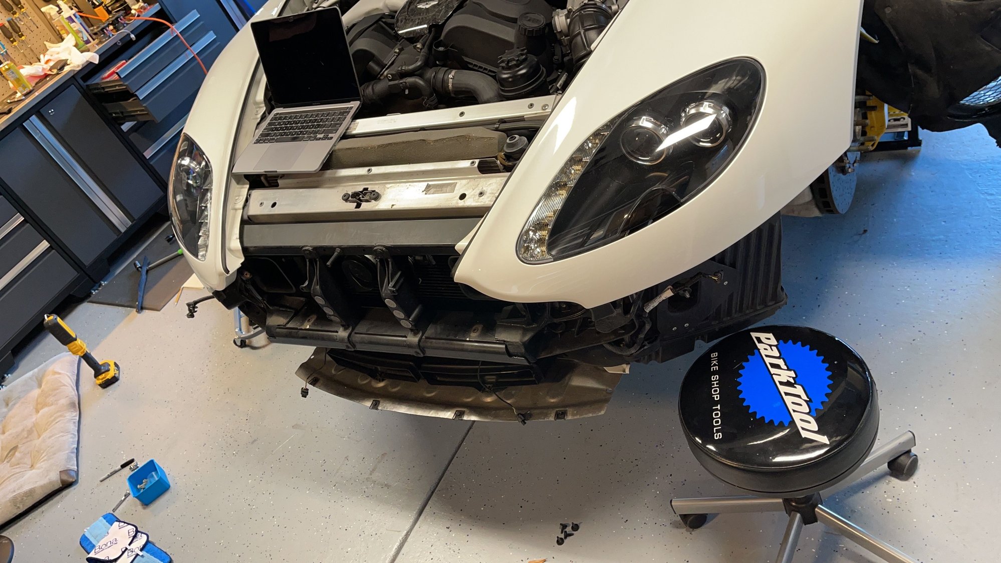

Once again I come before the brain trust, desperate for help.
The carbon front splitter on my 2015 V12VS is, well, split. I won't get into the details of how as it pains me to recount the terrible sound it made, but I am in need of some help. I have a new splitter showing up tomorrow from ECPS group and am quite set on trying to save a few (hundred) dollars by doing the install myself. In looking at the mounting setup on Scuderia, I can see a bolt that secures the two peaks of the unit to the frame, however I cannot for the life of me figure out how to access said bolts. I have the shop manual for the car, but I can't seem to find the process in the menus.
Any tips, tricks, or blunt realizations would be greatly appreciated.

You will need to drop your inner fenders and remove the air filters. Then you will be able to reach up and get at that bolt. It's tight squeeze.

I managed to figure it out after somehow stumbling into the correct section in the shop manual. For anyone who is wondering:
1) Remove both front wheels
2) Remove wheel liners (I did not pay proper attention to where the lift went and inadvertently blocked one bolt on each liner, forcing me to pull them aside).
3) Unbolt air boxes on each side (3 screws)
4) Remove three screws on each side securing bumper liner to upper panel.
5) Remove two screws that secure upper grill to bottom of fender.
6) Carefully pull away cover from final two clips. Have a second person hold as you disconnect the 4 front parking sensors.
7) Take a step back and pray you remember which screws/bolts go to which step.
8) Reassure yourself it will all go back together just fine, unlike every other project before.

Best of luck! If I can offer one bit of advice, it would be to have two people there to remove the cover and then to put it back on. The piece is actually quite flimsy so if you try to pull it off by your self, it will start bending and bowing out of control. If you don't have the 2013 shop manual, let me know and I'll tell you where to get it. I couldn't have done it without it!

There is no need to remove your front bumper to remove your front splitter. As long as you remove the fender liners and remove the air filters, you can reach up and get the upper bolt on the splitter. Removing the front bumper may make it easier, but a lot more work.

Your welcome. The top bolt is a tight squeeze for your hand, but it's better than dealing with electrical wiring and possible damage to the bumper cover.
