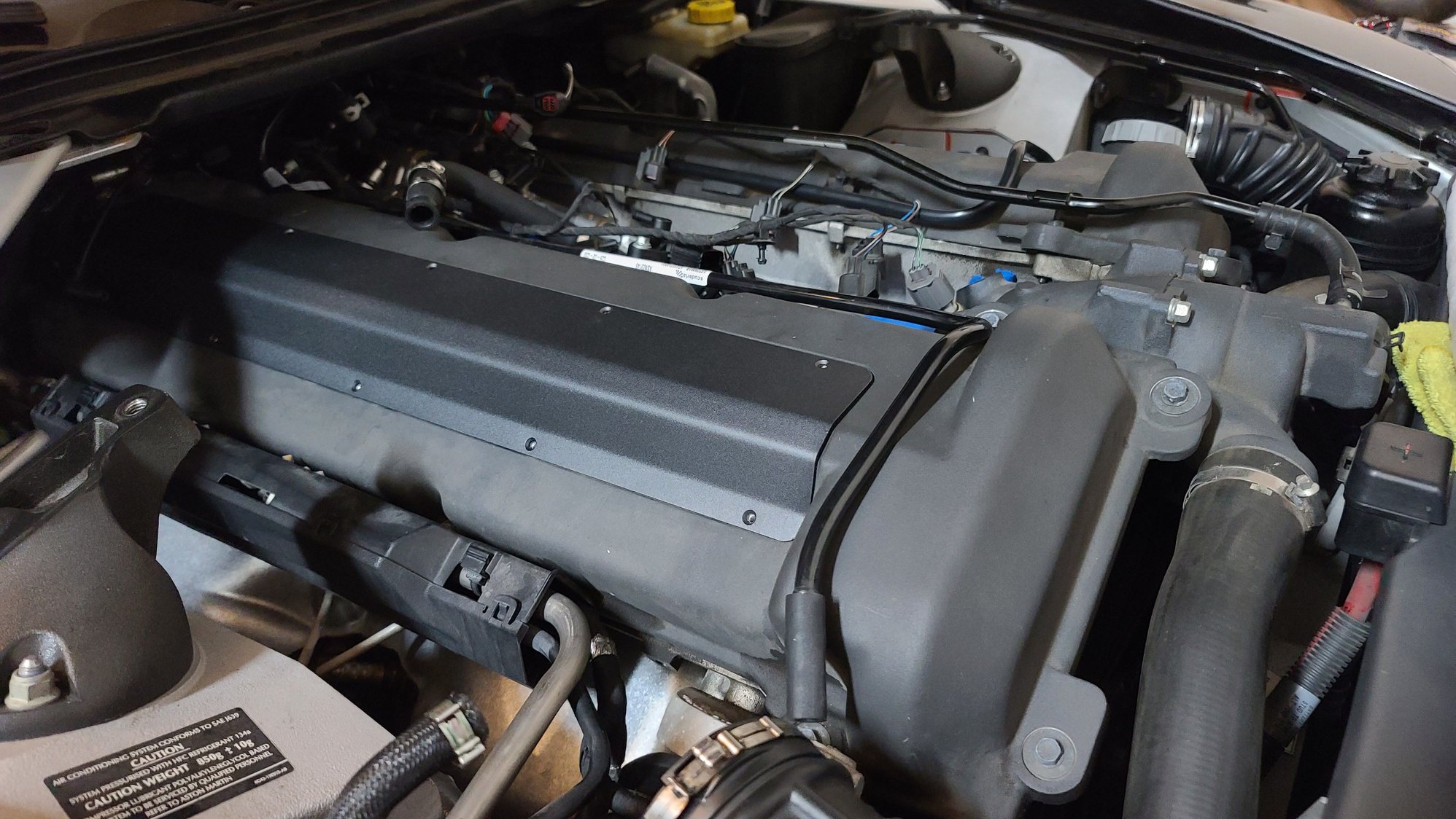

FWIW, I had the valley cover and the braces powder coated. Cost me about $150.00. Thought about the rest of the motor and stopped while I was "behind". They probably would look nicer in a a good matte black.

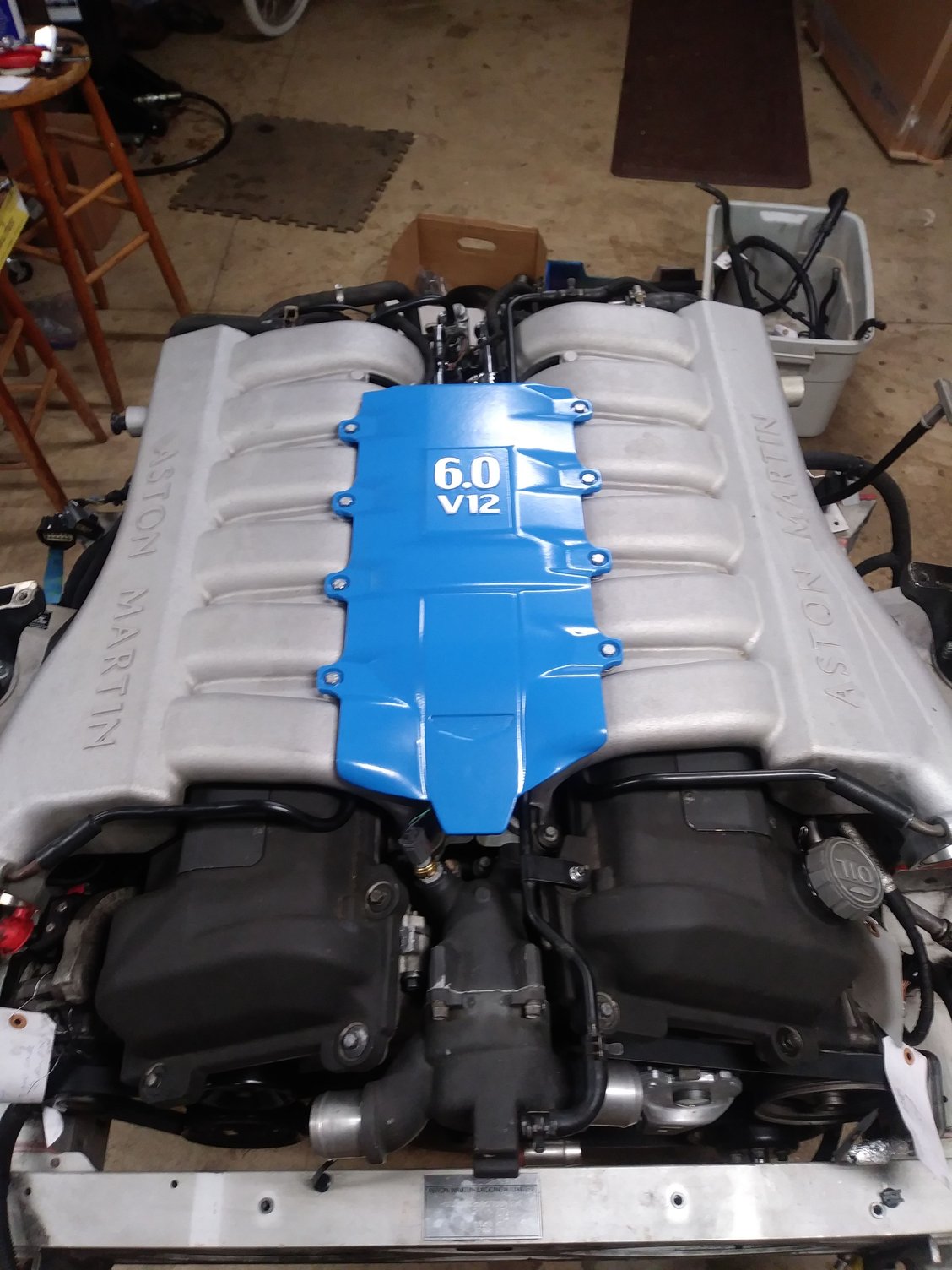

Wall art from a Vanquish, truck bed liner from a can. $8 holds up well even in hot temps.
