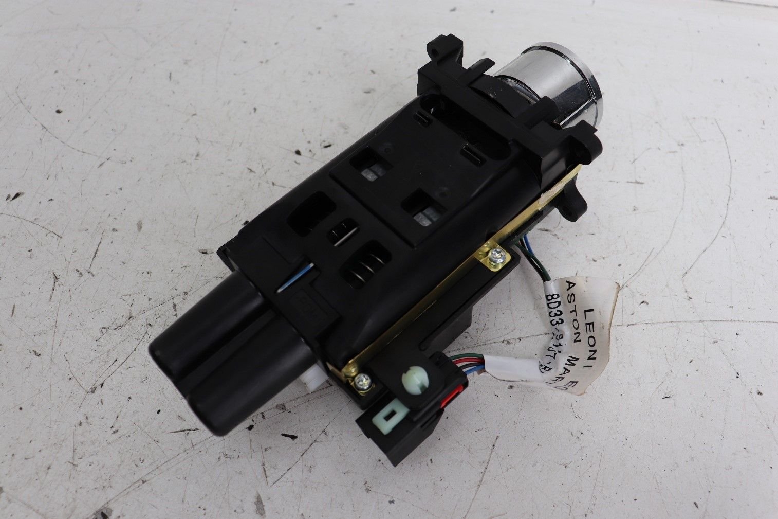

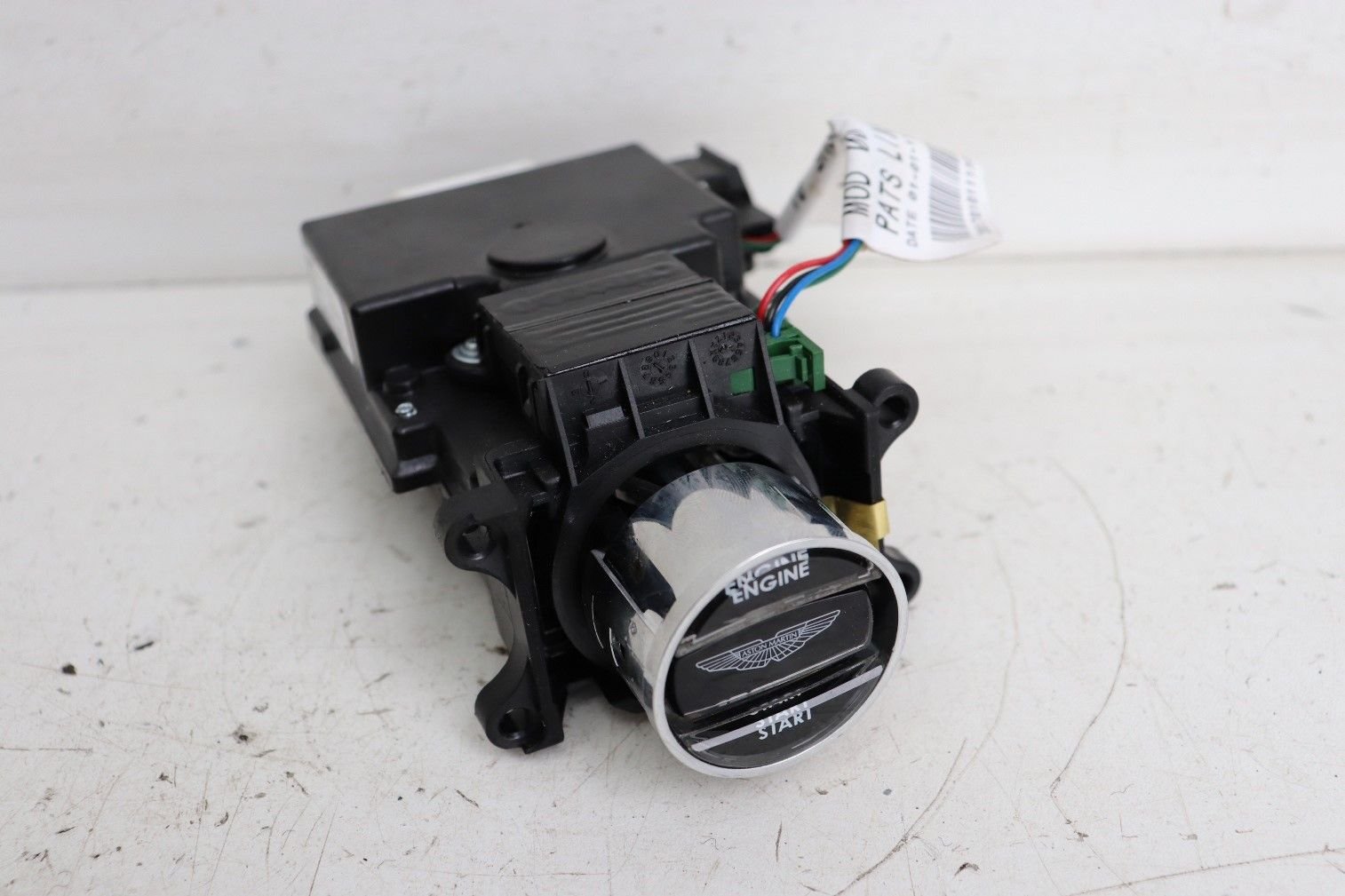

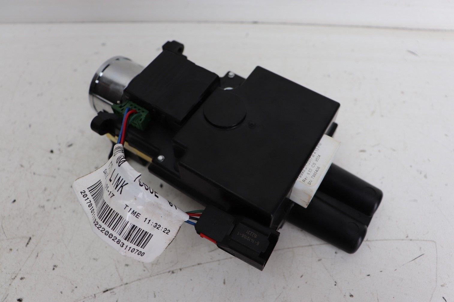

Resurrecting since I have the same symptoms. I can get a good start 100% of the time by slowly inserting the key, pushing with two fingers. It's 50/50 on the first try if I push down quickly. The dealer, and another thread here by Irish, say it's a sign the ignition module is on the way out. Dealer quoted $1717 for the part and $500 labor, which I understand requires re-flashing each key -- so it can't be done without AMDS. I'll get it fixed if it gets worse, but it seems ok for now. It's probably an internal antenna wire out of alignment and something an electrical engineer could figure out and fix, if such a person could be found.

Your comment sent me down a rabbit hole on Volvo forums. Volvo has multiple key systems, but one of them is quite similar: shove the same key into a dash receptacle, push a (separate) button to start. Volvo calls it the "Start Control Unit" so I can see where someone at Aston thought "let's rename that 'Emotional Control Unit.'" Volvo owners don't like paying $1k to fix a $165 part either.
Anyhow, that brought me to an active ebay listing, $600 for a used ignition module that had some great pics. The AM ignition module is multiple parts screwed together. It's sold as one, but I'm just wondering if the part that's actually worn down or misaligned could be patched up without rekeying. You're right, though, that the Volvo guys haven't solved it.
