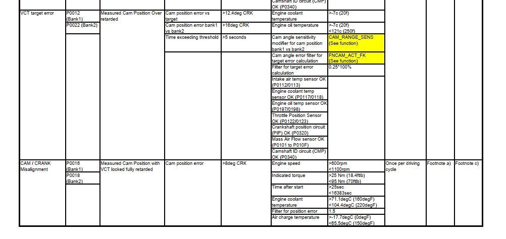

Originally Posted by hsm precision
I searched for the P0016/p0018, and they show a slightly different description than you have, which may be important. (this is from the 4.7 OBD section of the service manual. If it actually is a bank 1 and bank 2 error, that would point to a more systemic issue than if only bank 1.
If you don't have it, here are links to the service manuals:
https://www.dropbox.com/sh/0f7dheyz6...FlMAKpMBa?dl=0
If it really is systemic to both sides of the engine, would the crank position sensor be the common factor?
Or, as you mention, variable valve timing control.
Matt
Matt,
Thank you kindly for that Dropbox link since I did not have access to any of that! I just read through a bit of it in terms of the codes and descriptions, and I also came across it mentioning the P0022 being thrown by VCT irregularities. Do you think it would be from the VVT solenoids or potentially the entire unit? I can’t seem to find any crankshaft sensors for the vantage v8, would it be monitored by the crankshaft sprocket (page 873 of workshop manual)? Sorry can’t screenshot it as I’m viewing it from my phone. If I go for the camshaft sensors would I be looking at: 6G43-03-10048? Once I can get to a better scanner to datalog cam angles I can see if the cam gear/wheels behind the cams are off.
Thank you,
Ken
