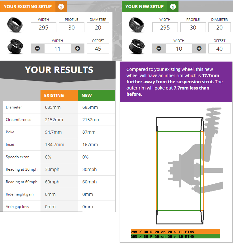

I run 20x9 +35 in the front and 20x11 +45 in the rear and is maximum flush without any scraping.
20x9 +35 and 20x11 +45 HRE wheels
Given my dimensions, your posted setup will fit with 295 tires in the rear.

Appreciate you looking into this for me. So if I do decide to order you suggest to do a 20x9 with a +35 upfront instead of doing a +40? That’s a very nice set up you got there. Now for the rears it only gives me a 40 offset unlike the 45 you have. Basing it off the picture you sent me the +40 offset will work once it’s a 295? The car will also be slightly lowered.
you can play around here.
https://www.willtheyfit.com/
Just keep in mind that my setup is maximum fit without impact on dynamics. I still can corner hard without scraping.
