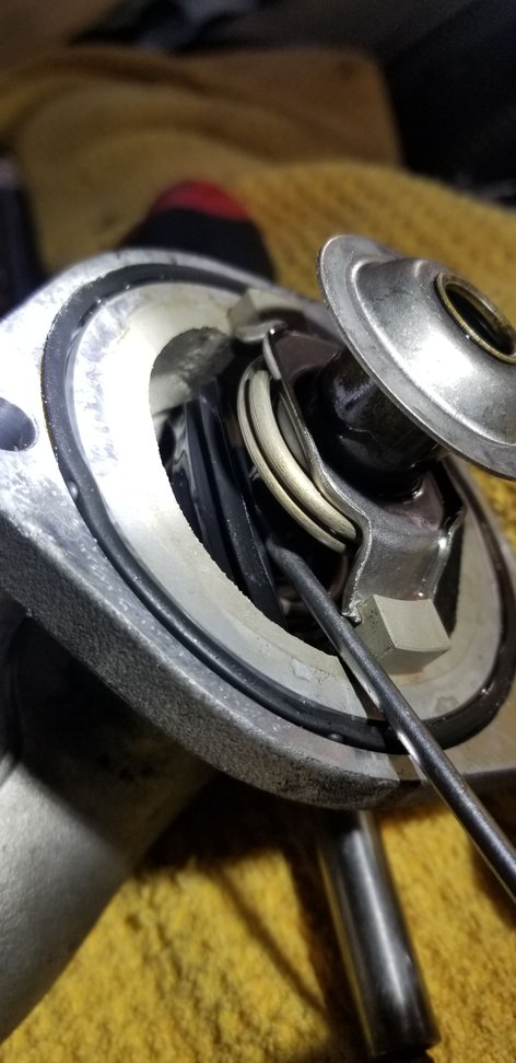

you need a new thermostat for sure. but i wouldn't make ANY drastic decisions WRT the engine until i found out what the material was in the oil FILTER. if i understood your post, that first picture is not the oil pan, but the catch-pan you used to catch the oil. and the oil in it was inside your oil filter. it might just be timing chain tensioner material and nothing more. it's encouraging that there was nothing being attracted to the magnet in your oil pan.

I received the 2 email reports from Blackstone today for the oil and filter pleats. Both samples do not raise any concerns for them.
As they suggest I'll follow up with another set of samples next change cycle.
Oil Report:
" LANCE: Thanks for the note. As we said in the filter report, there wasn't enough metal present to suggest a
mechanical problem, and the results of the oil analysis bring the same conclusion. For reference, universal
averages for the AM 4.7L V-8 are based on oil run for about 5,600 miles. Metals in your sample are all low
by comparison, and from what we're seeing it looks to be in excellent internal shape. There's no significant
fuel dilution, and good air and oil filtration kept silicon (often dirt) and insolubles (oxidized solids) low. The
viscosity was correct for a 10W/60. Nice engine."
Filter Pleats:
" Findings: A section of 13 precut pleats were submitted for evaluation. A small
amount (less than 1 piece per pleat) of aluminum was found, identified by
reaction with hydrochloric acid. The biggest piece was a sliver 0.046” long,
shown in Picture 1. Smaller aluminum particles are shown in Pictures 2 & 3. A
few pieces of carbon were also found, like that shown in Picture 4. The filter also
contained some yellow flakes, likely paint (see Pictures 5 & 6). No significant
amount of steel was found, nor did we find any brass/bronze particles. "
A load off my mind for when the weather turns and I can get this car back out on the road.
Thank you to everyone that gave me feedback on this posting.
I'll be monitoring the oil from all my engines to see if any of them show the same sparkly bits in oil from the filter. for reference :-)
