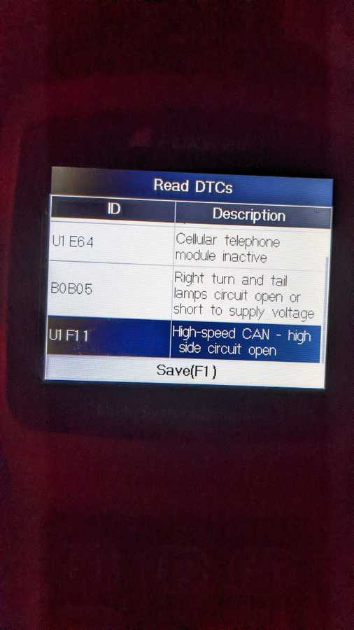

Interestingly There was a check engine light and a new error message, the infamous check emissions system. When I plugged in the Foxwell no new codes were noticed same old codes.

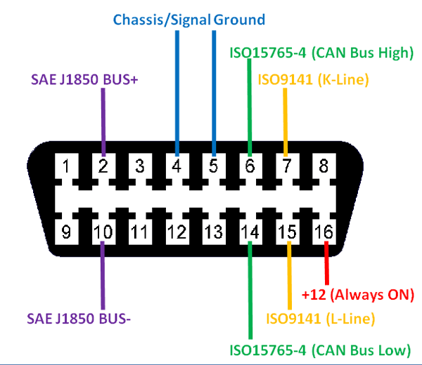

The 'high speed can open' error code seems to be telling to me. You may have an issue with a damaged module somewhere which is messing with your canbus network. On your Body OBD port, measure the resistance between pins 6 & 14 (these are the pins from the '11MY wiring diagram at least), these are your high speed can high and low side connections. They should read ~60 ohms (40 if there are 3 branches, but I'm not positive). If it's anything significantly different, you have a module that's broken or loose. From there it's finding the module that's causing the problems, which is basically a game of disconnect and check where you disconnect each module on the network, one at a time, and see if the problems go away.

which pins exactly are you referring to

Pins 6 & 14 are the ones you're looking for on the body OBD port.
