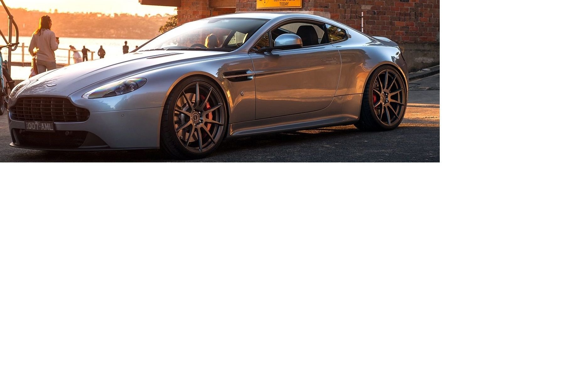

I honestly wanted black since I have silver and the contrast is perfect, but black wheels are very difficult to see the details. That's why a dark rubbed bronze would give similar contrast but the details are shown. Especially for expensive wheels.
I have not installed H&R springs yet, but I hear good things. I talked with the company R&D team and they stated that those springs were designed with Astons OEM dampers and struts in mind. I agree they are the best bang for the buck.
Here an example of tungsten silver with bronze wheels.

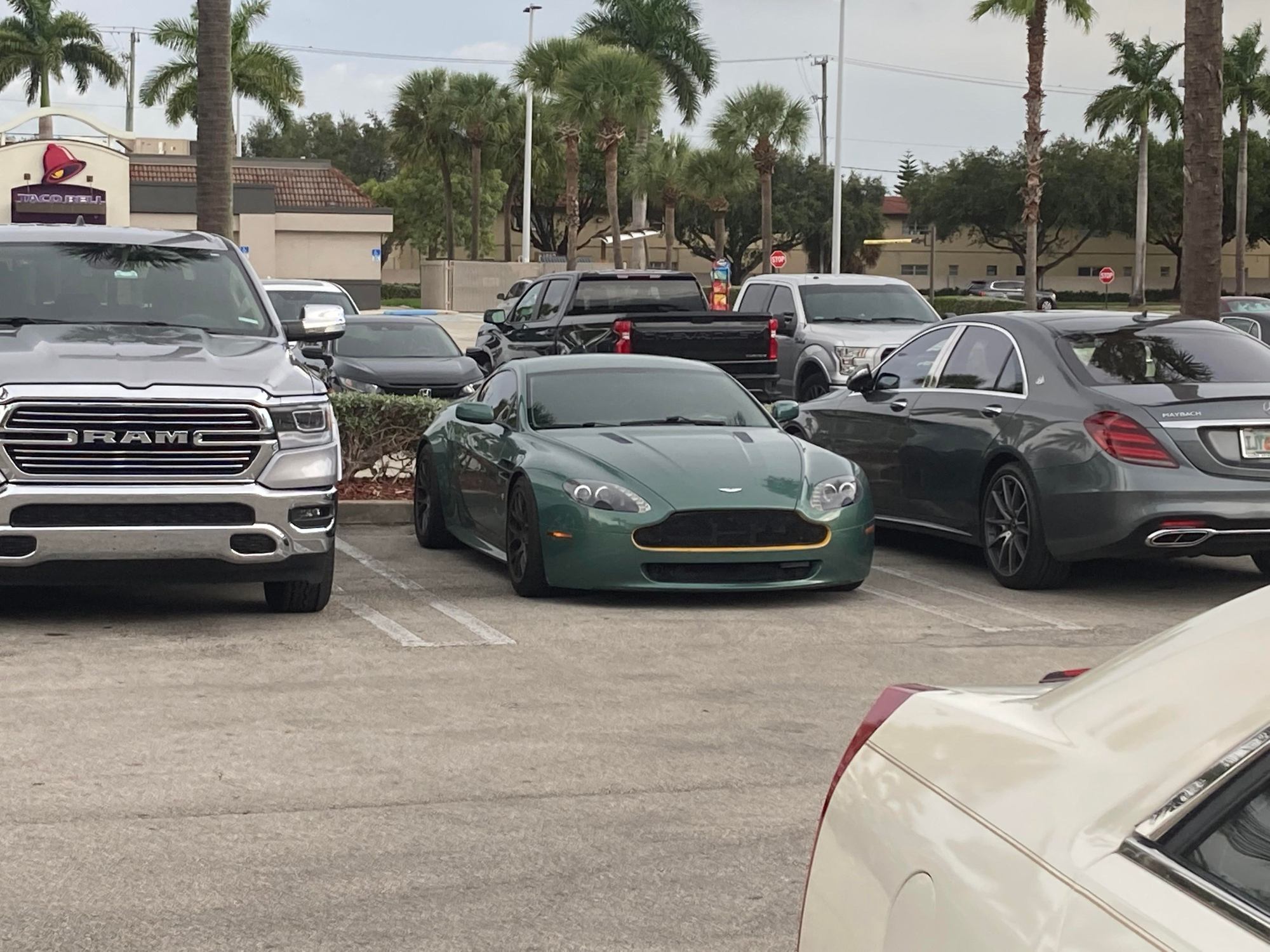

Yes but I haven't been very active, I don't think I get notices of events. I'm John McLean and my 13 Vantage is black
Hey John! Yes we did the F1 Aston Martin release party at the DC location together and we met at the bagel shop where I heard your 13 vantage with X-Pipe. Hope to meet up more this year. Lots of events I am planning so stay tuned. Click to get notifications or frequently check the group for event information.

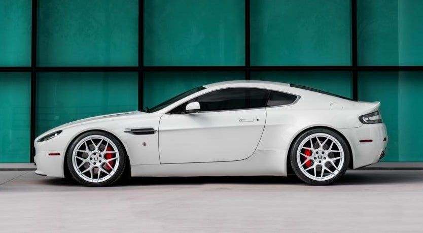

I love the HRE as well but I am leaning towards going forged over flow form. For the price and performance APEX is one of the best. HRE forged can get a little out of hand.
Heres an example of FF01 but imagine bronze

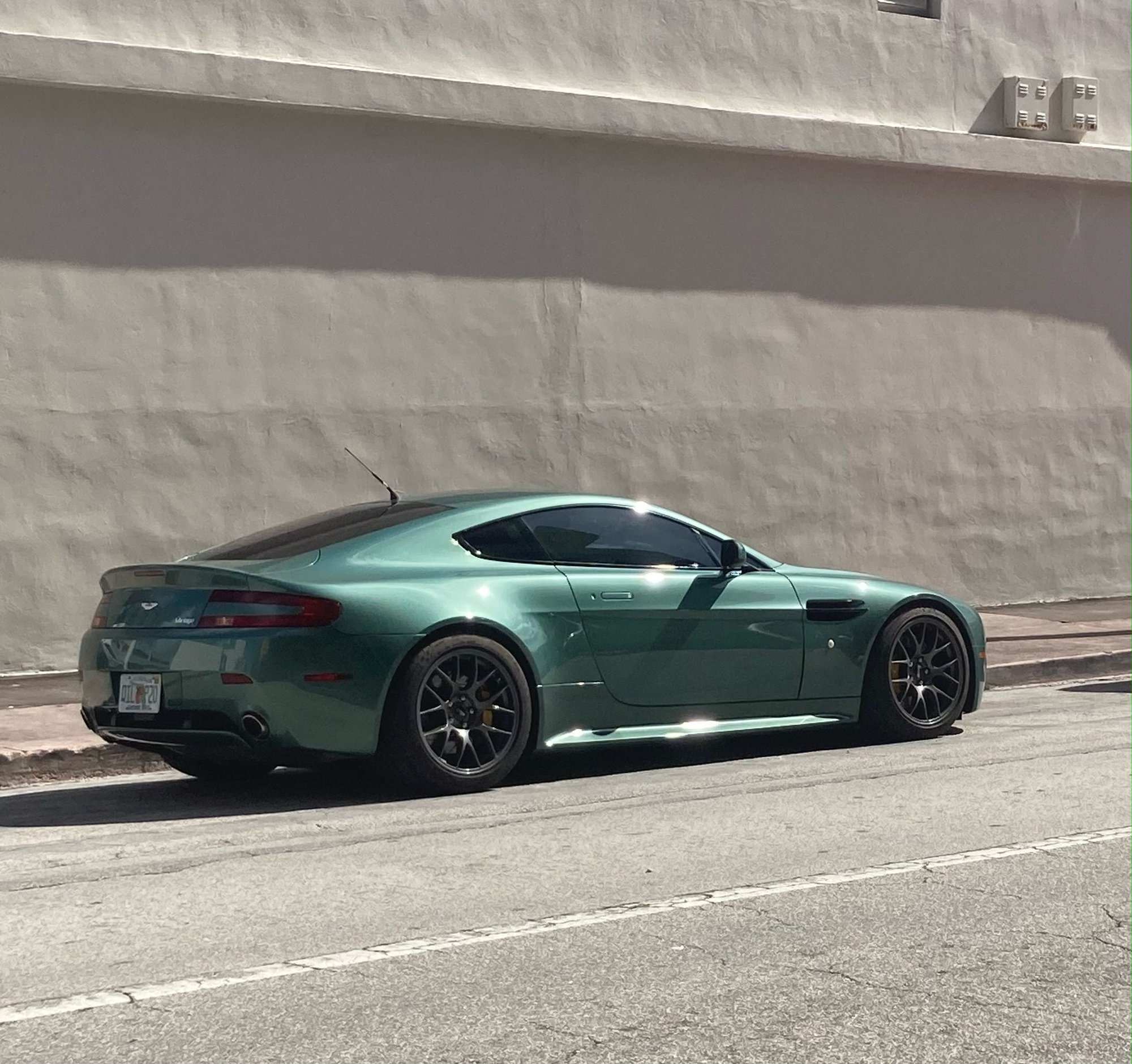

Thanks! Yeah the EC-7RS wasn't available when I got mine, the regular EC-7 is still fairly light, especially in 18 inch size, but I definitely would have gone forged if it was available at the time. And you really can't beat the price for a wheel of this quality. I like the design especially for the v8 vantage because it's almost an exact copy of the BBS wheels that the Vantage GT2s ran (although those were center-lock of course). So the design works really well.
Apex obviously is more limited with the fitments but one of their options was almost exactly what I wanted so it worked out:
Rear: 18x11 ET52
Front: 18x9.5 ET 38
Don't have a good front profile to show exact offset but here's a 3/4 view of mine (although wheels are dirty, full of brake dust here):
As it turns out, this comes out to be very close to the set up on the N24 and GT4 cars, just a few mm off front and rear, which was exactly what I was going for. The pictures above are as you see the offsets I gave, but because I am a little ****, after taking those pictures I put 4mm spacers on the rears to make it exactly the same offset of the GT4/N24 cars. The difference is so small that it makes almost no difference visually, I could have left it with no spacers at all and I would have been fine. I don't have any pictures with the spacers on, but you can search pictures of the GT4 and N24 cars.
I could have gone 18 or 19 inch, but I like the look of the 18 inch wheels because that's what the N24 and GT4 cars have. That, with meatier tires, gives it a more motorsport look in my opinion. But Ali Robertson has 19 inch EC-7 wheels on his blue v8 vantage, with what I believe are the same offsets, and it looks great. For some reason I can't easily find photos of it on google but you may have seen it. If not I have them somewhere on my desktop (saved for inspiration lol) that I can send to you.
Tires are Micheline Pilot Super Sport XL, 295/35 rear and 255/40 front. I don't recall the exact diameter, but with the taller profile, I believe the diameter ends up being slightly smaller than the v8 vantage stock tires (on a 4.3 at least), but it's very slightly larger than the diameter of a V12 Vantage stock tires. So pretty much in the range of the OEM tire diameter.
I have BC coilovers with Swift springs that I purchased from Rich at Redpants. It's fairly aggressive low set up so I have to be careful over speedbumps, but it's not my daily driver so it doesn't inconvenience me too much.
