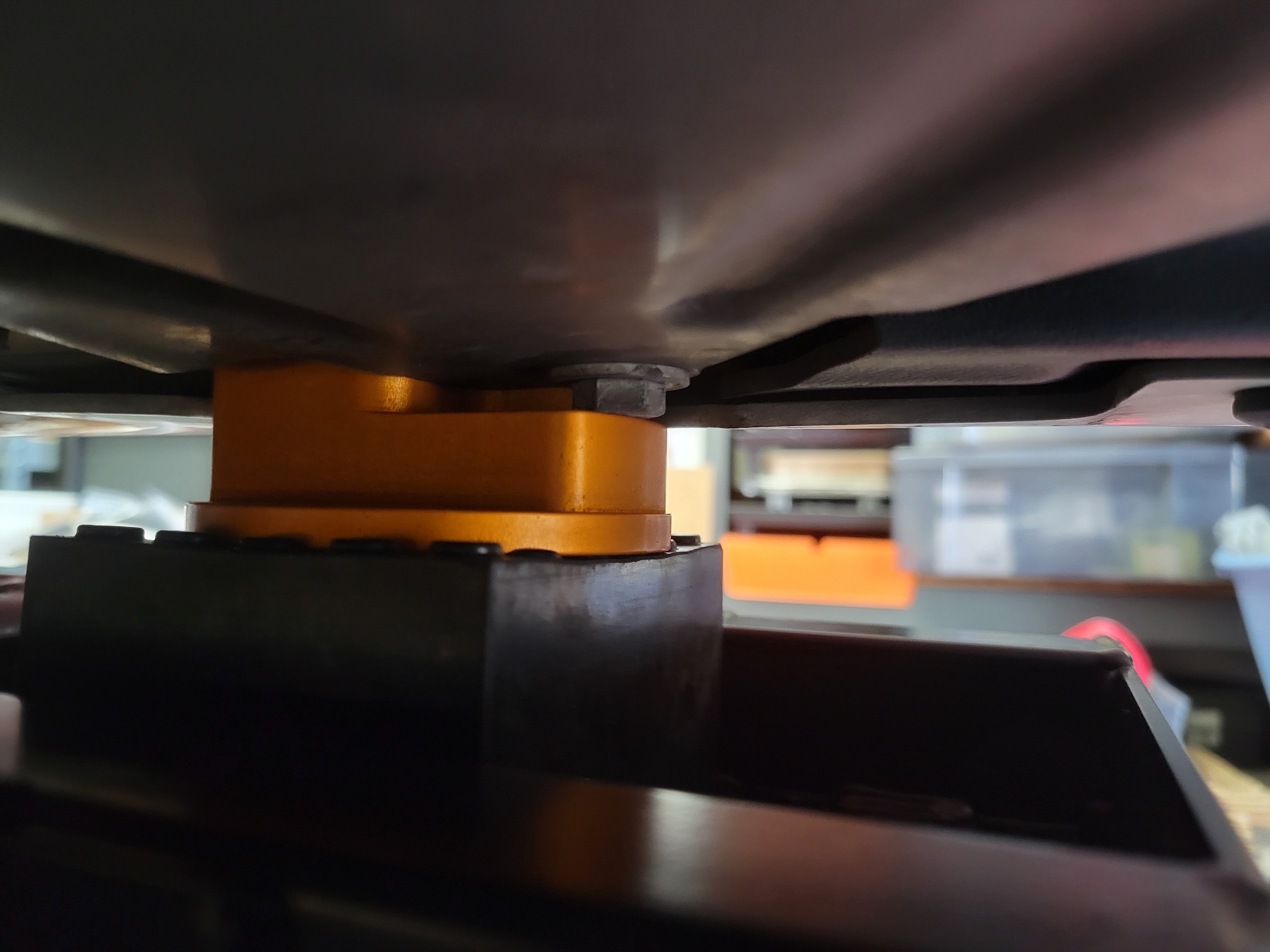

You can lift with just the rubber blocks that come with the Quickjack, but it's a bit finicky getting the placement just right. I use the rubber blocks together with the HSM jack pads and it makes it a lot easier.
The Quickjack doesn't lift straight up -- there's some horizontal travel as it rises. The jack pads shorten the gap a bit and give you a target that's easier to see because they stay in place after you insert them. Plus there's no risk of crushing your sills if you misjudge.

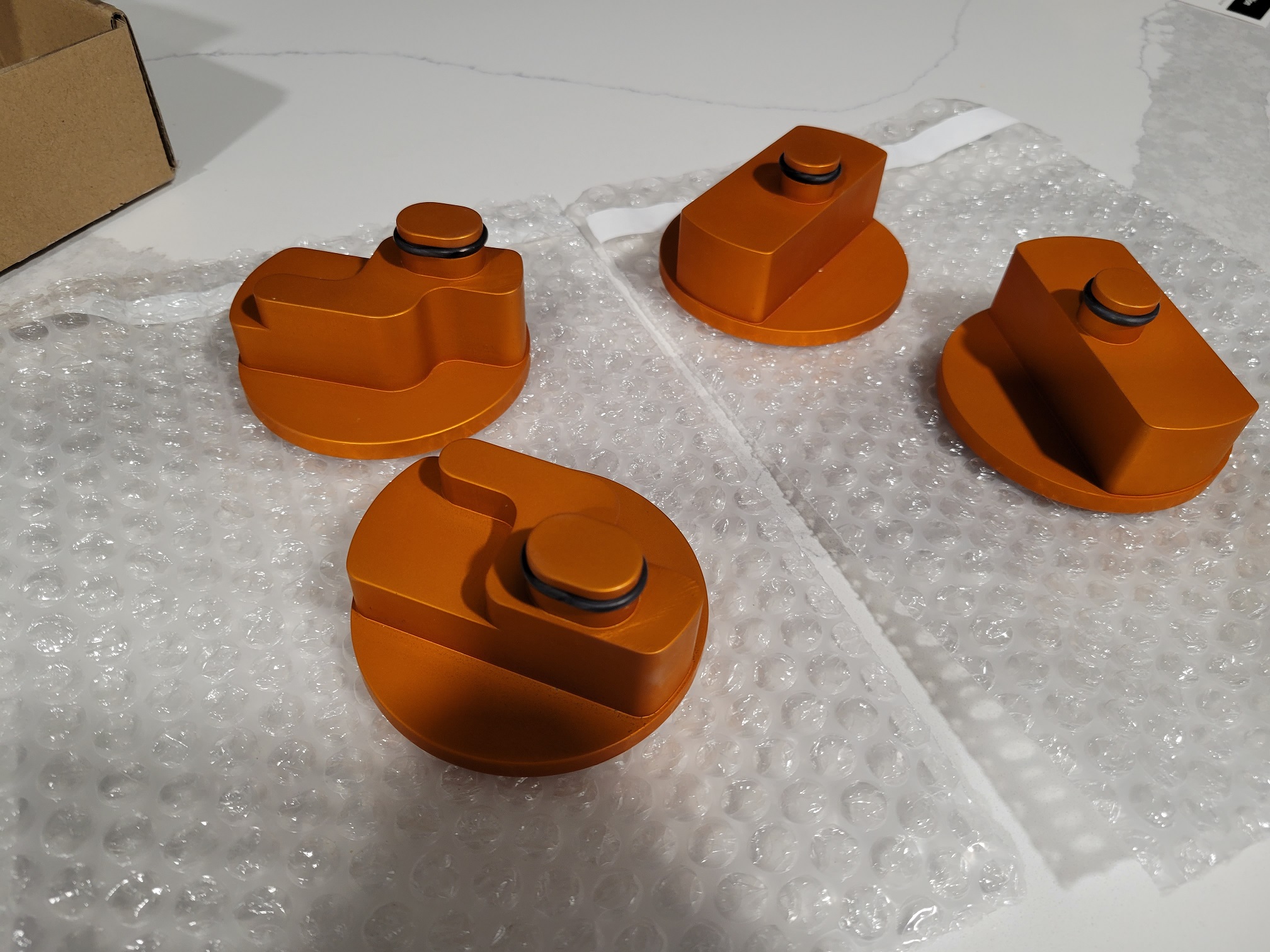

The need for the pads really depends on which vehicle you have. The DB9, and oldest V8 vantages have fairly open jack contact areas where a puck can definitely be used (I used a rubber BMW adapter before I started making aluminum ones). The later V8 Vantages (and -s), Roadsters and V12s have very complex shaped jack points, with undertrays and and bolts in the way. These are much more risky to lift with a rubber pad.
As mentioned above, the aluminum pads are designed to hold in place on the jack points, and then you can bring the jack to the point, instead of targeting the area by feel. They are certainly a luxury, but make lifting the vehicle much less fiddly. The other advantage of course is if handed to someone else doing service, they will lift from the correct safest points, and not risk damage by lifting from the wrong area.

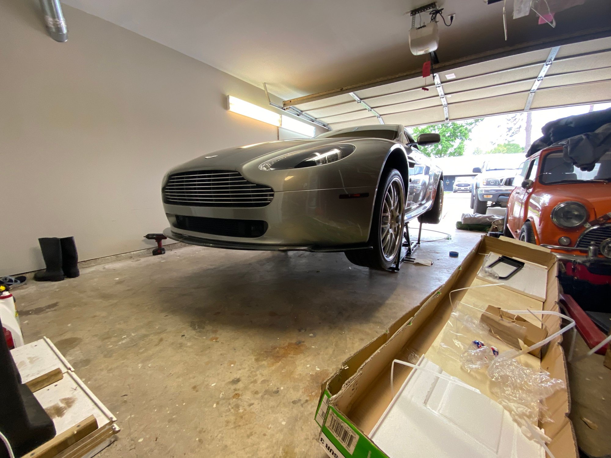

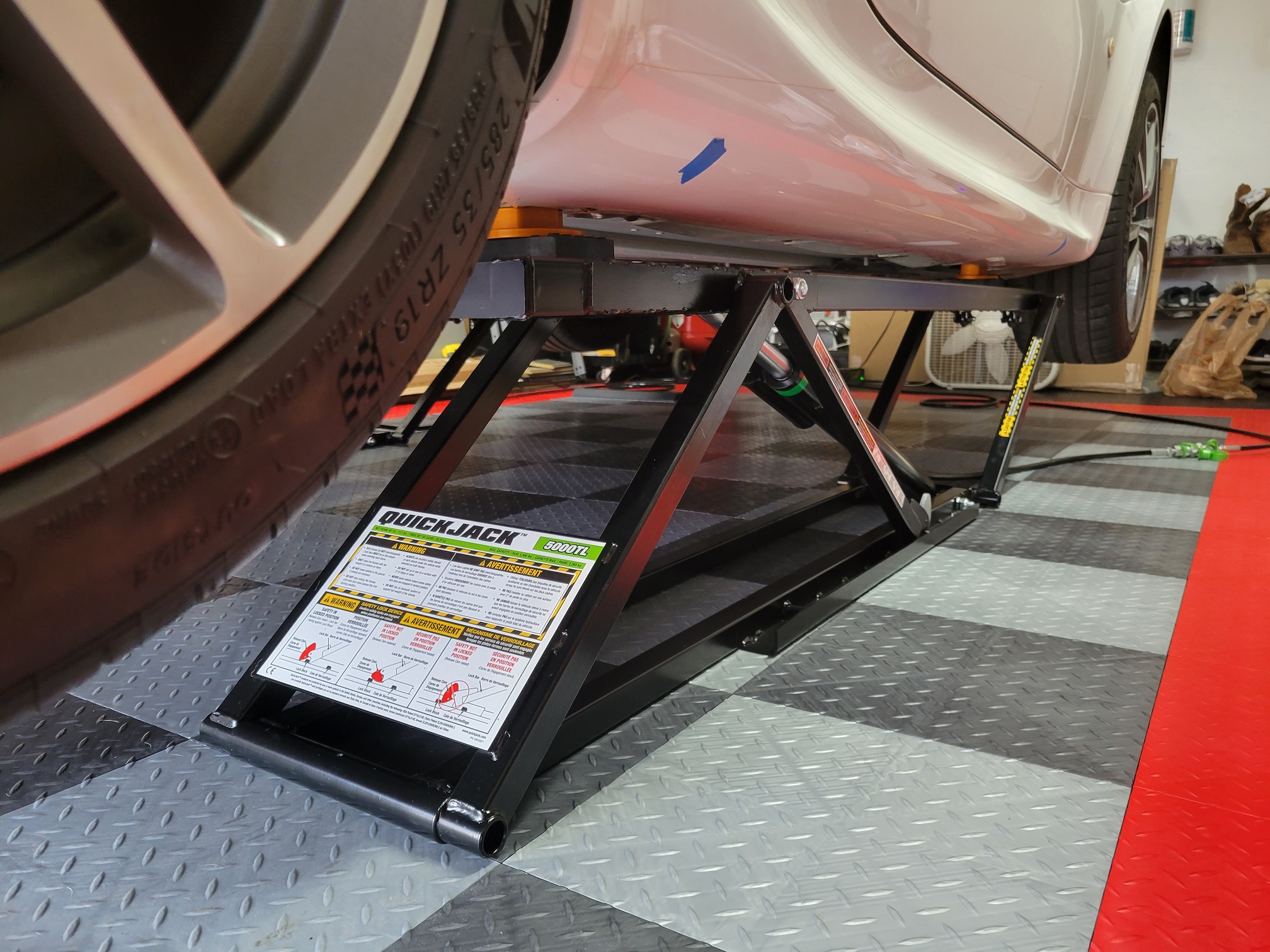

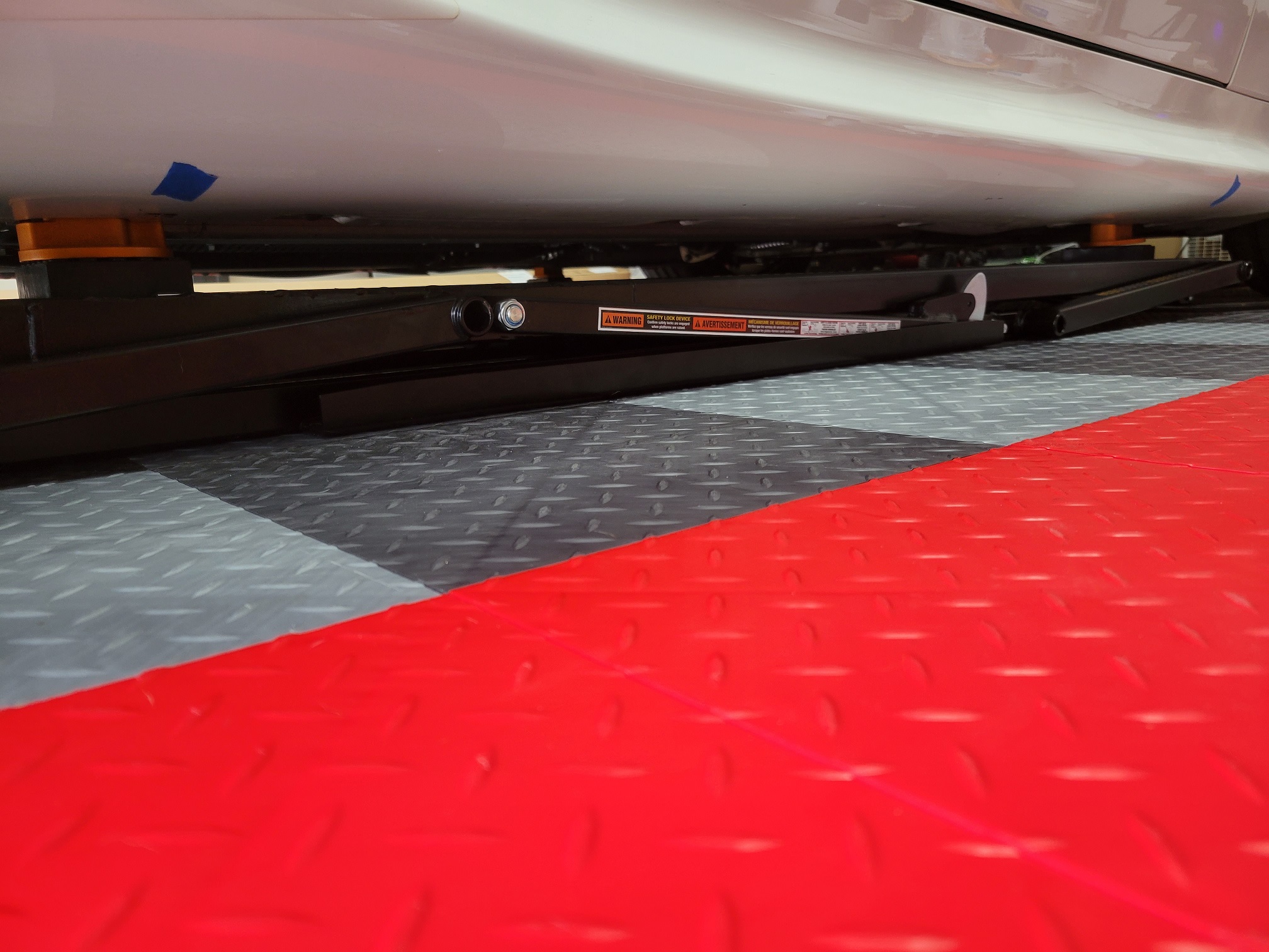

I bought a set of the jack pad adapters from Matt (hsm precision). They are a quality product for sure. Paired that with a set of quickjack TL5000.
