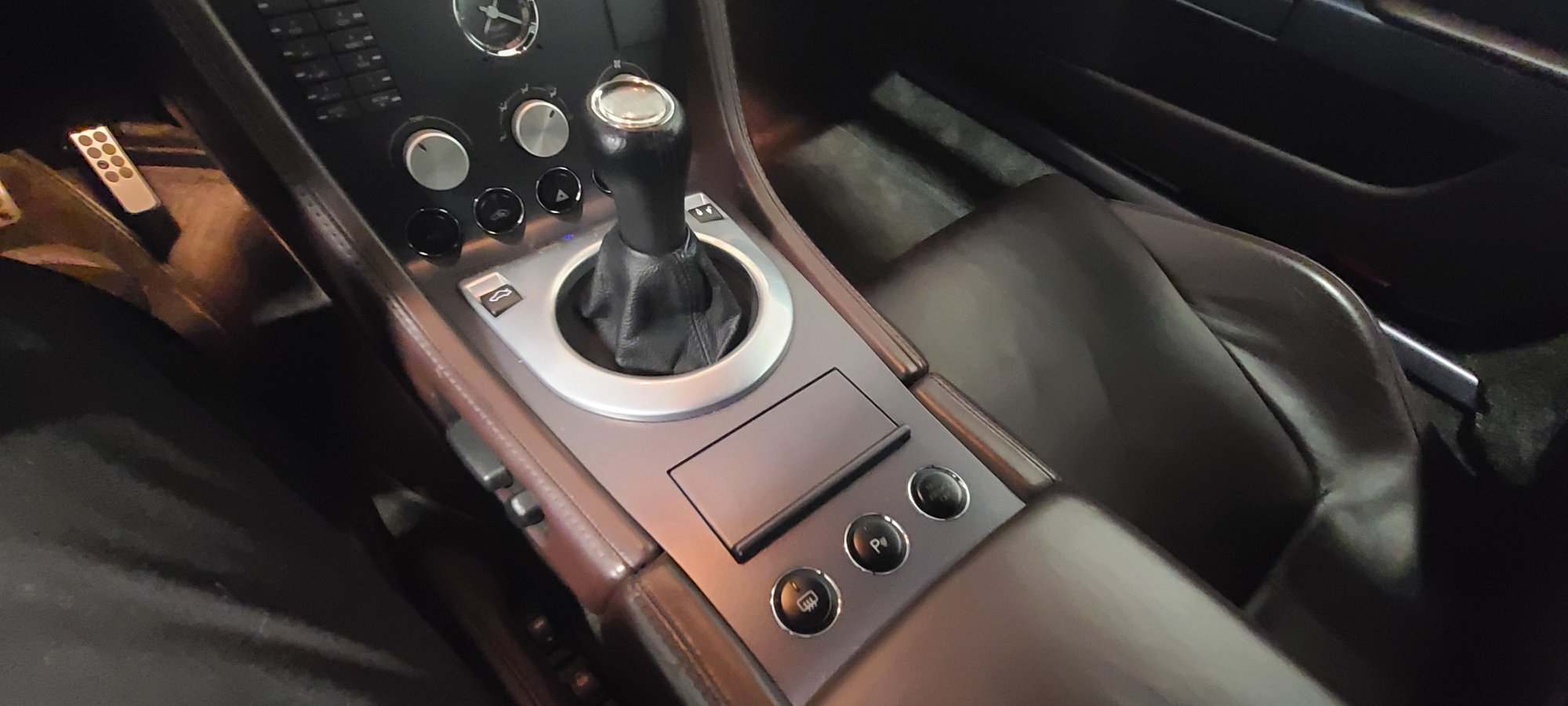

2006 Vantage
No Navigation, no iPod integration, standard stereo. It does have Bluetooth phone preparation so I can answer and make calls.
What is the part # I need to order to add Bluetooth streaming to a car with no nav or iPod preparation?
I assume there is a "proper" way using AM parts, and probably an aftermarket solution now as well. Random pic of interior enclosed.

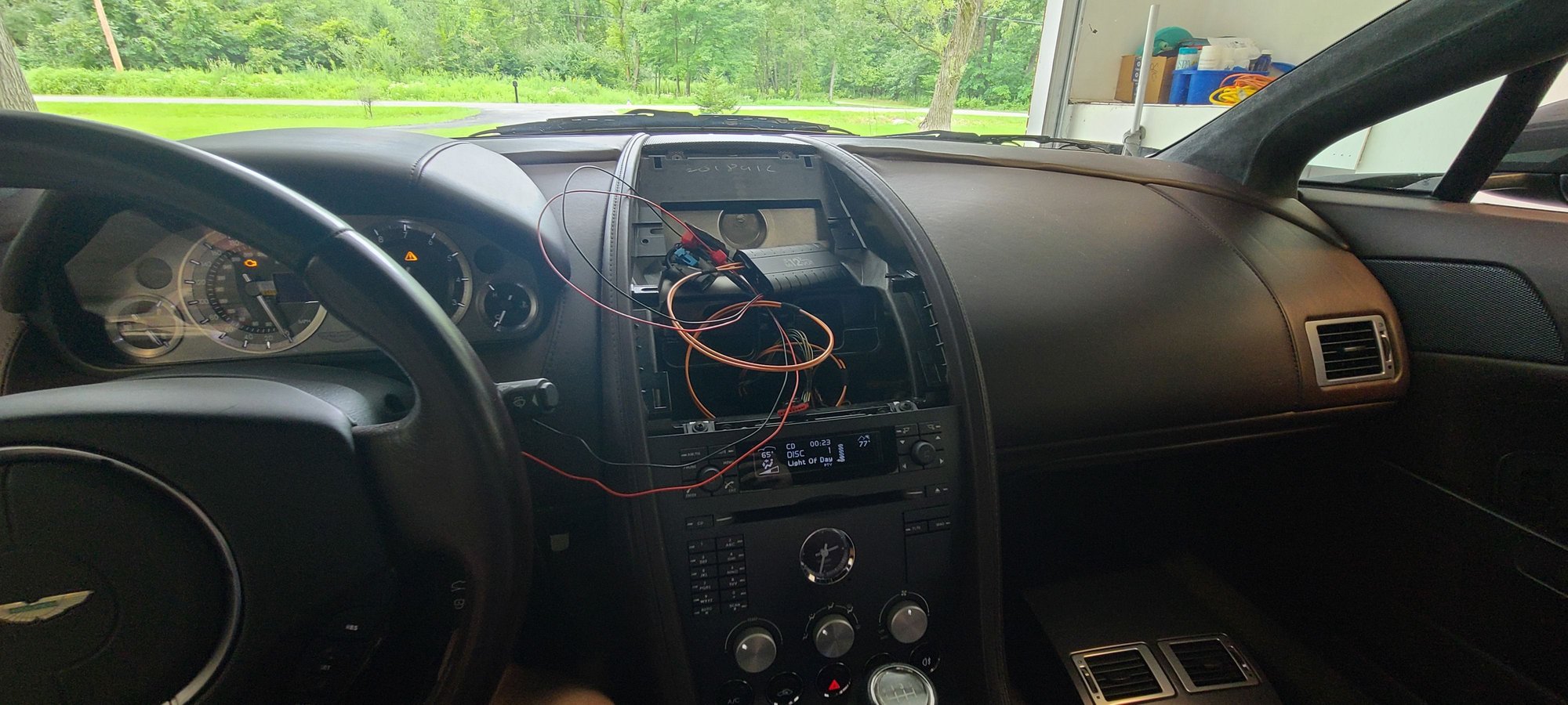

I got the P600 LP1606VOZ from Mr12volt and installed it today.
My car is No Nav so I had all kind of space and unused harness to tap in to.
First dip switch up rest down. I thought my unit was bad for a bit because even when tapping in to a constant 12v the red LED would light up for a split second and go out. The unit was still available to pair under "car kit" and once paired and in CD mode both red and blue LEDs came on and it all seems to be working.
For No Nav cars I tapped in to the orange/yellow and Black/Red for the unused screen harness for my power and double-sided taped and fabric taped it in to the cavity to reduce noise. I didn't take as many photos as I wanted because I the red LED not turning on threw me off.
