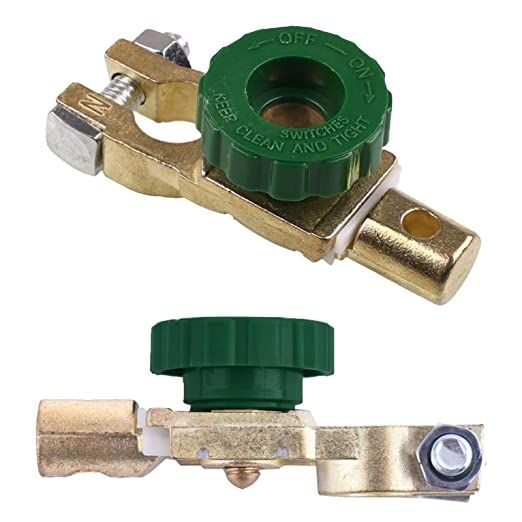

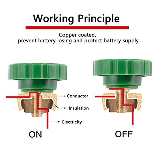

Mine is a MY2013 V8 Vantage. Due to my job, I have to be out of home every four weeks, so I have recently installed the most simply and cheap battery disconnector in the market. I bought it through Amazon:
At first, I was scared about any issues by disconnecting the car, but nothing wrong!! The only thing I have to reset is the windows automatic final elevation by holding the buttons by 5-10 seconds and it works again! Even the clock connects it and adjusts the time by itself according with the GPS signal in just few seconds... As far as I know, with the Sportshift II the clutch learning is not necessary, although I am doing every time, just in case.
When I disconnect the battery, I do it with both doors opened. Then, I close both of them with the emergency key. To restart the car, just the opposite steps.
