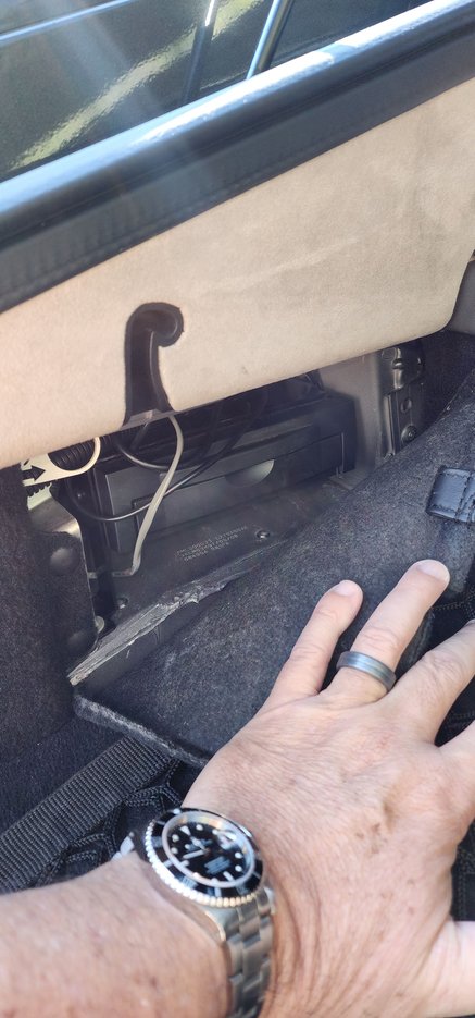

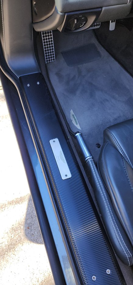

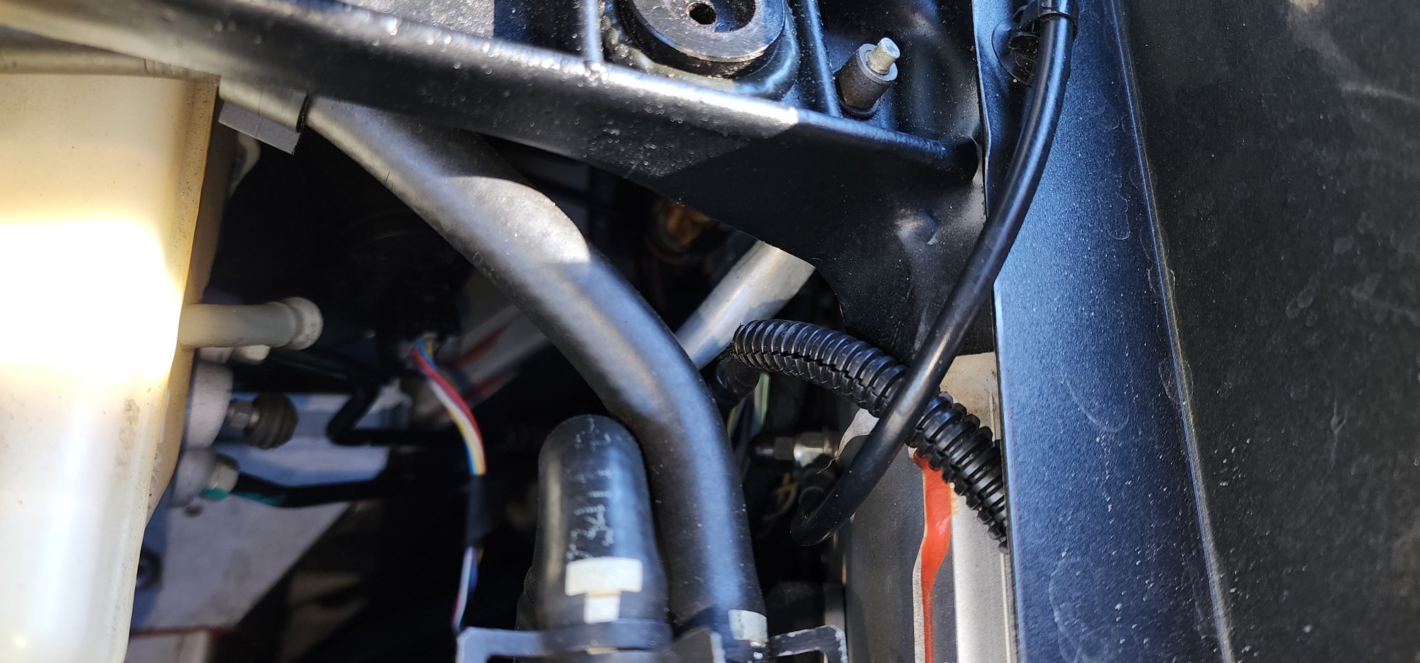

after that I added front camera with remote.i will see if I can work up something
I mounted a wired camera to the front bumper and fed it under the left wing. Fed thru a hole in the firewall on and under the door sill back to the cubby where the Nav system is. This is where I fed the rear camera feeds as well.
I was going to hardwire switches into the console but decided i really wanted a fully removable system so I opted for a remote switch. Its about $25 bucks on amazon. Once wired up, I can turn on the front or rear camera, the rear camera has prioriity based on the new rear view mirror system/ The rear camera comes on almost instantly when selecting Reverse ( wired to reverse light) I use front camera when parking.

Camera wire in look under wing to firewall
Rear cubby on left side
Wiringin nav area

Wire under doo sill to rear
