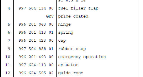

Sometimes the spring in the flap pops loose or breaks. Part #997 504 711 00. My spring came loose in early 2006 & I snapped it back into place. It's been good ever since.

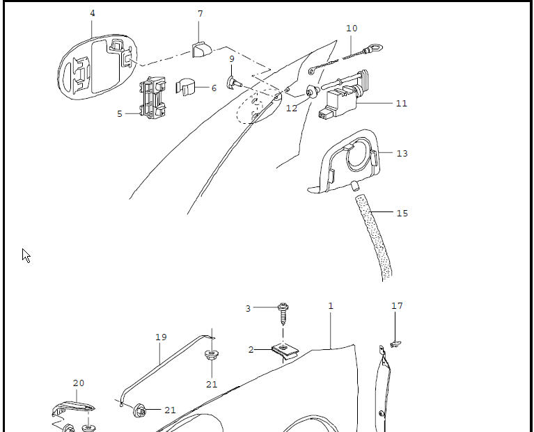

Diagram from the Porsche Parts web site: http://www.mcenter.su/porsche/E_997_KATALOG.pdf
The spring is #6

I had the same problem - but it was not the metal spring causing my issue. My problem was related to the plastic hinge that mounts the filler flap door to the body (part #5 in the above diagram). The metal spring rests on a very tiny ledge on the backside of that mount and it finally cracked and gave way. It was a $14 part at the dealer. They had them in stock as it is apparently a known issue with this part. The replacement they provided me appeared to be a little beefier in design. Took me about 4 minutes to install.
