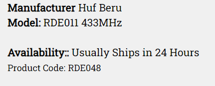

I don't have a definitive answer for you, but some quick research shows that both of these part numbers are used on a range of cars and both show as a suitable part for a '14 Vanquish. They seem to be completely interchangeable. https://www.tpmsdirect.com/Huf_Beru_RDE011_TPMS_Sensor_p/rde048.htm]This site even has both numbers listed for the same item, one as the model and one as the product code.
