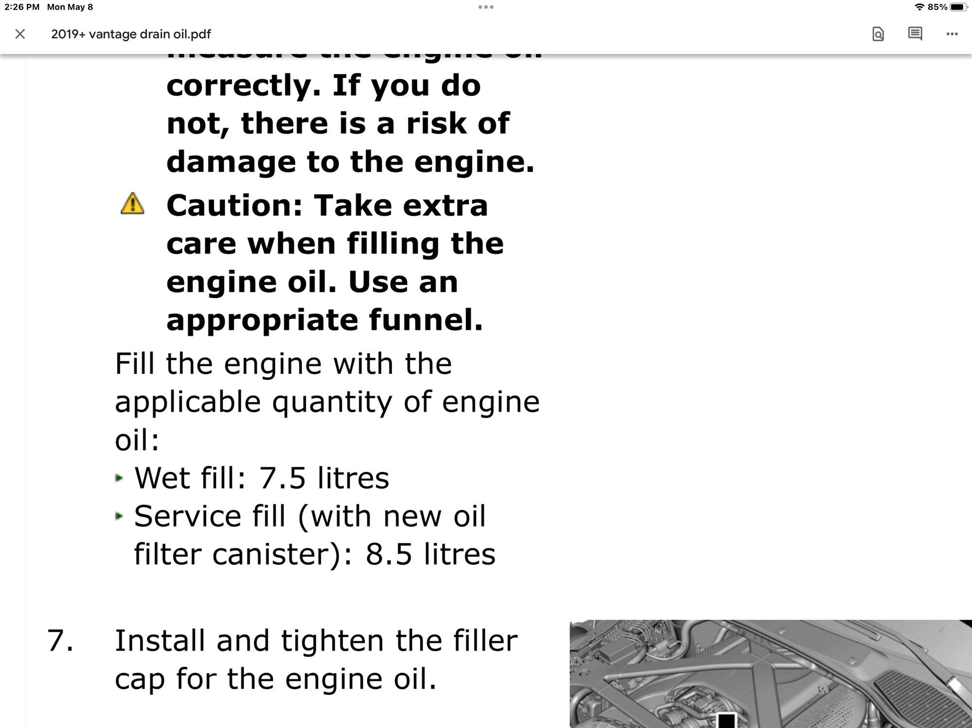

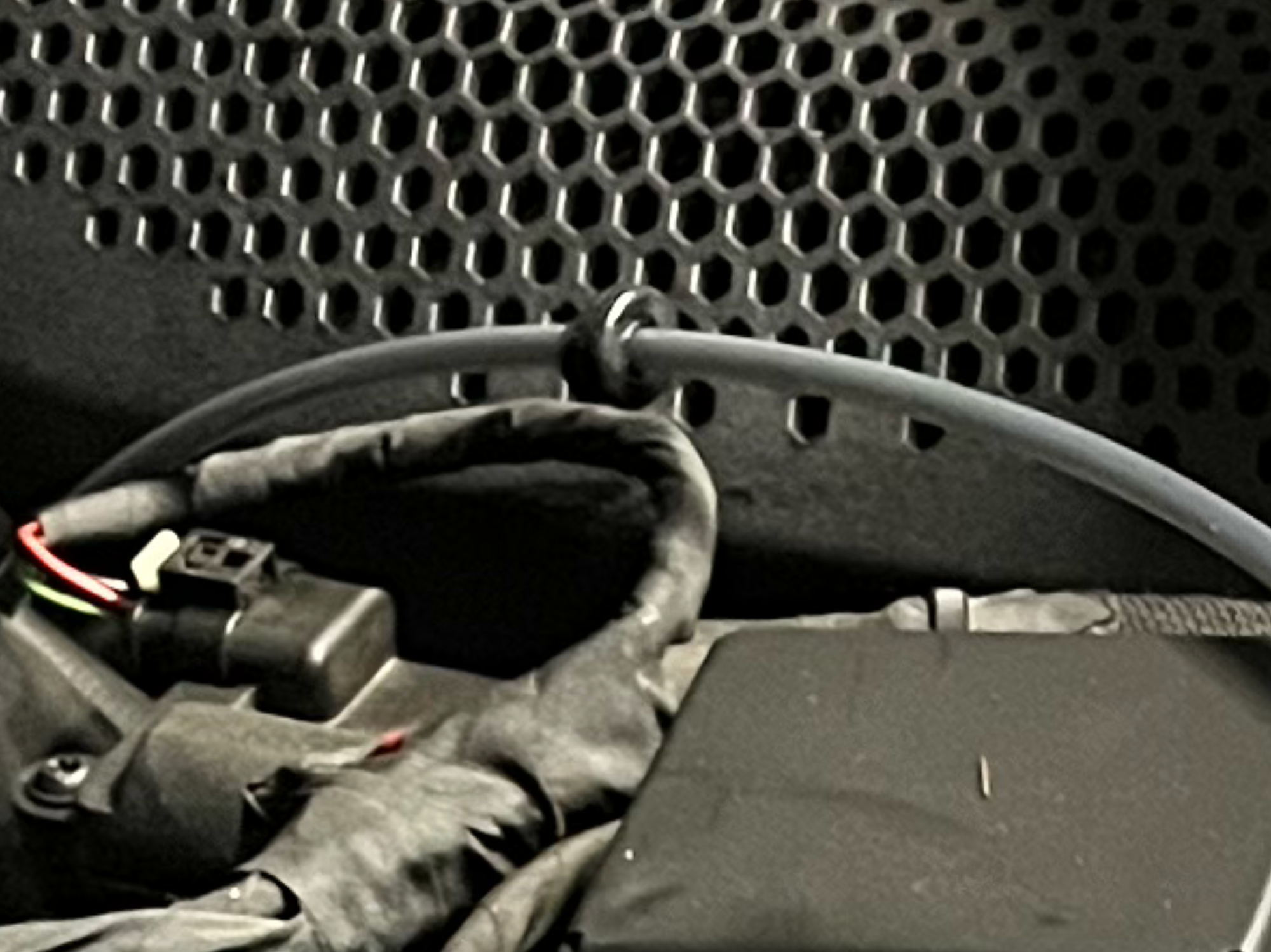

Originally Posted by I_gotta_Vantage
7 liters isnt bad for a pump extraction. 7.5 is the wet fill.. . I only have 11K miles...
There is a trick I used to extract as most oil as possible... I put a rubber grommet on the hose that goes into the dipstick pushing it over the dipstick hole once the tube hit bottom and created a vacuum inside the oil pan pulling all the oil out. You run the pump longer, but you will continue to extract oil...
the actual oil capacity of a 2020+ vantage is 8.9 quarts, which is exactly what I got out removing the drain plug. The above post about suction the oil out is leaving a substantial amount of dirty oil in the car. It’s super easy to do it the traditional way, and very nice to have a dipstick (back left of motor).
