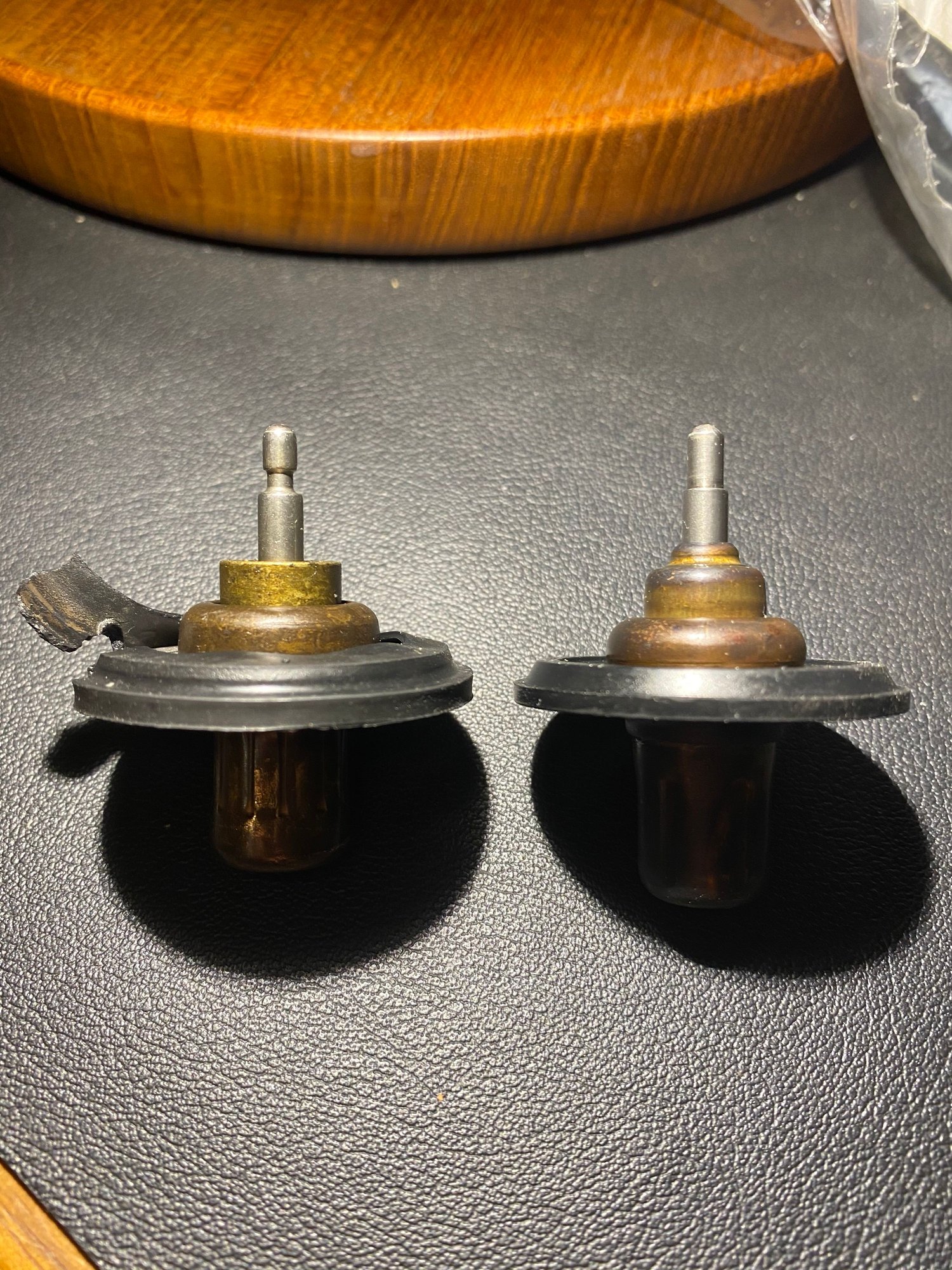

Car is a 2014 Vantage Roadster 4.7......has anyone come across/solved the following OEM equivalent thermostat problem?
Here is where I am at. Coolant drained with 3/8" interior diameter vinyl hose snugly fit over drain outlet, the handy kind discussed here ( https://www.6speedonline.com/forums/...t-removal.html ). Tubing easily fit after removing lower radiator core support AG33-8052-AA, drained + filled and repeated each yielding about 5.5 liters. Original thermostat removed showing a decent size tear but no loss of material into cooling system. Yes that stud is a royal PITA but I was able to get the bracket off w/o grinding it down, just an hour's worth of maneuvering & cussing.
The OEM thermostat at the local dealer is in fact the same flawed gasket design, and of course a shade under $200. The Jaguar equivalent is basically identical to OEM and uses the same flawed gasket design based upon comments on this board. I have bought the Ford/Motorcraft equivalent mentioned by many on here (Ford 2W9Z-8575-AB, Motorcraft RT-1163- 1X), and it does have the more robust gasket construction. But it does not seat properly into the thermostat pipe/housing/receptacle of my car. The photos show the damaged OEM and the Ford equivalent and you can see the "stem and shoulder" difference between the two. The Ford thermostat stem is either too thick or too long, resulting in a gap with the housing. I went to a different Ford dealer and the same part (bag and everything!) looked different from the Ford part pictured that I had bought but it was also too long. I have seen people post their own photos of this Ford part (again, exact part numbers) and what they have successfully fitted looks different than what I have been able to find firsthand.
Two questions. Is the Jag part indeed the same gasket design as OEM? And has anyone done a recent swap using the Ford OEM equivalent (on a 4.7)? I really want to avoid using the OEM and risk a bad outcome with gasket failure.

Thanks JB, my issue is that the Ford part you have pictured (as within all the thermostat threads I have scrupulously reviewed) is different from what I have found at Ford today. The Ford parts counter guys don’t have any knowledge of a recent design change, and given the age of the cars these were built for, I can’t understand why the currently available thermostat would differ. And they are still made in the UK. If the Jag part AJ811788 is exactly the same as the flawed OEM gasket, well, I’d prefer not to go down that path.

Yeah I had thought that the 1/8th” gap that I’m seeing with the new Ford part could go away with the Herculean tab compression. But the old unit easily fits back in snug w/o that next step of installation. More important, there is a definite metal on metal sound that accompanies any effort to close the gap on the Ford part, and I’m not prepared to screw up the interior fitting on the housing.
