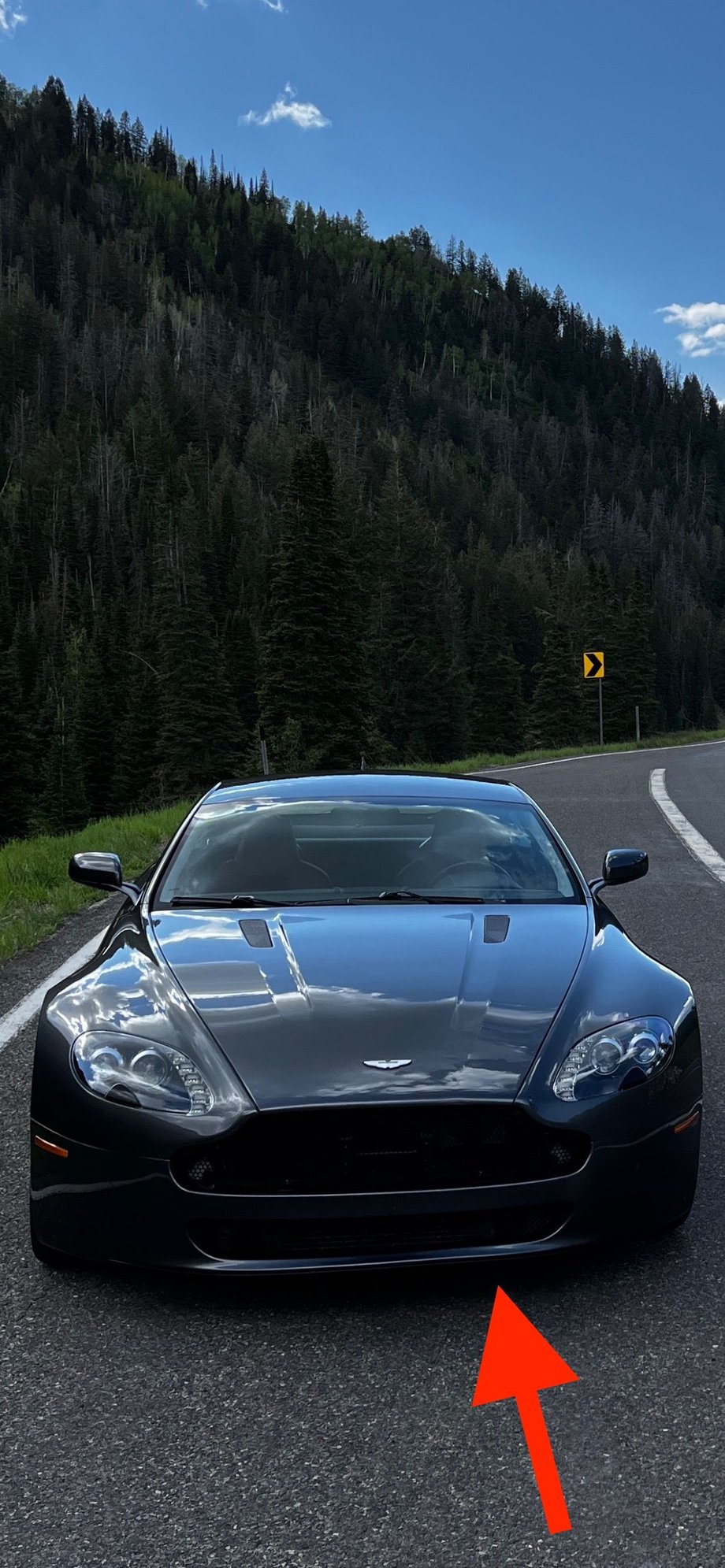

Hi all, apologies if this has been discussed before but I couldn't find anything specific to this topic when I searched. The front bumper on my V8V has a small deformation where the lower lip of the bumper below the lower grille has been pushed up a bit, I'd assume from the prior owner making contact with a curb. I've noticed this in pictures of other V8Vs here so thinking this may be a more common issue. Has anyone had any luck correcting this without replacing the bumper? If so, how was it done?
Thanks in advance.
Picture below shows what I'm talking about -

Need a better picture
Sorry know that isn't the best picture, the deformation is very slight in the one I posed. Hopefully this can at least give you an idea of what part of the bumper I am talking about. Talking about the lower lip of the bumper below the lower grille. Not the black plastic lip that is the separate piece but the actual lower part of the bumper itself. Can get a better picture once it's not raining and I can back out of the garage far enough to get the picture.

Originally Posted by usera
Many times it is due to the bottom plate being deformed from hitting curbs. I removed mine and flattened it with a mallet and it fixed the bumper.
Ah that is great to hear! Thank you! Sounds like this could potentially be an easier fix than I was expecting. Will give this a try.
