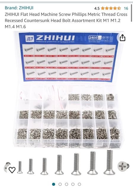

Old Feb 9, 2024 | 10:06 AM
95viper's Avatar
Joined: Jul 2023
Posts: 92
95viper is infamous around these parts
I bought this and one of the sizes worked.
