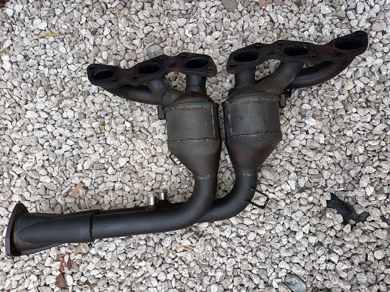

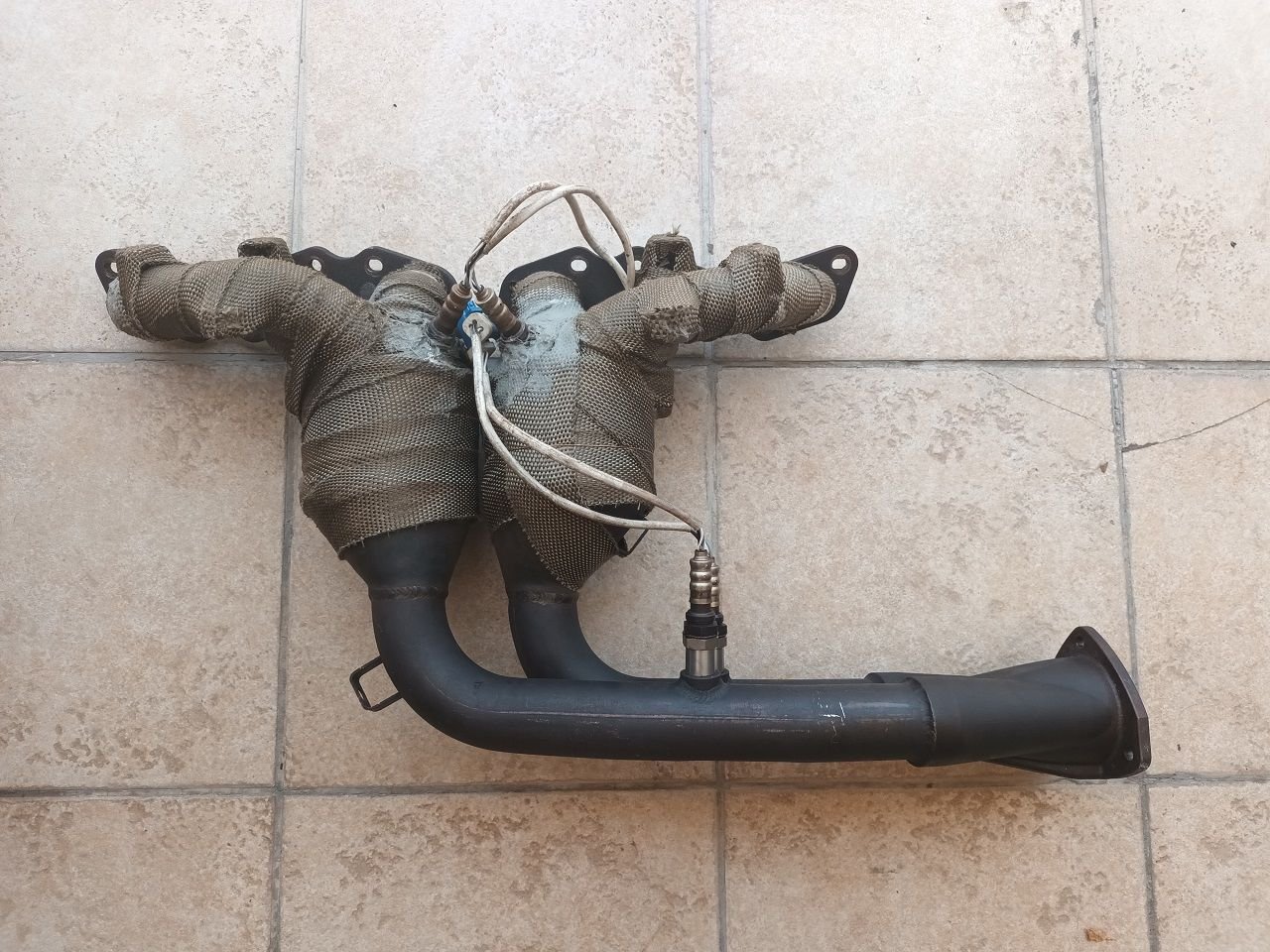

Hi all, with my RHD DB9 gradually racking up the miles since my 9+ year ownership (now just passed 66k miles) one thing I still had to do on my 'to-do' list was a 'header' upgrade.
I toyed with many ideas here, from buying a set of VAP headers to making my own which ended up me buying plenty of SST304 43mm diameter 90 degree bends, 3-1 collecters and 63mm bends and straight pipe, enough to fabricate my own equal lenght headers. I spend over EUR 300 in materials but never got to it....
My ride has been accross the globe (UK first 9 years --> 3 years SIngapore --> 5 years The Netherlands --> and Cyprus since last year) and therefore has seen many climates as well. Since I started to get misfires on some coils after I changed them out 4 years and 10k miles back (yes, a warmer climate doesn't prolongue coil life is my experience) I thought it was a great oppertunity not to just replace these but also change my two (2) engine mounts and upgrade my headers too.
I have been running VAP's secondary CAT delete pipes for 8 years now and since MOT regulation here on Cyprus is not strict at all, I decided to remove my Primary Cats as well. We all know the potential damage they can cause to bores in particular icw misfiring coils...

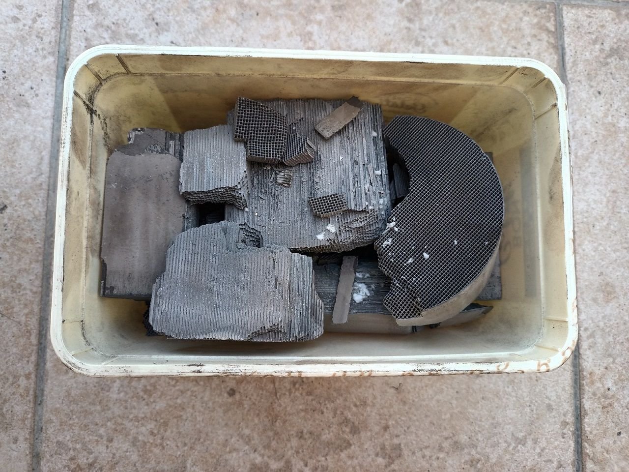

Upon inspection they still looked good but it was time for me to take them out. I cut back open the rears of the Cats, took all material out (1.5KG / 3.3 Lbs in total for all four cats) rewelded the steel back in and wrapped the headers to reduce underbonnet heat. To avoid emission warnings I installed O2 sensor extenders in the downstream sensors. All went back on the car and: e voila: no issues nor emission warnings ans also no potential harming to the engine. Best of all: I found a Catalyst recycling company that paid me EUR 400 for the 1.5KG / 3.3 Lbs loose CAT material I send them!
A great update after all. Sure, you are not having the upside from equil length-headers icw a tune nor does the sound change significantly but it does save a lot in the finance department :-)
P.S.: don't mind the exhaust paste: on the first header I forgot to put the lambda's in prior wrapping it so I had to cut the holes for the O2's sensors; to prevent the fibre from loosening further I smeared them with exhaust paste.
great info here what was the procedure of removing these headers, did they come out with the engine in situ?
Any header bolts shear at all ?

Originally Posted by AstonMan1664
great info here what was the procedure of removing these headers, did they come out with the engine in situ? Any header bolts shear at all ? vb gaz
Prior taking the header bolts out I soaked them with WD-40. They all came out no issues. I dropped the subframe (while supporting the engine) to remove the headers and did so with the car on four axle-stands at about 1.5 ft height... That was enough to clear the headers from underneath the car.
New exhaust Gaskets (4 pcs from brand REINZ, item no. 71-34307-00) and bolts later and all is in fine working order!
