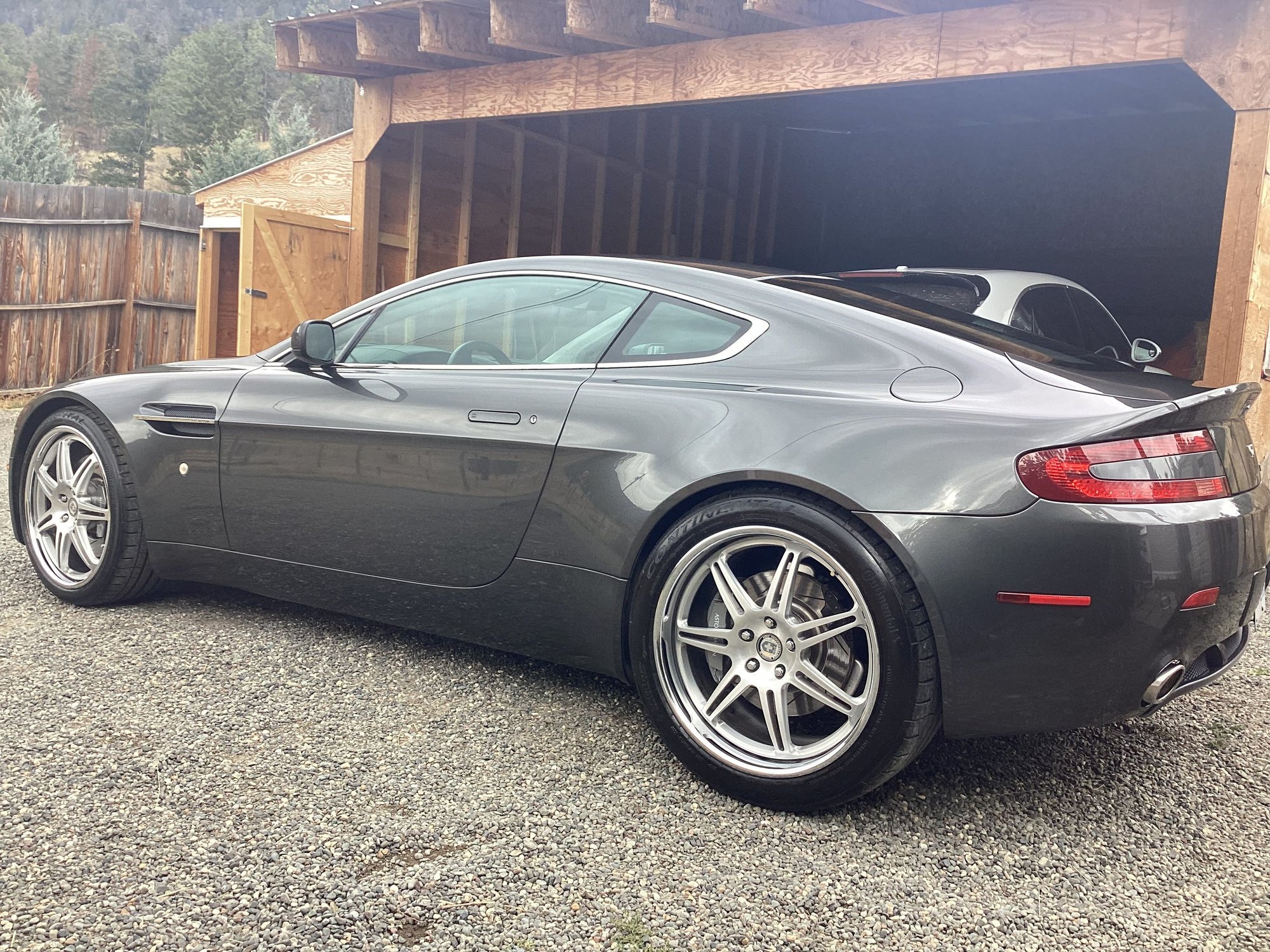

I am running 20” HRE rims on my vantage with 265/35/20 up front and 315/35/20 in the rear..had 30s up front before and 25s on the rear..I am loving the improved ride with the extra sidewall…no noticeable difference in performance…but the rim is better protected from our poor roads..
