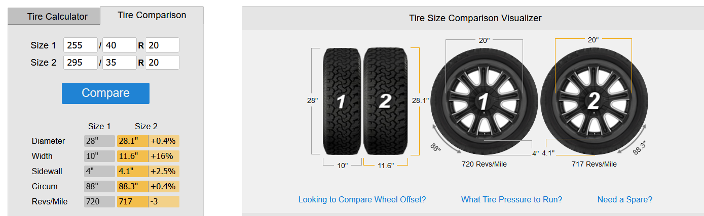

It's not that they be exactly the same circumferences, front to back; but for me and how I know traction control systems and ABS work, both systems compare wheel rotations at each corner then act accordingly. So, on any modern performance car I've had, I first understand what the factory engineers calculated into the system. Then, if I am going to change wheel sizes, and/or diameters, I strive to stay within the factory spec, or better.
So, for example, I changed tire sizes, both front and back, but kept the 20" wheels. First I used a tire comparison tool to gauge where the factory tires are:
Notice, there is only a 0.4% difference in the rolling circumferences, front to back...nearly perfect.

The conclusion, for me - I would not choose non factory tire sizes, and/or wheel diameters that varied much from the factory specs. An example from the past, on a car with a factory variation of 5%. owners were changing wheel sizes creating an 8% (or more) difference. This caused ABS to engage when making only moderate braking in corners. Traction control might have also been impacted under out of control conditions, but no one reported it. Another example in the AMG GTR world, someone had a blowout on a rear tire, pretty worn out. He had that tire only, replaced with new. There was a 1/4" difference in the tire diameters which caused the car to produce a C-code failure at the rear electronic differential and reduced limp speed. Caused solely by 1/4" difference left to right side.
One last point - Because I changed wheel diameters (and rolling circumferences) by a slight increase (88.3" to 90") I will have a very slight inaccuracy in speedometer readings - not enough to save me if radar is catching and ticketing only one or two miles over the limit. I won't show that chart, but at 90 mph I am actually doing 91.7.
