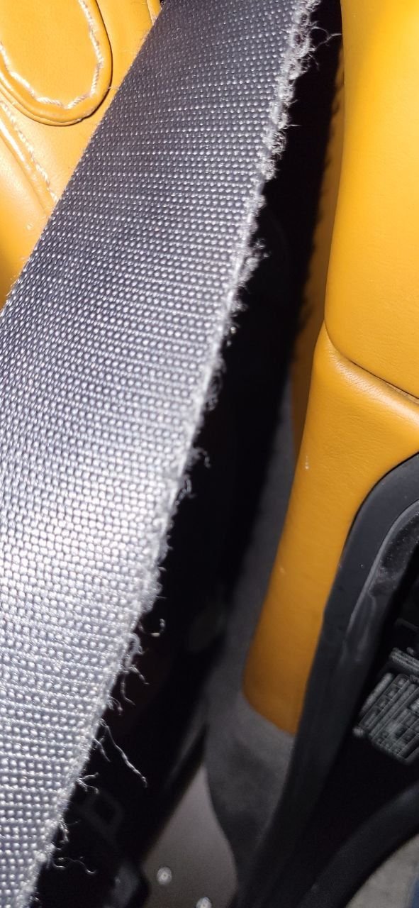

Hi guys, how are you? Has anyone found a useful answer? What is the problem? Why do the seat belts show chafing and fraying around the edges? This happens in all the early years of the Vantage at least?
Has anyone found a solution...???
The solution is to remove the seat belt and change the fabric harness, only the fabric, for another one and check the areas where they serve as a guide.
The original replacement is very expensive. I am seeing that it seems that
there is a much cheaper replacement for Stellantis Group, ALFA ROMEO GT.... 147....156
