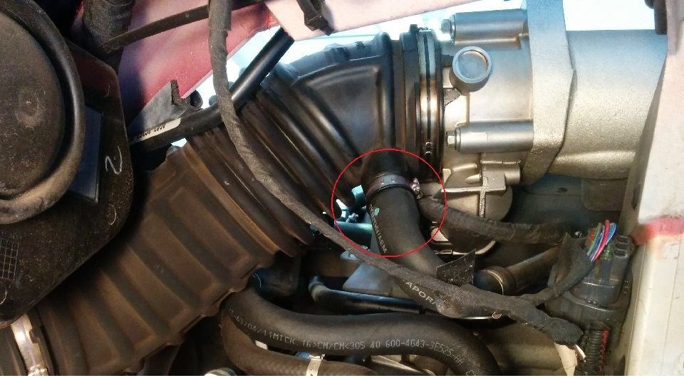

Got it! The intake hose slipped off causing a leak (not visible from the top). Now all goes fine.
