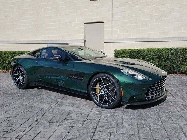

Just got the car back from Aston Martin Orlando. They reset the codes and everything is good now. I guess that it was the coolant temperature sensor, but I didn’t reset the codes. All is good now. They have a beautiful new Vanquish finished in green with a tan interior. $551,000. Very nice but I’ll keep my red one. The also have a special Aston that was 2.7 million, that’s just crazy and finished in a flat black.
