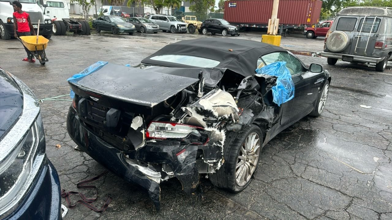

Ok I have been trying to get my submarine/kick in the butt to start to no avail.
It cranks, shudders but never start. The key is accepted and the alarm red light stops blinking once the crystal key is inserted. It is not fuel pump related and I now wonder it It has anything to do with the accident "kick in the butt" was involved into.
No airbag deployment, the crash fuse is intact.
So here is my question: The PATS could have something to do with this but I don't think so. Can one of the messages the car displays be stopping the engine from starting, like a service message stating that the car must be brought to the dealership?
Could I address one of those messages, or addressing all of them with a bi-directional code reader, erase them and solve the starting/non-starting issue?
What's yall's 2 cents on this?

An accident was mentioned. Whats the details? Front Impact, rear impact, was the car parked or in motion ? It might help the forum participants help you. Hopefully it's not too complex of an issue to sort out.

The impact was in the rear and it was massive. It looks like the car was in motion but no airbag deployed.

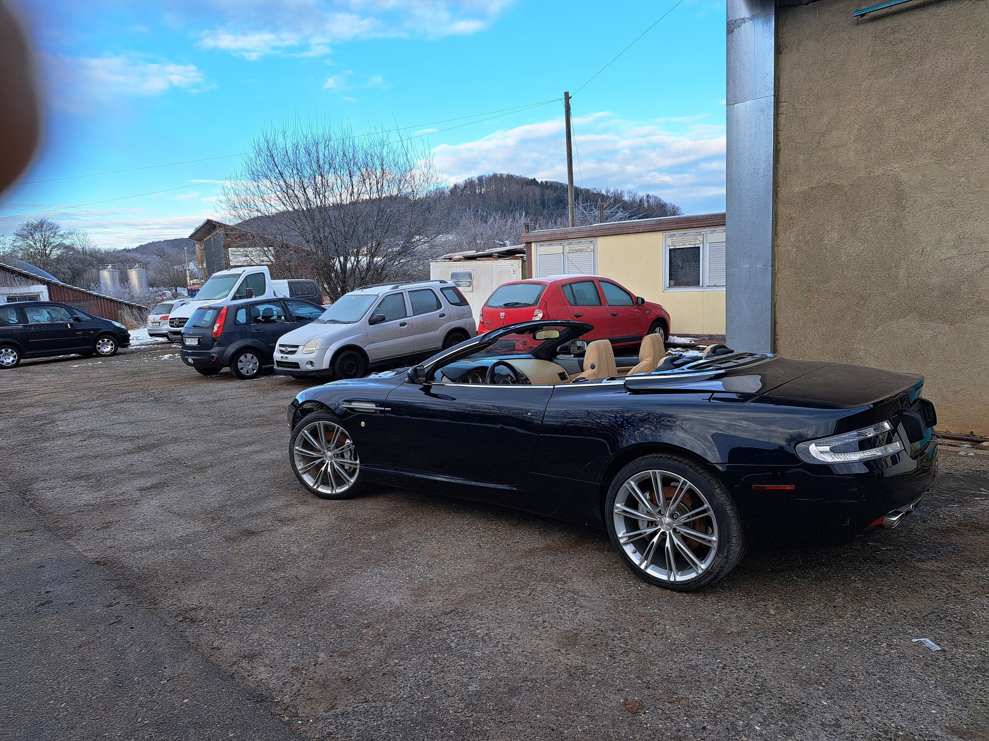

Thanks for this reply. Very In depth analysis. I must clarify one thing, the car you see on the pictures is now a donner car for a flooded car. So I took all the electronics from the smashed car to rebuild the flooded car.
In effect, the electronics from the smashed car are now in the flooded car so all related mechanical elements that are now attached to the electronics on the smashed car have not been involved in the impact.
If the issue is a shutdown from the smashed car electronically speaking, how do I reset that? With a switch or by resetting something using an OBD2 bi-directional tool? And if do, what kind of code am I looking for?

I have transferred all computers from kick in the butt to submarine but now that you mention it, the cluster presently in the car is the original. I did "re-use" that element because it shows millage of 16 000 where the damaged car's cluster shows 29 790 miles...
That's in contravention of your 3 units from the same car rule. I must try that first.
