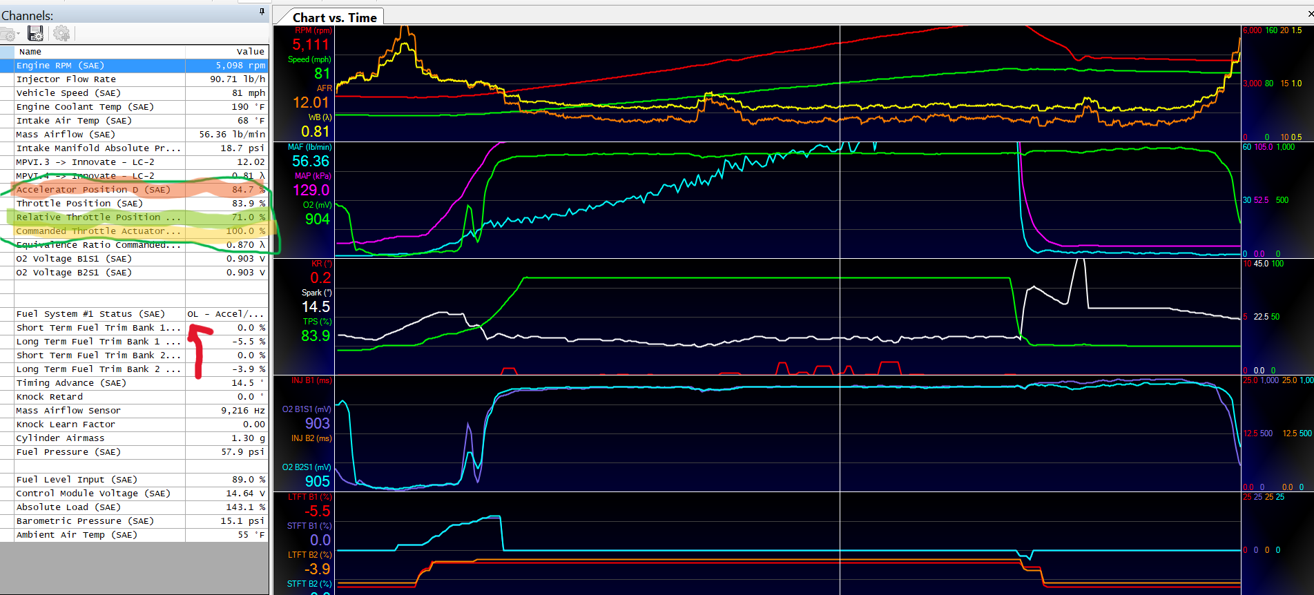

Every high performance car I've owned or worked on with electronic throttle (drive by wire), regardless of manufacture, has these "moments" of flat acceleration and it's inherent in the factory tunes. I've tuned for a dozen years and saw it there. I've also corrected some of it out in torque management within the tune, then there is an outside product solution, past the tune, that some believe in (but not so much me).
First the tune part:
With electronic throttles, there are actually 3 positions at any given time, only one of which is controlled by the driver. I won't get into the gory details, but the 3 positions are:
Commanded throttle
Relative throttle
Actual throttle
These 3 are almost never the same at some given moments of acceleration. Here is an example from an actual tune I did and subsequent datalog:
Ignore the red arrow (used in another thread on another forum). Notice, that even though, at this moment, I was commanding 100% throttle, actual throttle was only 84% and relative (what the engine sees) was 71%. These differences get more dramatic under different conditions and cause the flat spot feeling described here.
There are products out there that change these 3 positions outside the tune without actual tune intervention. They are quite popular in the Domestic US marketplace, but one would need to inquire if these companies have anything that would work on the AM platforms. One such company is Soler Performance, Inc. I'm not a fan and have never installed one, especially on a tune I've done BC it creates some ridiculous throttle situations. But the ones used on stock tunes, users brag about the differences.
I can't post a link to Soler, but it googles easily.
Hope this give some additional insight.
