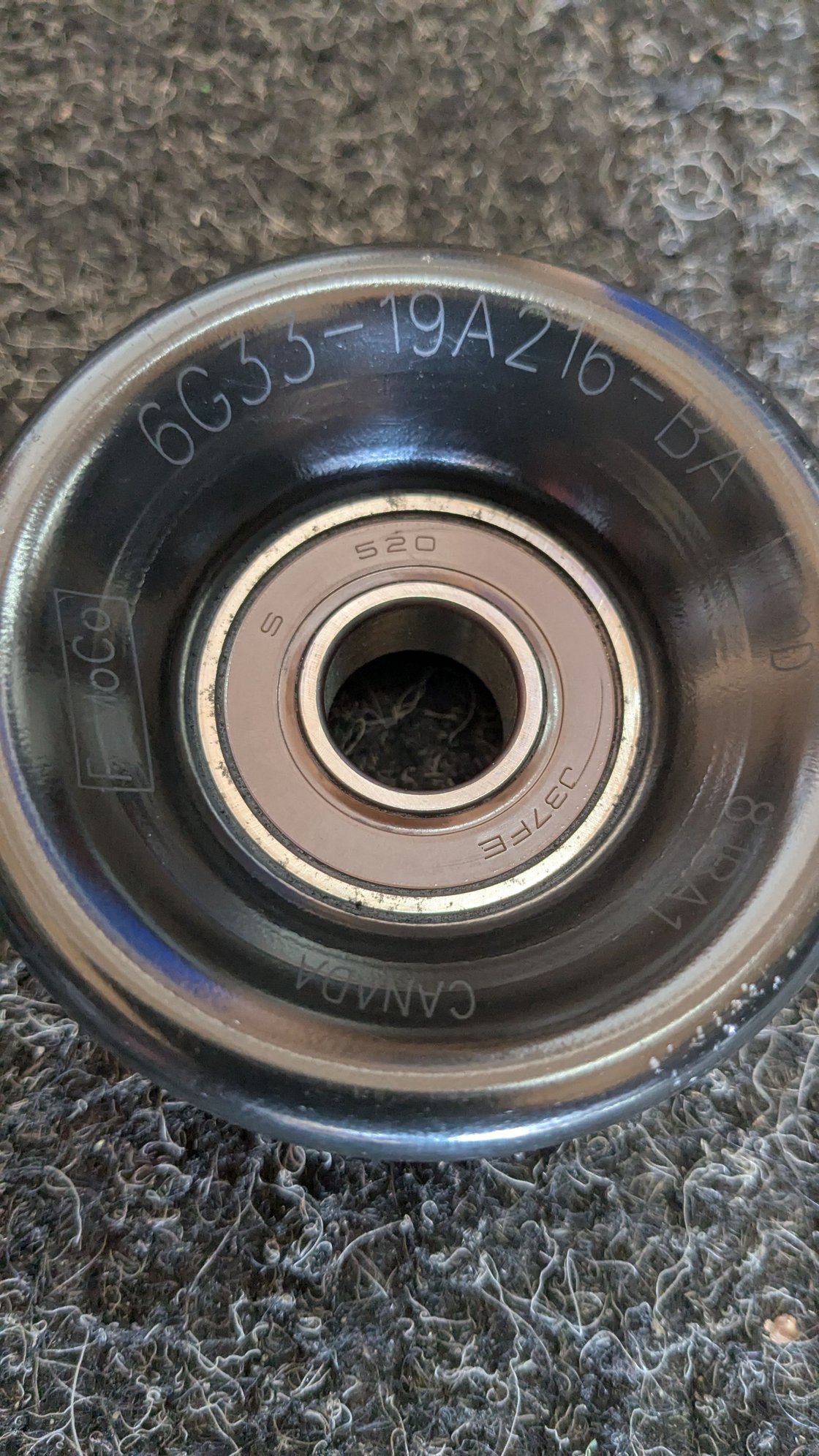

Well my issue was the 6G3319A216BA Idler bearing, after removing the pulley and inspecting the bearing you could tell it wasn't very happy and grease started to come out of it. I found out that the original bearing was mark J37FE, and in a Ford F150 forums mentioned that a J37FE was NTN 6203
Bearing measurements are:
O.D - 40 mm
I.D - 17 mm
Width - 12 mm
I check locally and found some in stock for $5.99 cdn, pressed out the old one, press in the new one and reassemble everything. Now it is whisper quiet, well at least the pulley that is... lol
Here are a few pictures I took while I had both Idler out but at this time only the one needed a new bearing. Hope this help someone in the future
New Bearing 6203RS (62032RS)
Original bearing J37FE
9G3319A216AA
9G3319A216AA
9G3319A216AA with Original bearing
