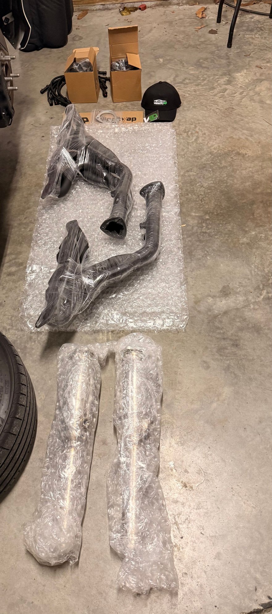

Right now I have what you see below that was provided with the kit. The car only has 27k miles and was not throwing any crazy misfires, so I’m thinking the O2 are probably ok to reuse. Plus, after this install, they will all be fairly accessible from directly beneath the car. I’m planning on ordering new header nuts and new wire covers (I hear these break very easily). Is there anything else you guys feel like I should order preemptively?
Any other tips or tricks you figured out while removing/installing manifold/headers?

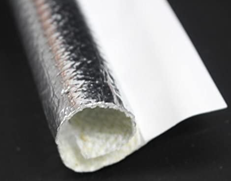

After having mine done nearly two years ago, I'll recommend that you not use the plastic wire covers that velocity provides. The heat from the headers is enough to liquify whatever plastic they're made of. I ended up disassembling all of the o2 sensors a few months later and they were all melted together and dripping down onto the headers even where they were inside the plastic boxes under the intake manifold. Replaced the wire sleeves with a reflective adhesive style that I found on Amazon and haven't had any issues yet.
