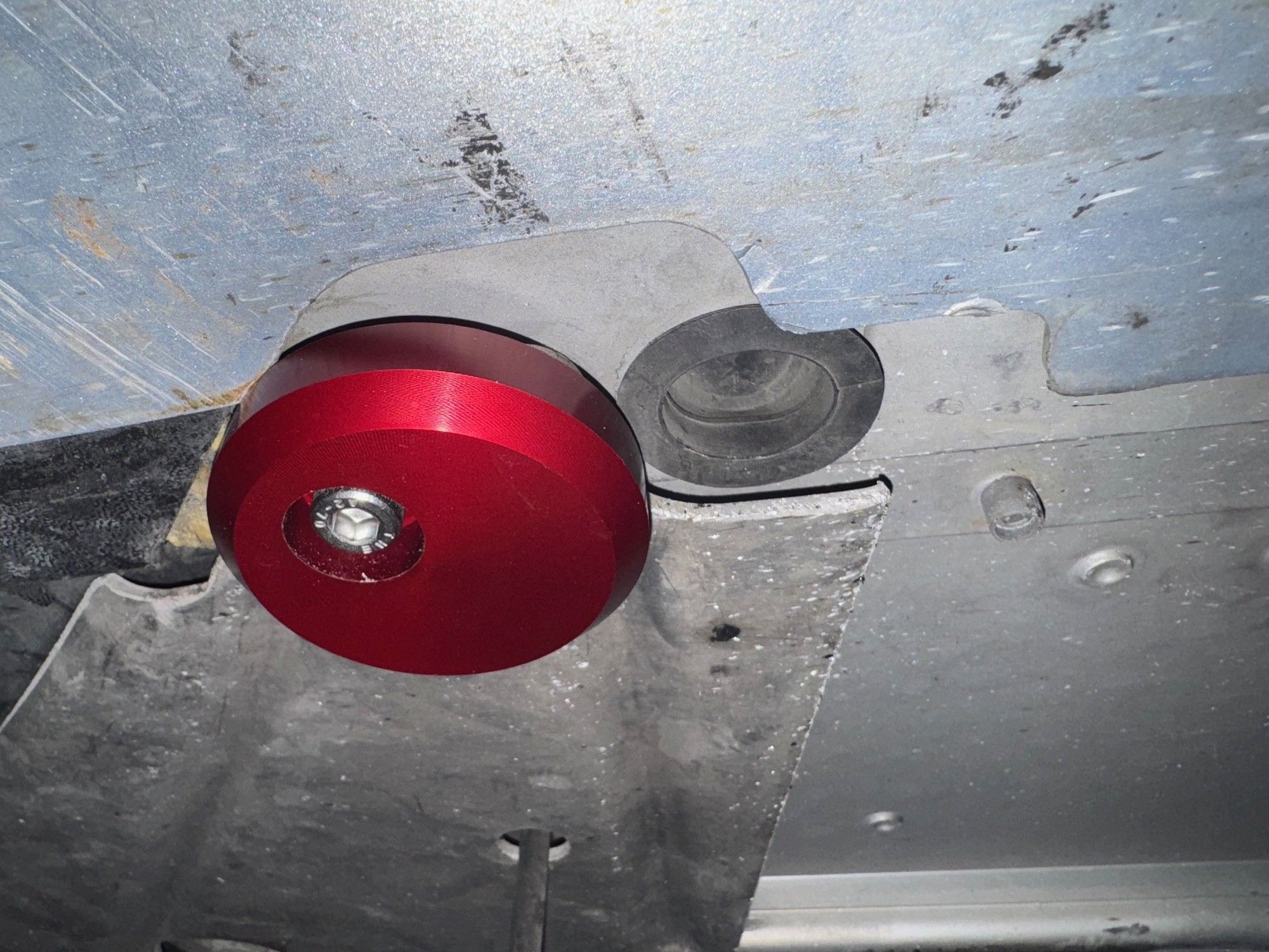

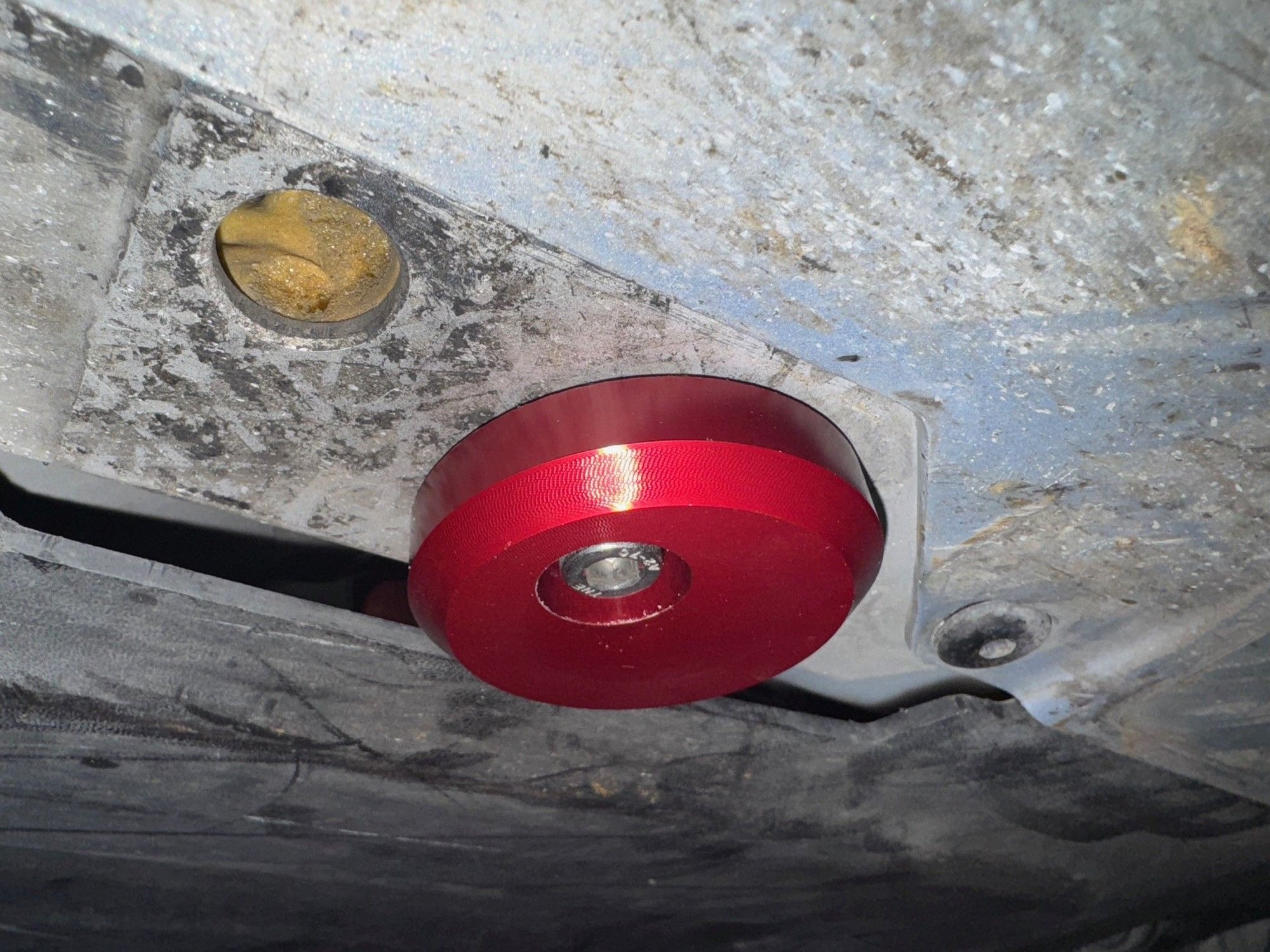

Got the ZL1 Pads to fit
There were no instructions, but I facetimed them and they stepped me through. I must have been the first Aston installation because the bolts they sent for the rear were not long enough. I was able to find longer bolts, so now they know to ship longer for the rear. The fronts just screwed into an existing hole not yet used, and the rears I removed a bolt and screwed the new one in. Super simple. Top picture was the front - bottom was the rear.

Thanks, I’ll take another look to see if I can find the front hole, the rear makes more sense now. I think these are the best solution. Do you see them from the side, or do you need to bend down?
