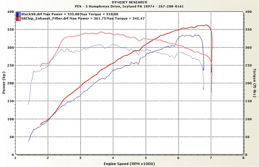

We just completed a tune for one of our dealers. The tune included a custom cat back exhaust, filters, and of course PES ECU tuning. The difference is amazing. We gained 38hp peak but 57hp in other places. Also gained 60ft/lbs at 3000RPM. The car sounds like a Gallardo! The dyno speaks for itself. The numbers are "to all 4 wheels" with an automatic trans. Multiply by 1.35 to get the "crank" numbers.

The HP and TQ curves are some of the smoothest I have ever seen. It is amazing how bumpy and erratic the factory software HP/TQ curves are. We all can see your talent with the quality of this software program.

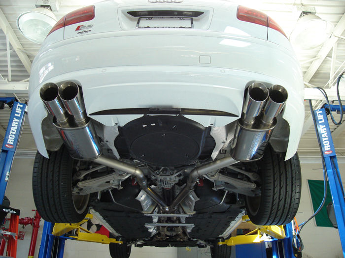

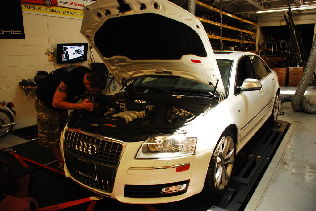

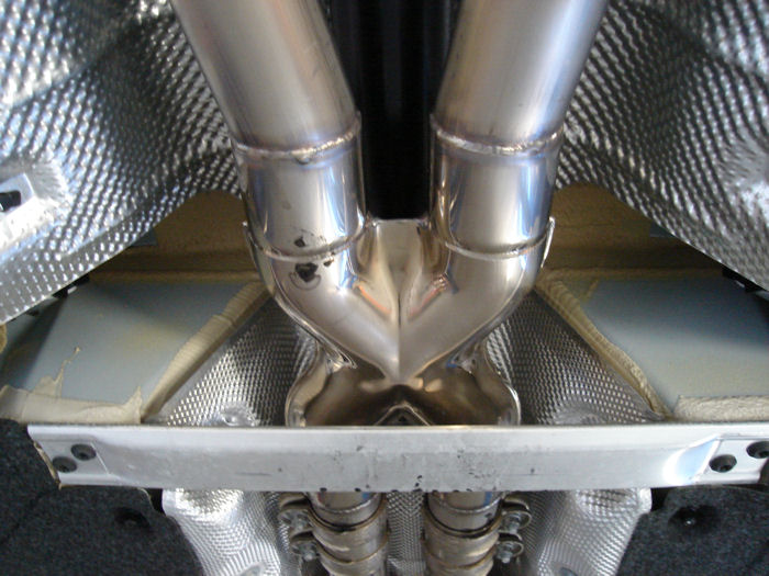

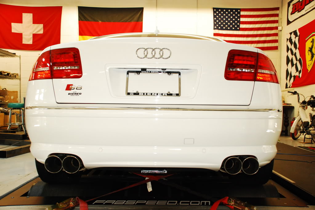

Here are a couple more pics of the exhaust and the car on the dyno.

wow that car sounds amazing and the gains are very respectable.. did you delete the secondary cats?

System is 100% cat back. No cats removed. Did you ever see how the downpipes/cats look under the car? Its a wild setup.

Exhaust looks and sounds sick, and nice gains. I'm happy to see someone give an awesome car some tuning love, just because it's an S8 doesn't mean it doesn't need mods.
