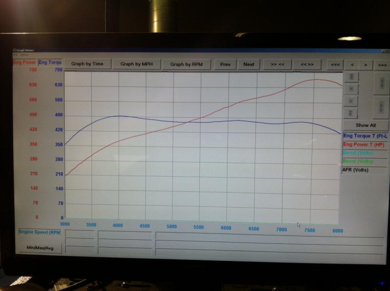

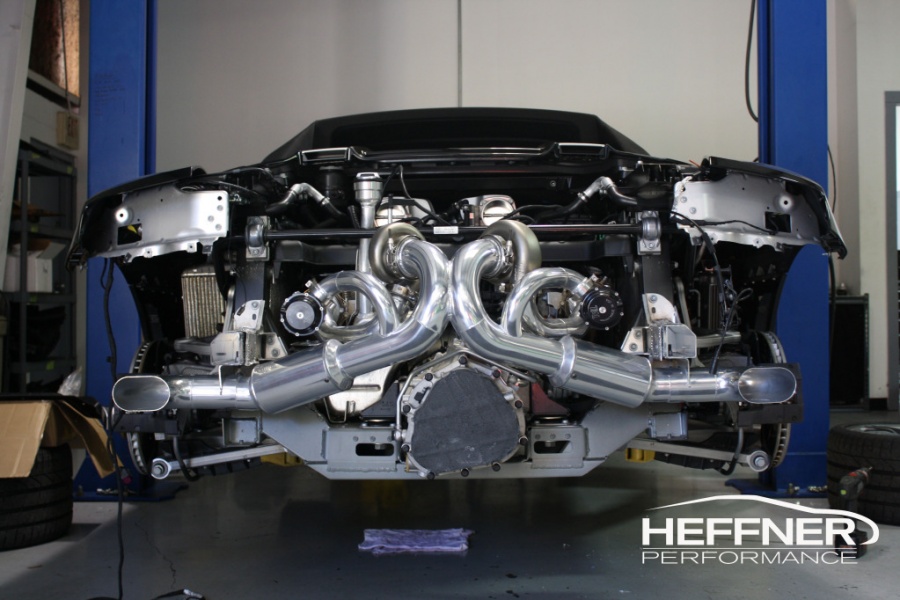

Heffners R8 5.2 dyno
Twin Turbo
AWD DRIVE numbers

Nice numbers. Tuned by who - EPL?
yes heffner couldn't crack codes so after shipping computer back and forth 3 times he just sent them the car. it took them 1 month to complete.

Originally Posted by Fancy Pants
Under 700 whp? Is this on stock internals?
yes stock internals. stock everything including bosch.
heffner has done 4 other 5.2's this way.He did 2 gallardos
of mine previously which I drove 50,000 miles problem-free.

Unless I'm mistaken, the all wheel drive R8 has about 20% drive train loss, so the roughly 665 the chart is showing at the wheels would translate to around 830hp at the crank. Is that consistent with other's understanding? I think when people are posting the big numbers for the TT conversion they are at the crank. I am curious though about experience on drive train loss, since I want to dyno my V10 which has the APR remap plus GMG exhaust. If both "claimed" gains are additive, that should put me close to 600hp at the crank and ?? at the wheels until dyno'd.
an APR tuned 5.2 R8 with exhaust might pick up 20-30 crank horsepower unless it's full decatted etc. Even then, I don't thin it'd be much different.
So more like R8 GT type peak hp (550-560) rather than 600.
this graph was done at EPL awd numbers the other dyno I just posted was rwhp done today at heffners.
